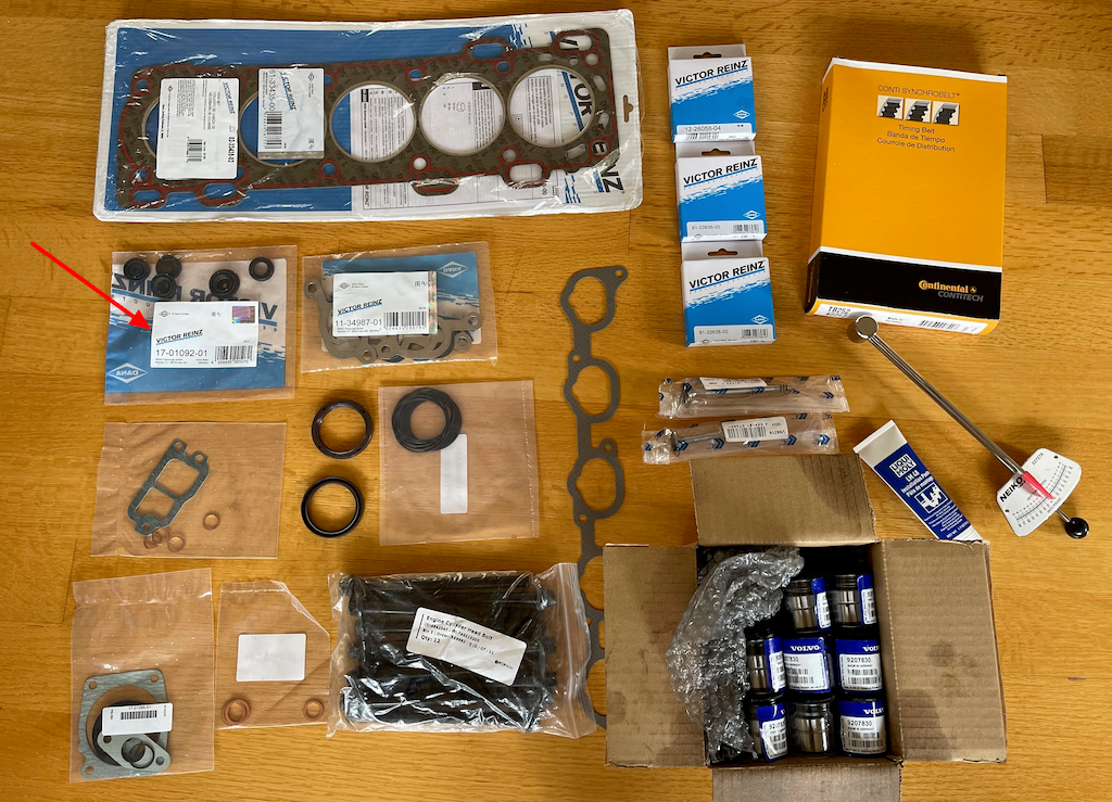

So as the parts roll in for my repair, I thought I would catalog them and also ask a few people what some of the seals are for! There's one package (red arrow) that I can't figure out. I looked for the catalog number of the Victor Rienz site, but I just can't locate it. There are 5 sets of each, which leads me to believe it's injector or ignition related, but it matches nothing on my car.
You can see the new Volvo hydraulic lifters in the lower right in the picture above. They came individually packaged in a nice cylindrical container with oil in them. However, some of the lids came off in shipment and I have a very oily box. Also you can see the 2 new exhaust valves I bought, even though I only have 1 burnt valve. Not sure if I should replace them in pairs or if it matters at all.
During all this, II noticed a tiny bit of play in my water pump. Well, I figured that I've gone this far, I may has well replace that too. Off to order more stuff online. That meant the belts had to come off, etc., etc.
What do you guys use to get the old gasket off? The green ones for the water pump and related parts were really difficult. I even carefully used a razor at times because no plastic thing was doing anything useful.

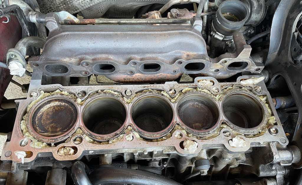

No compression on 1 - burnt valve? Topic is solved
head rebuild Job on A VOLVO 5-CYLINDER

Yea, it'll be great to get it going again. It was satisfying to know that my prognosis was correct. Also, getting the head off wasn't as bad as I was expecting. The main annoyance is when you discover other stuff that needs replacing. Scope creep!volvolugnut wrote: 30 May 2023, 07:32 Well done! It is very satisfying to remove the head and clearly identify the problem. Think of the satisfaction you will feel when you restart the engine you repaired.

I am not sure what the cause was. Most seem to attribute it to a valve seal issue or a lean condition. My issue was on 1, which isn't the cylinder that had the problem with the intake screw being loose. That screw was between 4 & 5.BlackBart wrote: 30 May 2023, 09:02 That’s a lot of work. I did the exact thing in my trunk with parts in order!
What caused this? Too lean?
Is this a significant comment here?songzunhuang wrote: 29 May 2023, 23:40 Then there's a stripped screw hole in one of the intake valve holes.
I'm not really sure how to conclusively tell about the valve seal. I guess the top of the piston was a bit oily, but that must have been something to do with disassembly as any oil must get burned off in the temperatures during normal running. Maybe the machine shop guy can give some observations when he disassembles for cleaning. We shall see.

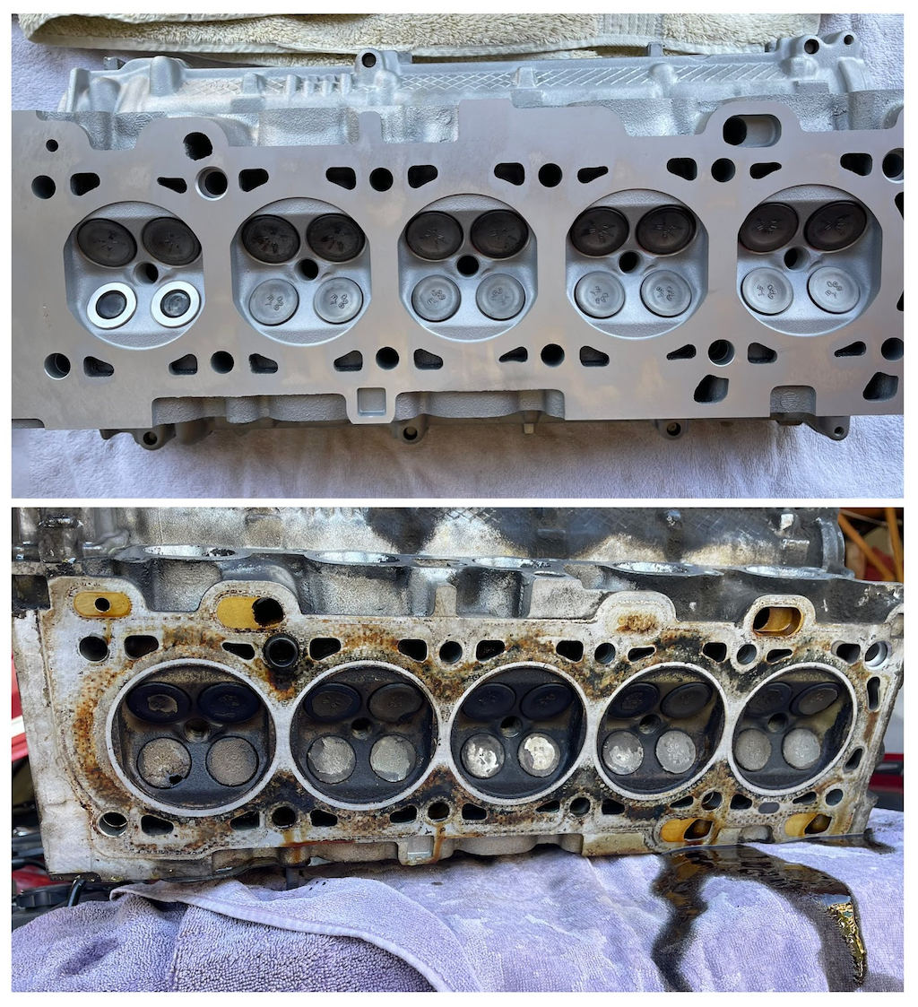

I finally got my remanufactured heads back from the machine shop. I knew what was coming, but the stark difference still startles me.
I'll just let the pictures do the talking. I can't wait until I get to put this on next week.
As you can see, amazing the difference.
Here's a closeup on the exhaust valves on #1. I purchased new valves from FCP Euro. They don't look quite like the stock Volvo valves, but I guess I'll never see these again after installation. As you can see in the "Before" picture, the bottom left exhaust valve had a chunk gone. Finally, here' how the other side looks. The valve cover still has some gasket residue, but I think that'll be much easier to get off now that the major stuff is gone. All in all, this work cost me $505.
Resurfacing was $75.
Valve job was $350.
Pressure test was $75.
Then there was a $5 Hazardous waste fee. I don't see an entry for cleaning. I guess they just wrapped it all into one of the other steps. The machine shop that did my head was the same as the one who did my BMW many years back. They do a really great job.
