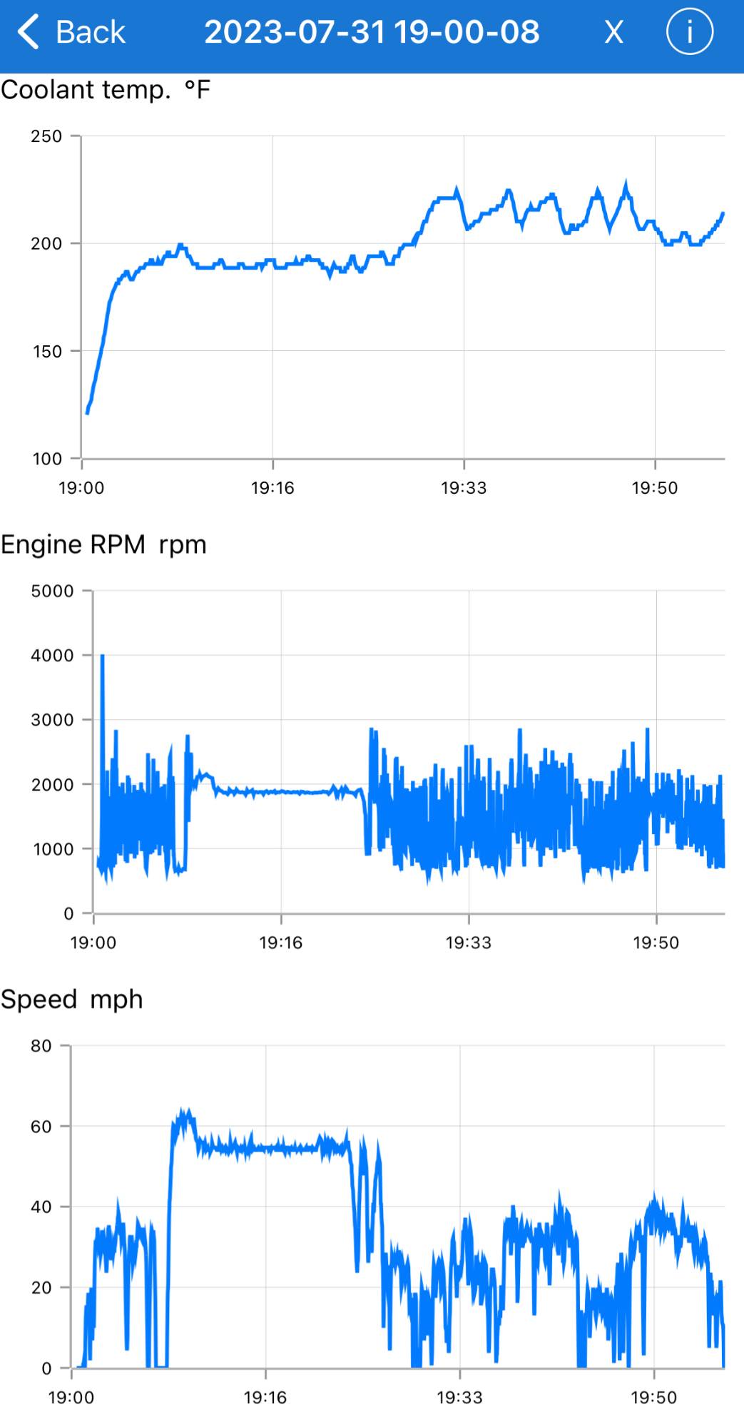

Here are some charts I gathered on a longer drive a few weeks ago. You can see it settle into the above mentioned coolant temp cycle after 20 minutes. The other factor is that driving at highway speeds usually cools the engine down without the fan needing to kick in, but unfortunately this car is most often used for lots of stop-and-go city driving with long periods of idling, so the cooling fan is probably being called on more often.

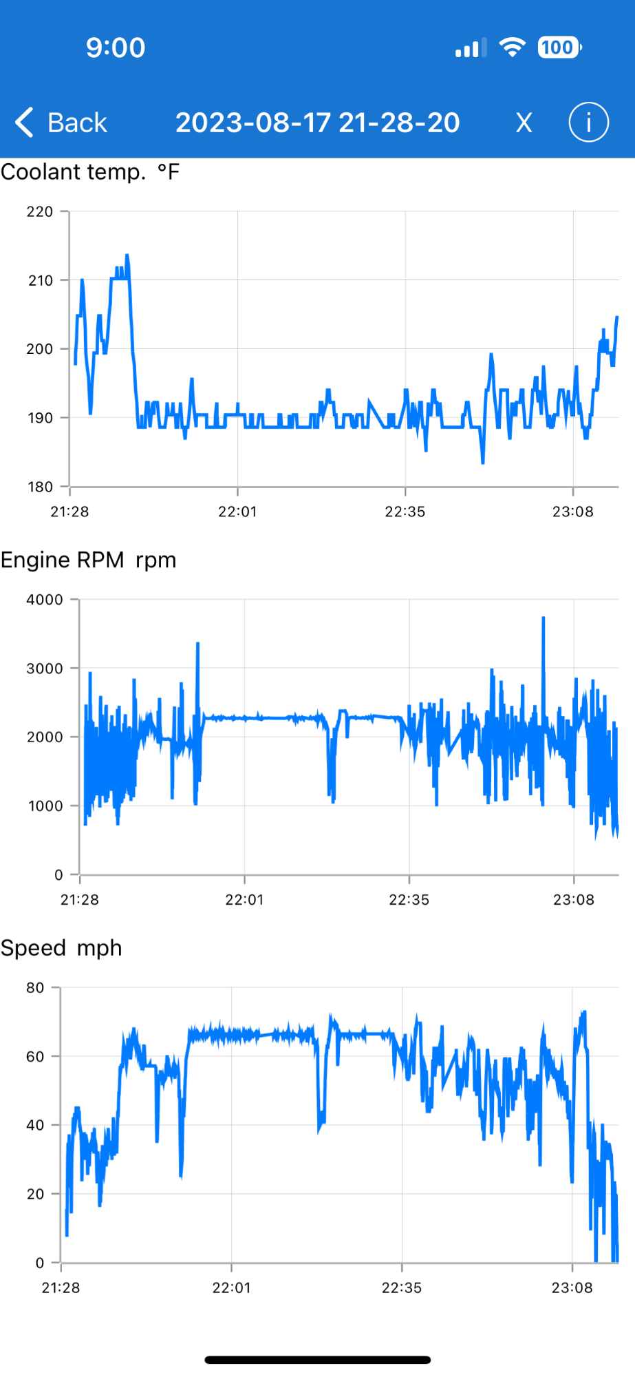

Your temperature readings look ok and aren’t indicative of anything major. If you do have a slight leak which doesn’t let the system come up to pressure, you will see some steam. Cycling between 225 and 190 might be a bit higher than normal , I’ll try to check my 2005

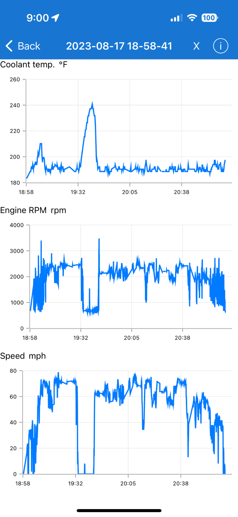

Here are some graphs of OBD data from a drive I took on Thursday.
The first one is a drive from Salem down to Woods Hole with a stop shortly into the drive to get some dinner at a drive-thru. Drive time total was about 1 hour 50 minutes for 104 miles (167 km). ECT held steady around 190F (88C) while driving on the highway, thanks I assume to the wind-cooled engine - no need for the engine fan to kick in. However, you can see an alarming jump in ECT at the point where I got off the highway for dinner after about 10 minutes of driving at city speeds followed by 20 minutes of driving at highway speeds. I watched as the ECT quickly crept up from 190F (88C) to over 240F (115C). I got a bit nervous waiting for the fan to kick in to cool it down, so I forced some cooling by turning the heaters on full blast and waited for the heat to come down before I got back on the highway. I suspect that the engine fan didn't come on when it was supposed to, since typically it comes on between 226-230F (108-110C). Unfortunately I wasn't able to get out of the car and verify whether the fan was on since I was in a drive-thru line at the time.
The second graph is from the drive home from Woods Hole to Salem. Drive time total was again 1 hour 50 minutes for 93 miles (149km) (different route!). This time there was no alarming jump in ECT - it held steady around 190F (88C) on the highway, and did start to creep up again after getting off the highway, but didn't have the chance to get high enough for the fan to attempt to kick in before I got home.
It's been 1 week since we had the coolant boilover incident. Since then I haven't lost any coolant, although there have been a couple of points where the ECT gets alarmingly high and the fan doesn't seem to be cooling it down when it should.
It seems like either something is happening in the engine that makes it heat up so much that the fan can't keep with it, or the engine is operating normally and the fan is failing to kick in when it should.
Any thoughts on next steps for diagnosis?

Those aren’t crazy numbers, 240 F isn’t high for a heat soaked engine coming down to idle. With AC on the fan should be on so you might have a seized fan or relay wiring problem there.

I'd say it looks like , as abscate says, a cooling fan problem. Its not kicking in.
it works when the ac is on but not when temp commanded. if that is so then its the ...I don't know which sensor is responsible, the one next to the thermostat maybe.?
check power and ground at the fan plug, you should also get a low computer v reading on the signal wire (purple ?), maybe 2 to 5v.
12v power is always on, switched by grounding done in the relay which is usually built into the fan housing.
but yours is 2001 so it might not be integrated like my 04.
If yours has the bosch controller on the fan its designed to fail on at 100% speed, its better to have it run constantly to a flat battery than blow the cooling system and head gasket.
as you aren't having that problem ,again, its indicating the temp sensor or signal wire. Temp sensor sends signal to the ECM , it comes out of the ECM in the small purple wire. I found my signal wire dead at the fan, I snipped it near the ECM and put a signal on it , then just used a cheap fox and hound circuit tracer to find the break. Replaced the bad section and repaired the wire I cut with heat shrink and liquid tape, alls well now.
Just below the pass side headlight, find the large main loom, find the purple wire and try a piercing probe to see if theres any signal coming out the ECM. From there it goes to the power distribution box above the ABS pump, you can backprobe the plug at the box.
just keep chasing it.
