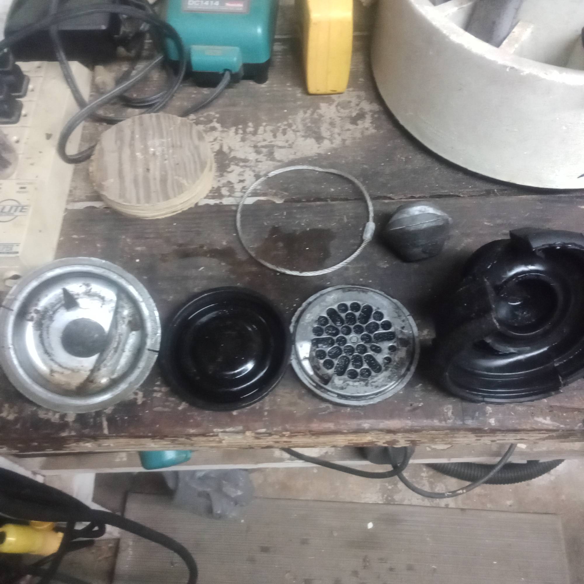

For those interested. A disected OEM rear engine mount from a 2000 S70 GLT SE that was leaking.
. I saw in another thread that aftermarket mounts maybe solid rubber and not hydraulic. I did replace my rear mount with a Corteco so maybe that's why I have the vibration?

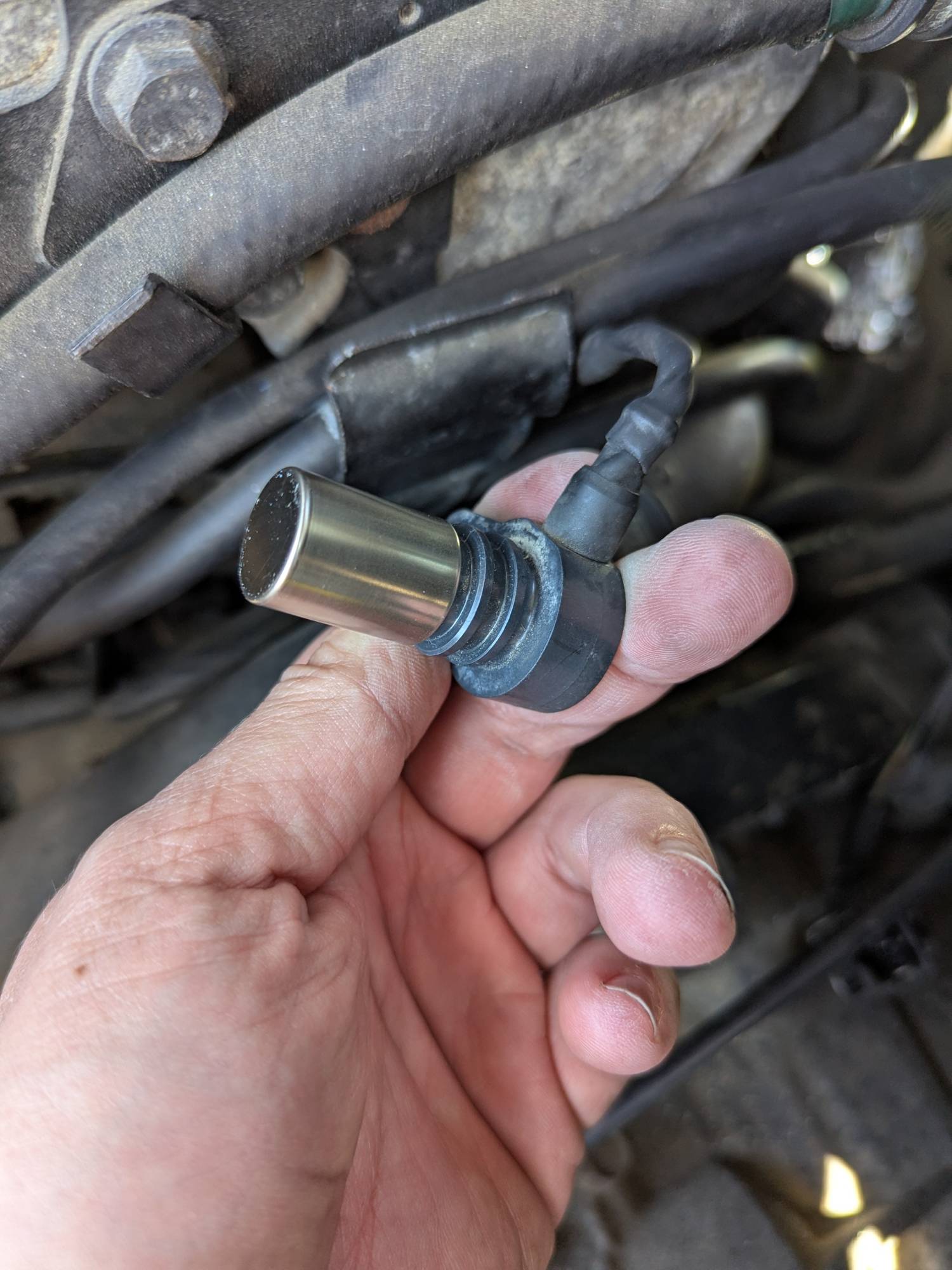

Well it doesn't appear that my P0014 was coming from a dirty sensor.
Good news - my seal is intact.
But the next trigger for this code would seem to be try cleaning the cvvt.
And doing a final confirmation of the timing marks.
I suppose the Camshaft Position sensor could be faulty itself - but would that present itself all the time?
Here is the shiny sensor.
There is some very light scoring on the bottom but it was pristine clean.
