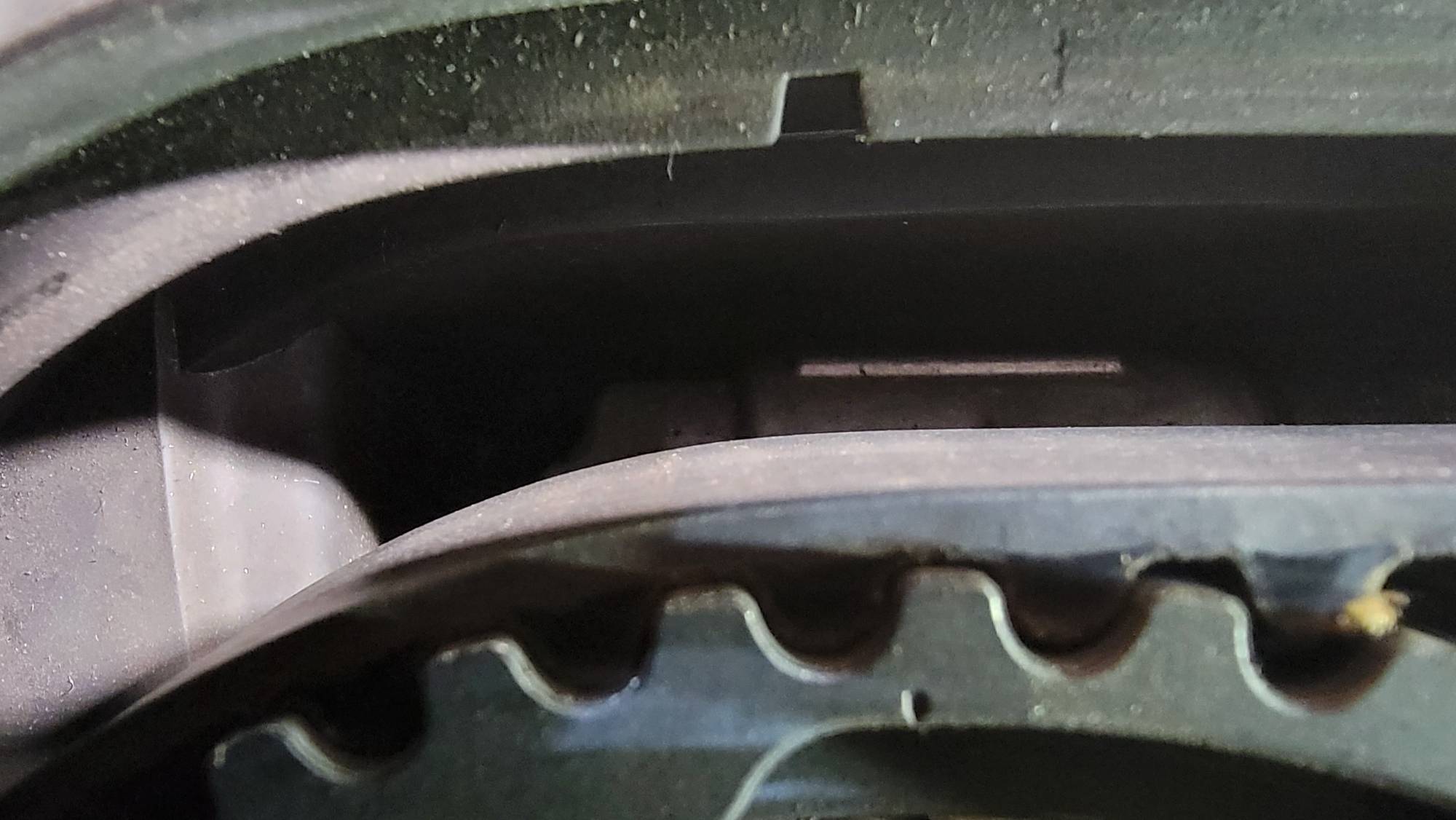

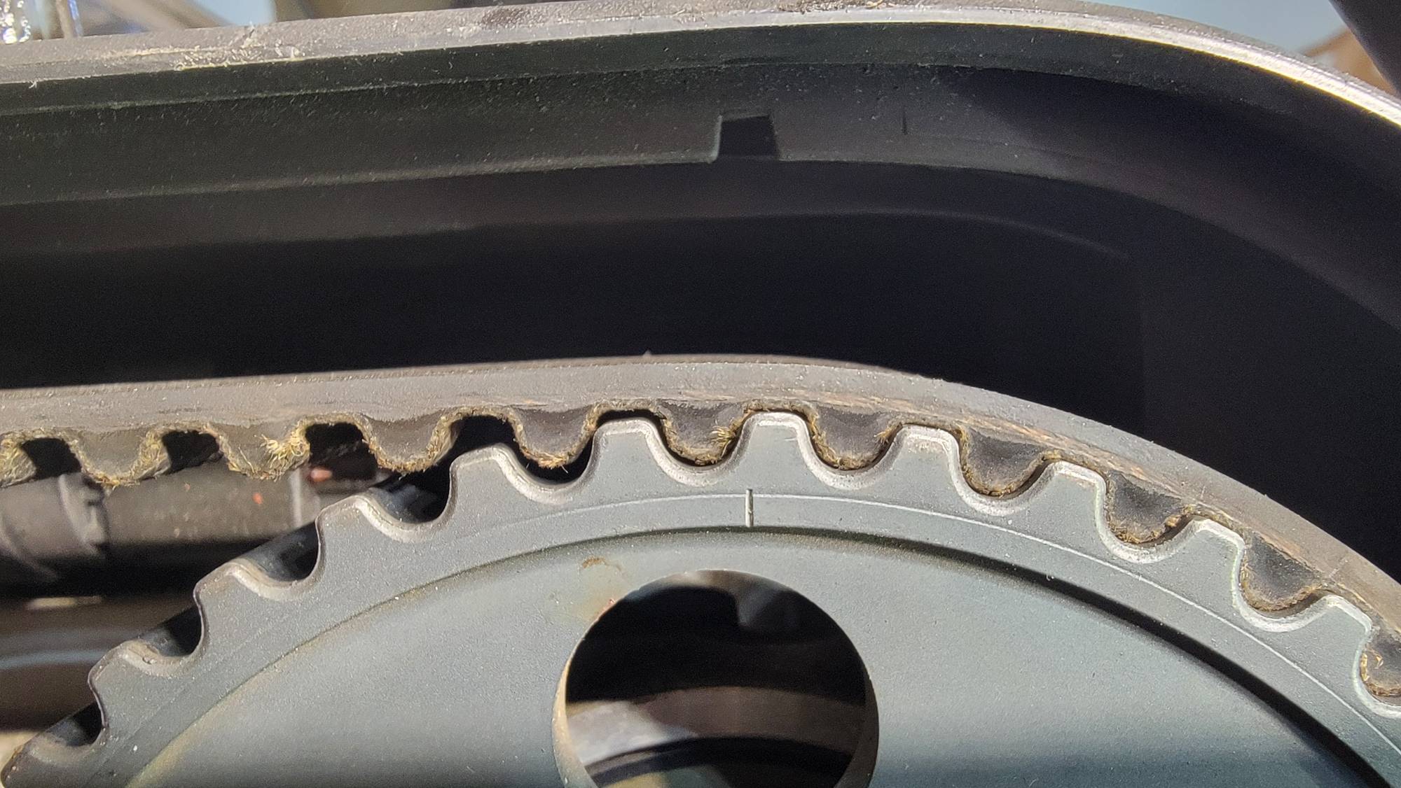

Ugh. I'm guessing I did *not* have the time marks right and I was off an notch. I pulled off the timing belt cover and checked the timing marks. It looks spot on to me. I did have trouble with the tensioner when putting it back. Tension feels good. However, could the tension be the problem?

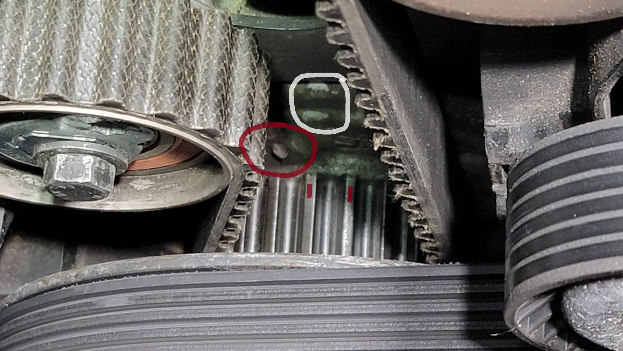

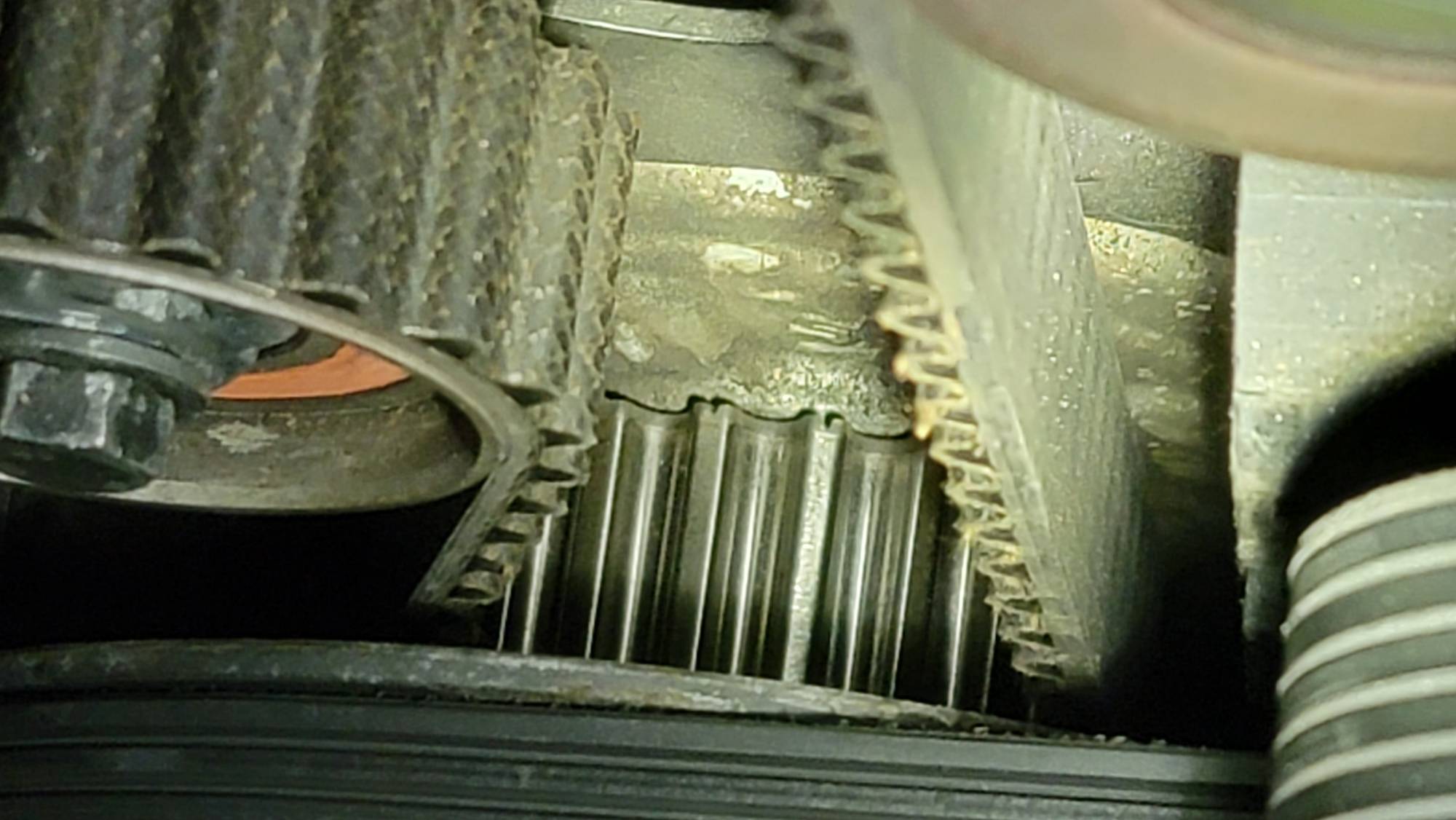

Yeah, I believe you are correct. Upon closer inspection, I think the timing is off one. The question is, how to I get it realigned? I've been searching and I cannot find any good demo for fixing it once you screw it up. I've attached some pictures. Question on the crankshaft gear, which mark is the correct alignment? The red circle or the white circle? I thought it was white. I bet I got that wrong too...
"You can put crankshaft into tdc using marks without using special crankshaft holder tool."
How do I do this? Release tension, move the exhaust by hand back a notch? Advance crank by the 30mm nut?

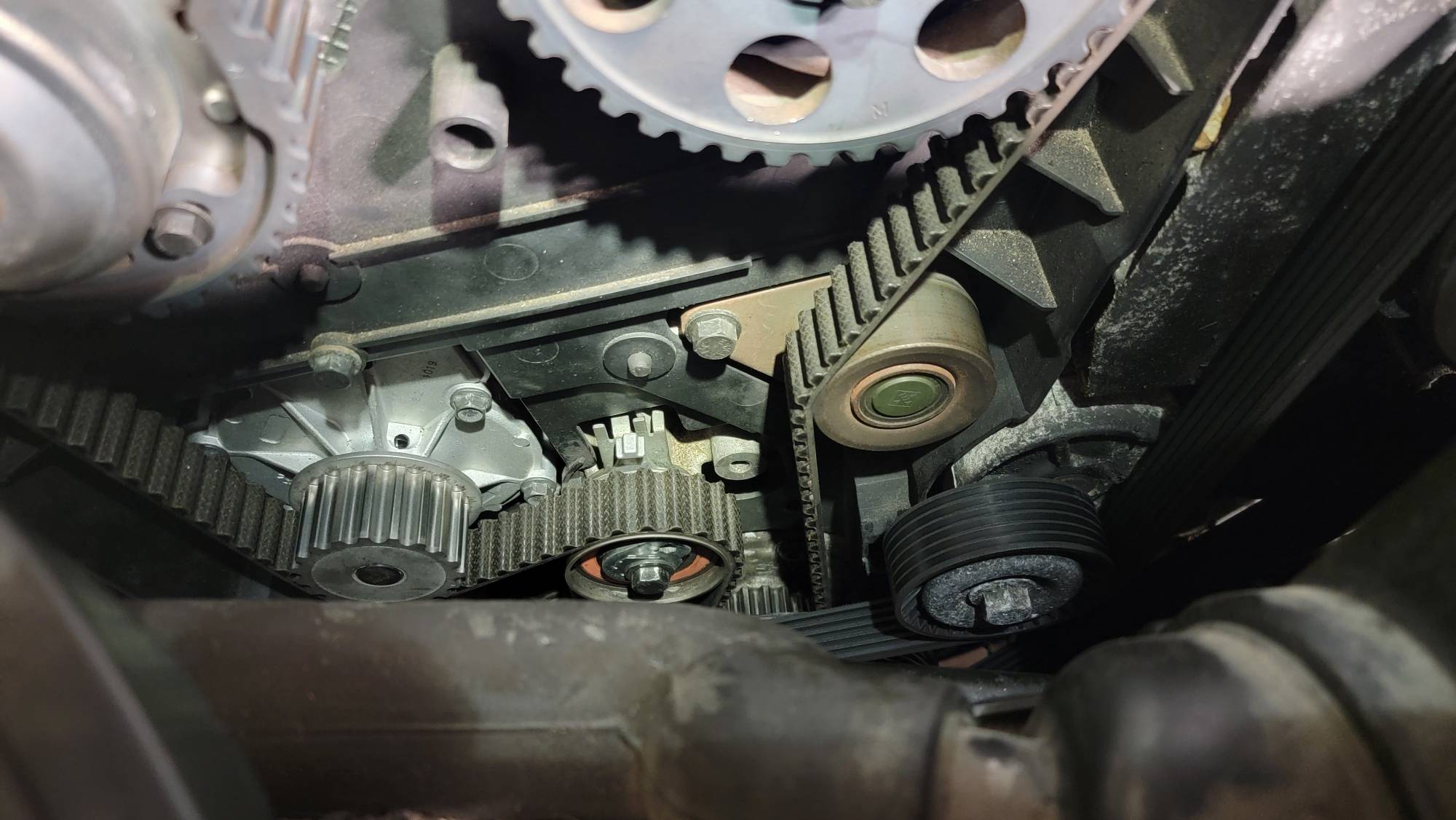

Here's a picture of the idler I'm suspicious of making noise. Something in this engine is noisy at idle.

Timing belt idler. I replaced one leaking cam seal the first month I had the car. I've been watching a lot of Robert's videos. Yes, I will replace that idler. I put a picture of it above.foggydogg wrote: 04 Jul 2025, 22:41Which idler, timing belt or serpentine ? If it's on the timing belt, several of us have lost motors when that bearing fails, so prudence would suggest replacing it anyway.

As suggested, I'd get a cam lock tool before doing anything else. In fact I'm not sure you can do this job without it, since you have to load up the VVT hub while aligning its sprocket. Basically -
Rotate the crank by hand till it lines up with its mark ( red circle )
Belt off
Install cam locking tool
Turn the crank another 90* clockwise, then back counterclockwise to its mark
Slip the belt on everything except for the exhaust sprocket. Intake and crank should be lined up on their marks
Load the VVT hub by turning it all the way clockwise
While holding the hub all the way clockwise, align its sprocket with its mark and slip the belt on the sprocket
This can be a royal PITA. A second set of hands helps, if doing nothing else but holding the VVT hub in its clockwise position while you get the sprocket and belt on.
Belt off

I hand cranked the crankshaft to the correct position (red circle indicated picture above) until it was in the aligned and the exhaust and intake cam marks were minus one tooth from TDC because that was the best I could do.
Released the tension.
Slipped the belt off the cams
adjusted them by hand one tooth and aligned with TDC marks.
Put the belt back on
Applied tension
cleared the error via OBD-II
Took it for a spin.
She ran like a champ.
