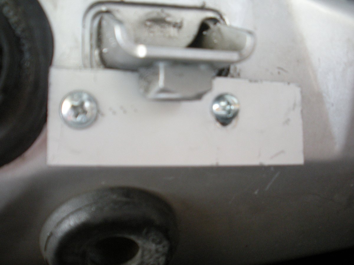

I've got the door popping problem and my pillar welds are SHOT. (See attached photo...crack is pretty serious and descends down the pillar an inch or more.)
Question is whether "weld-removal / bolt replacement" technique will actually work for me...what do the bolts actually secure or anchor to?
Is my door beyond repair in this method? How about this method?
Do I need to suck it up and go to the body shop?

Tapping a thread throught the spot weld worked for me on my 850 wagon last year before I sold it.
I used 10mm head with 6mm X 1.0 metric thread I think it was.
Don't know if the repair lasted but it looked pretty solid and got rid of that pesky noise whenever I opened the driver's door.
