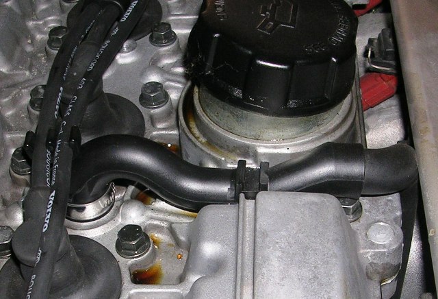

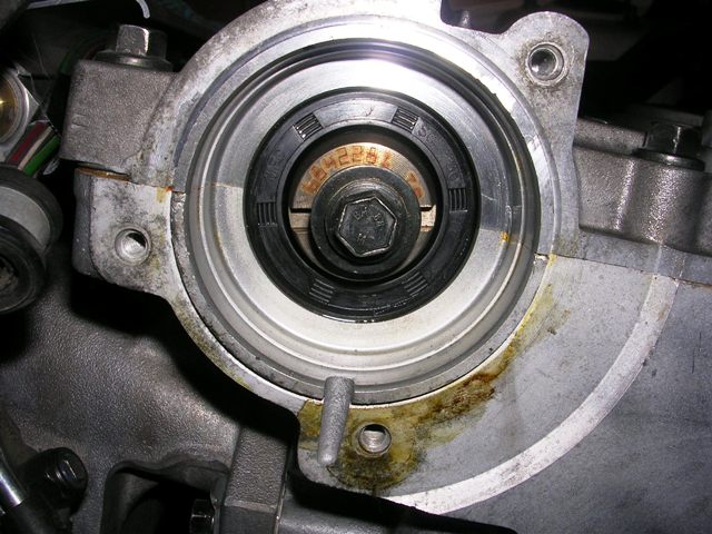

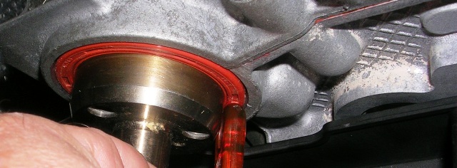

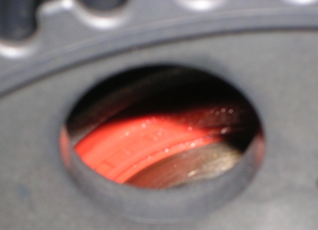

Additionally noticed oil deposits around the oil fill port plus removing the spark plug cover noted oil which has blown out of the oil cap and depositied into the head.......?? normal or must have higher than desired internal to engine pressure but thinking I should have a vacuum condition but might have a vacuum leak due to my reoccuring P0505 code but actually have maybe high internal compression caused by my elusive maybe block/head crack which increases the internal pressure which pushed oil out the oil cap and pushes the cam seal(s) out???...........
Next - list the open questions and the plan of attack.........

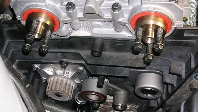

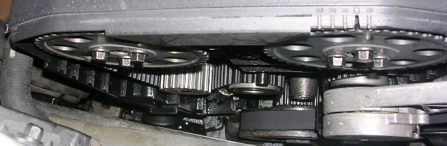

Would it be possible for me with 'dental tools' to cleam the ID cam and the OD of the seal and push it back on?
Installing the camshaft retaining tool on the back end of the cams and removing the timing belt is a very big job.
-Fordman
