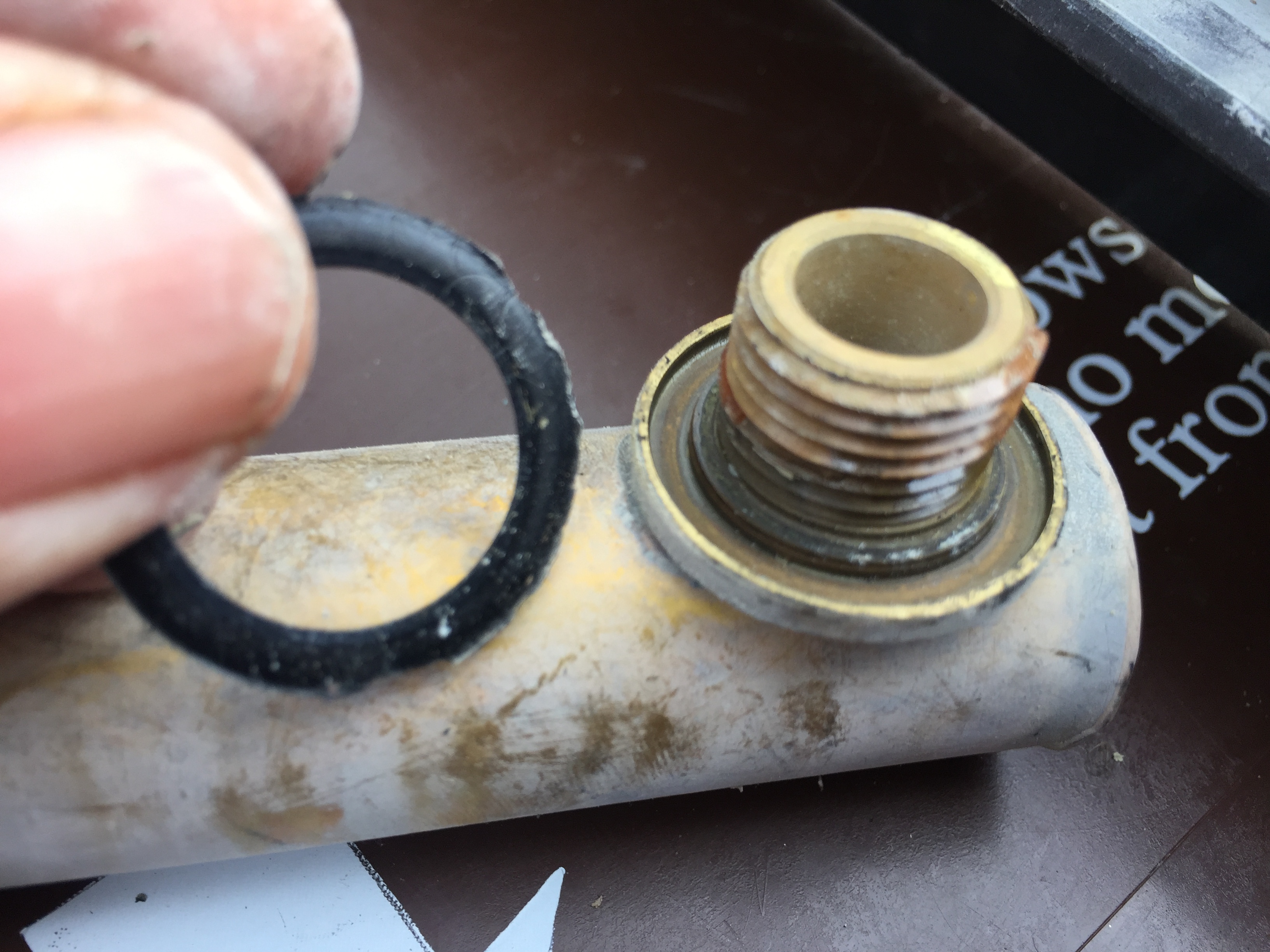

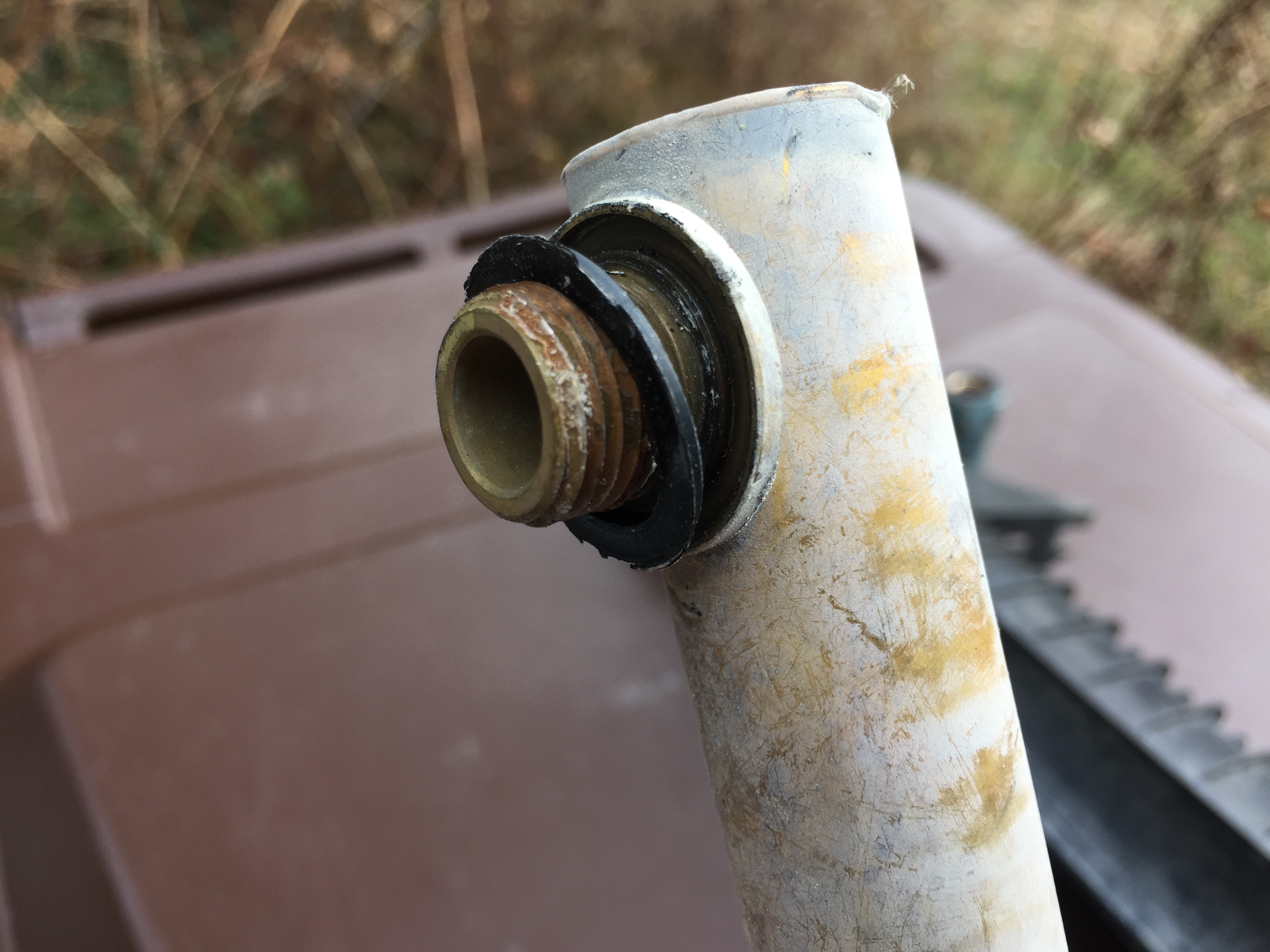

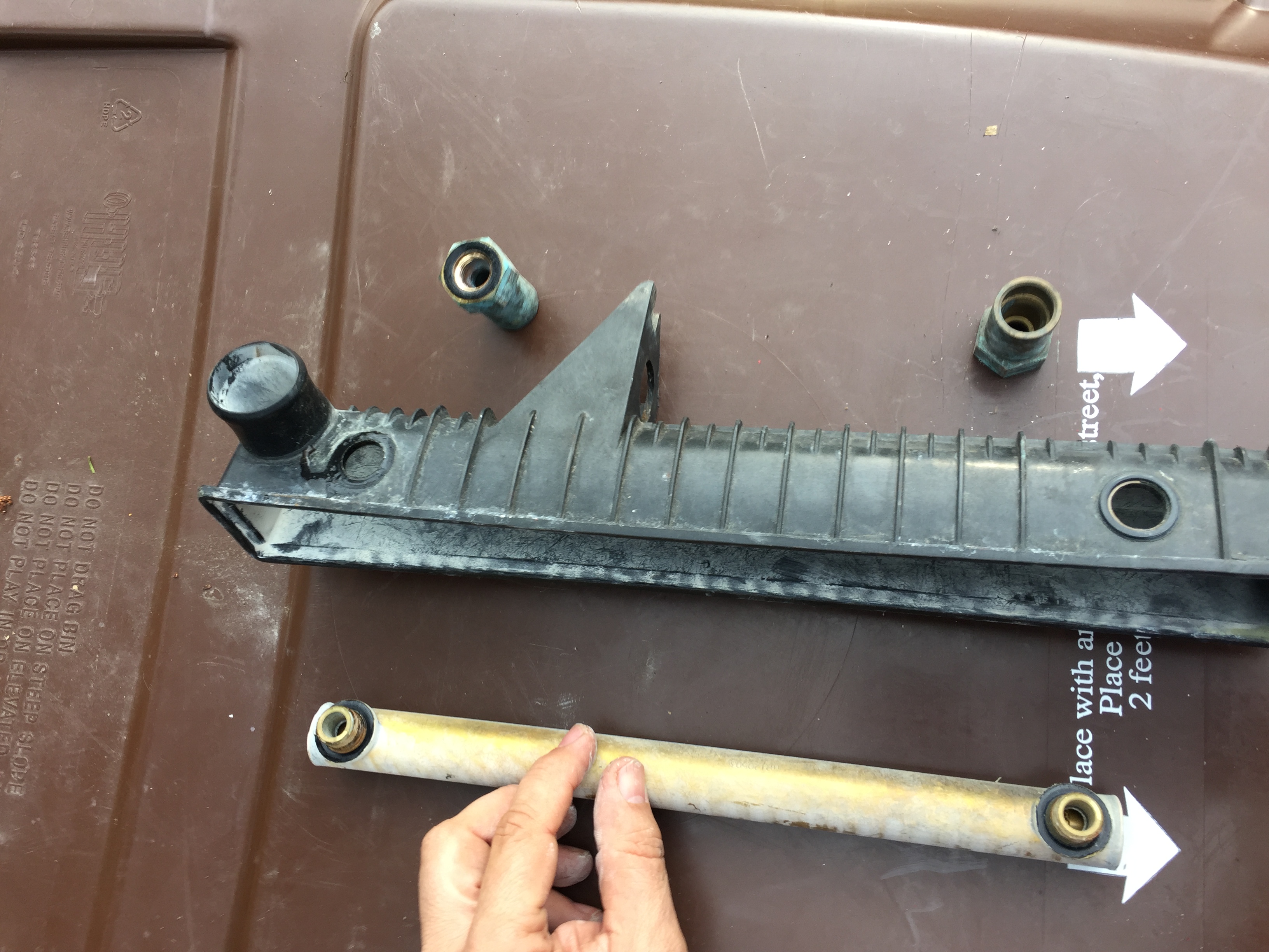

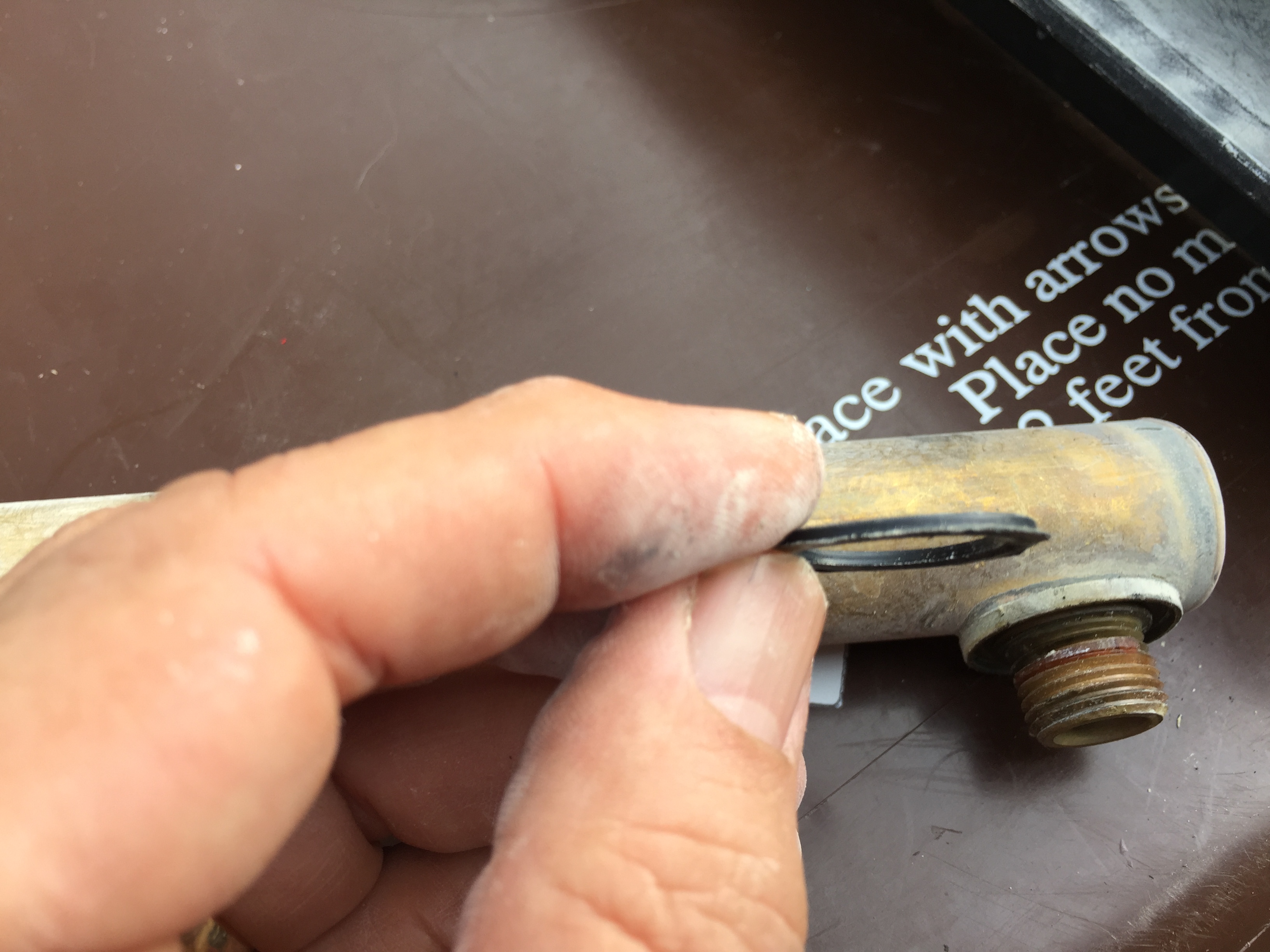

I took another look at abscate's photos for 1999 model, it looks like the the rubber washer sits on the INSIDE of the Nissens radiator. Kind of makes sense as this seals the coolant from getting to the outside world.
- Maybe all I need is to tighten the hex (on the cooler port) a tiny bit, just to seat the rubber seal better?
- Or maybe I should add another seal on the OUTSIDE of the radiator?
Still thinking...
Still thinking...

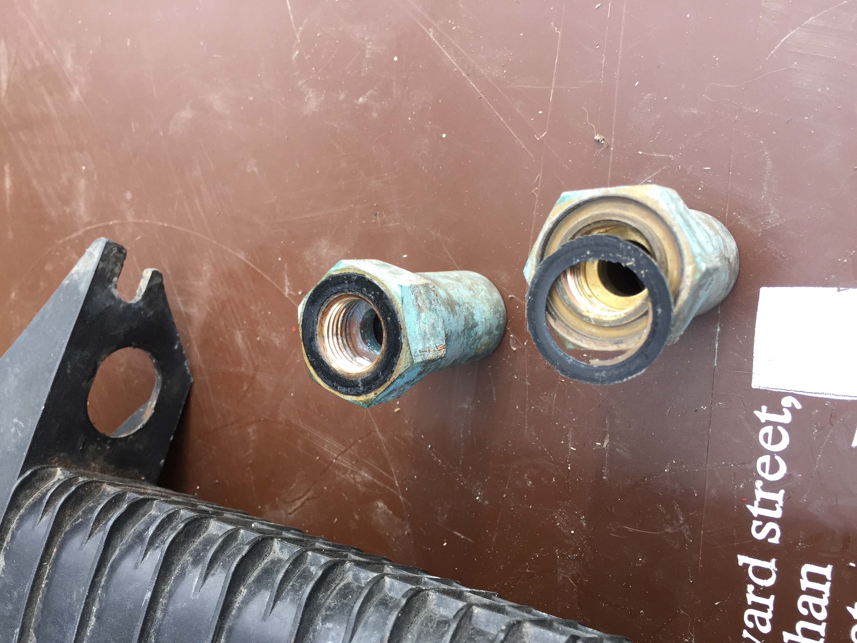

- Posts: 36149
I think I can find it. I'm not sure there was a gasket or Oring
Two rubber gaskets on transmission cooler!!

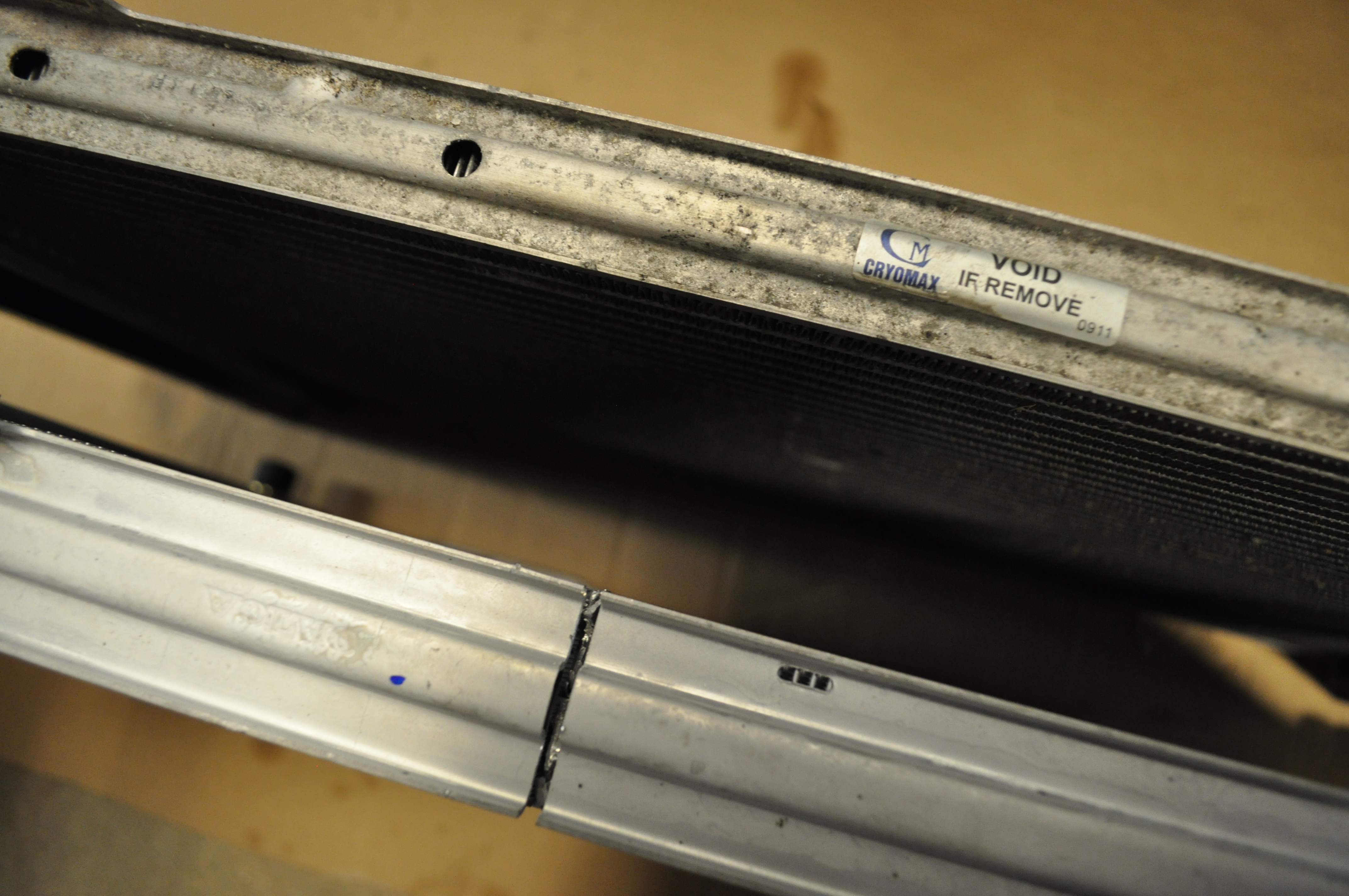

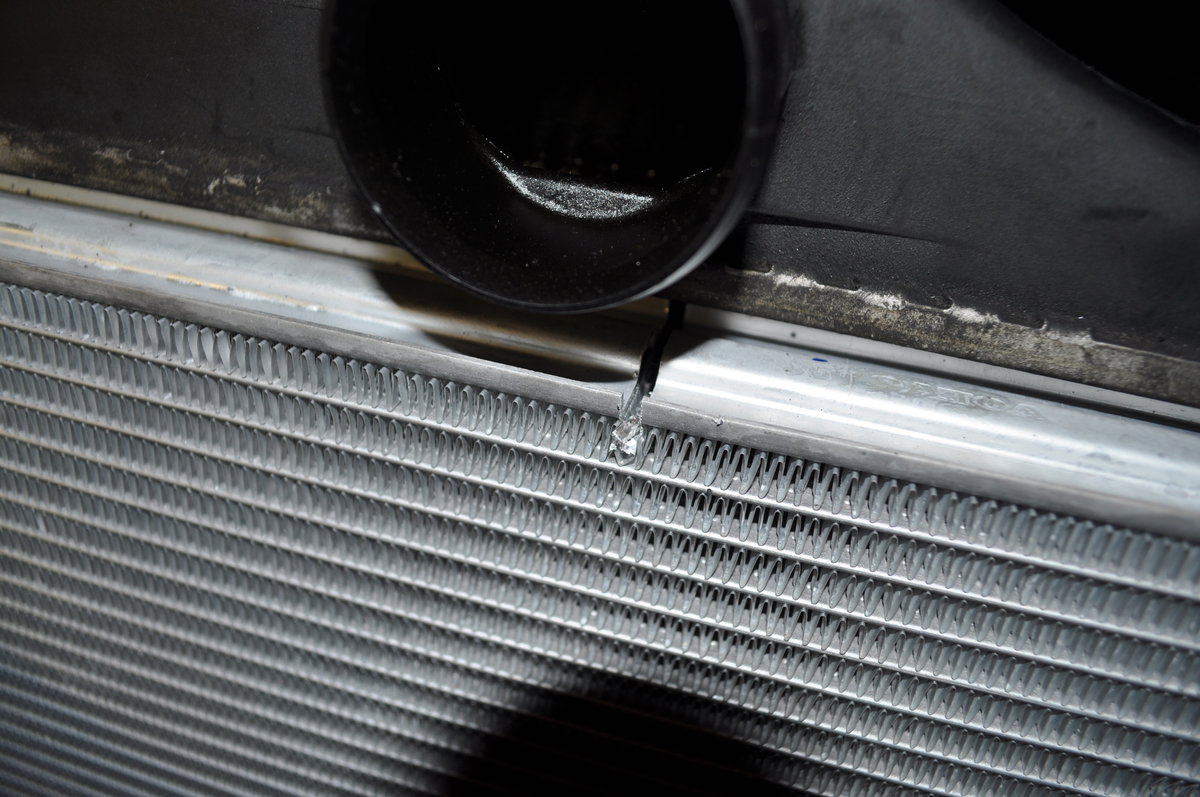

UPDATE,
Found the leak! Just replaced the “Crymoax” Radiator, installed by Volvo dealer in 2010 at 130K or so.
* Car is now 7y/57K miles later, the Cryomax rad cracked at 2 places:
1. Driver’s side Mounting tab.
2. Tiny vertical crack below the Passenger’s side Upper Outlet, only leaked coolant when hot (under pressure).
- The Cryomax looks ”OEM” with rubber mounts etc., but from what I understand it is made in Taiwan, so my theory is back in 2010 with P.O., Volvo bought the radiator from some local supplier such as Napa etc. and installed it, b/c I am not aware of Cryomax being OEM supplier.
- I thought it was leaking from the cooler fitting, so I tried all kinds of stuff (garden hose washer, copper washer etc. etc.) to no avail, only after the rad was removed then I realized the minor crack is below the upper outlet, difficult to see in the car. Interesting crack, very different from the typical circular crack that detaches from the radiator.

Grrrr, that is so disappointing, another very shady move by a dealer.cn90 wrote: 10 Dec 2017, 15:45 ... Just replaced the “Cryomax” Radiator, installed by Volvo dealer in 2010 at 130K or so. ...
I know you haven't had this car very long, PO installed that rad, but do you know: did the dealership charge the PO the full cost they would for a true blue box part? Which dealer was it?
I'm guessing they didn't have one in stock so picked it up from the local NAPA or whatever. I've heard of them doing that with axles, for example. Some people will say "hey the Volvo dealer installed it, it must be good" but thats just being blind. It's so important to know to what extent your local dealer service department can be trusted.
You can get that Cryomax rad for under $200 from IPD, it is their aftermarket part these days.
