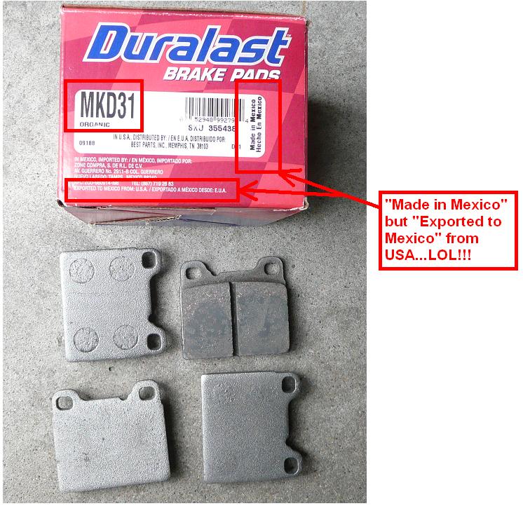

However, Autozone does not carry "Duralast Gold" for 1998 S70, so I bought the "Basic" version.
MKD31 type. What a disaster, it is loud like 3 school buses put together!
This happens even I used anti-squeal compound.
3. Just happened to be at junk yard and saw newish looking pads (with about thickness = 9mm), pulled them, they were Mintex. I paid $4 for this junk yard set.
Installed Mintex, zero squeal.
So, IMHO, Mintex is the ticket!
PS: Want some good laugh? The Autozone brake pad box says:
"Made in Mexico", then another part says
"Exported to Mexico, from the USA"....LOL!!!

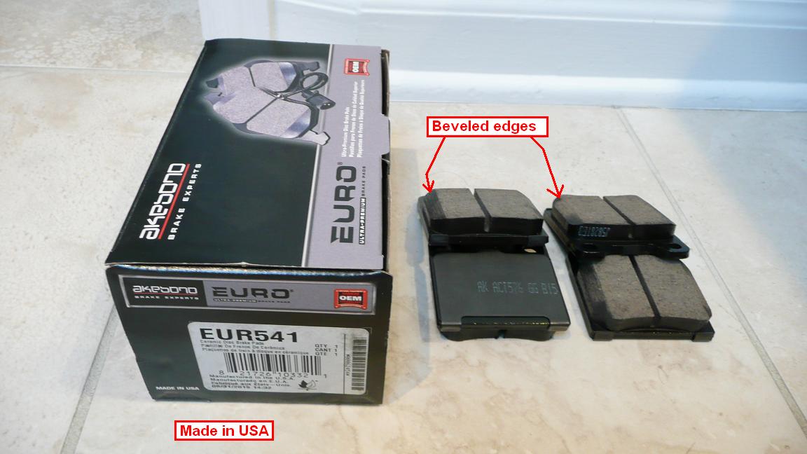

The REAR Mintex pads (New rotors from Zimmermann) were quiet for about 2 years, now it is noisy again. And since it is down to 2mm, I need to replace them anyway.
After reading some forums and amazon reviews saying Akebono pad is quiet, I settled for Akebono EUR541 ($36 on ebay etc.).
WRONG! Installed the Akebono (yes I use anti-squeal compound) and it is noisy for the last few days, even after I went on highway and did some "brake bedding" (a series of braking from 70 mph in the middle of nowhere).
So, I can only hope that the Akebono becomes quiet with time. I will give it a few weeks to settle down.
As a consolation, the Akebono was made in USA...lol.
PS: I think the root cause could be the "fixed caliper" design that does not allow the caliper to "flex" a bit here and there to conform to the piston angle.
The FRONT is floating caliper design and I never have squeal coming from the front!

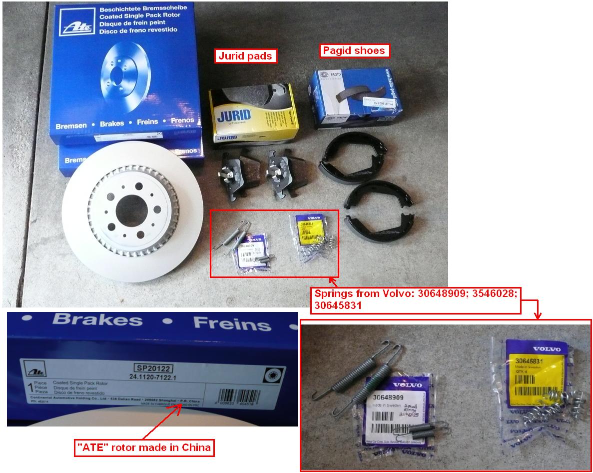

I also have a 2005 XC90 2.5T, did the Parking Brake, REAR Brake last year with Jurid pads (ATE rotors made in China whatever it means).
If the school bus brake squeal loudness is 5/10, the XC90 rear brake squeal is 2/10, not very loud but it is there at 4-5 mph, just prior to a stop.
You can see the brake parts that I installed in my 2005 XC90 2.5T:
