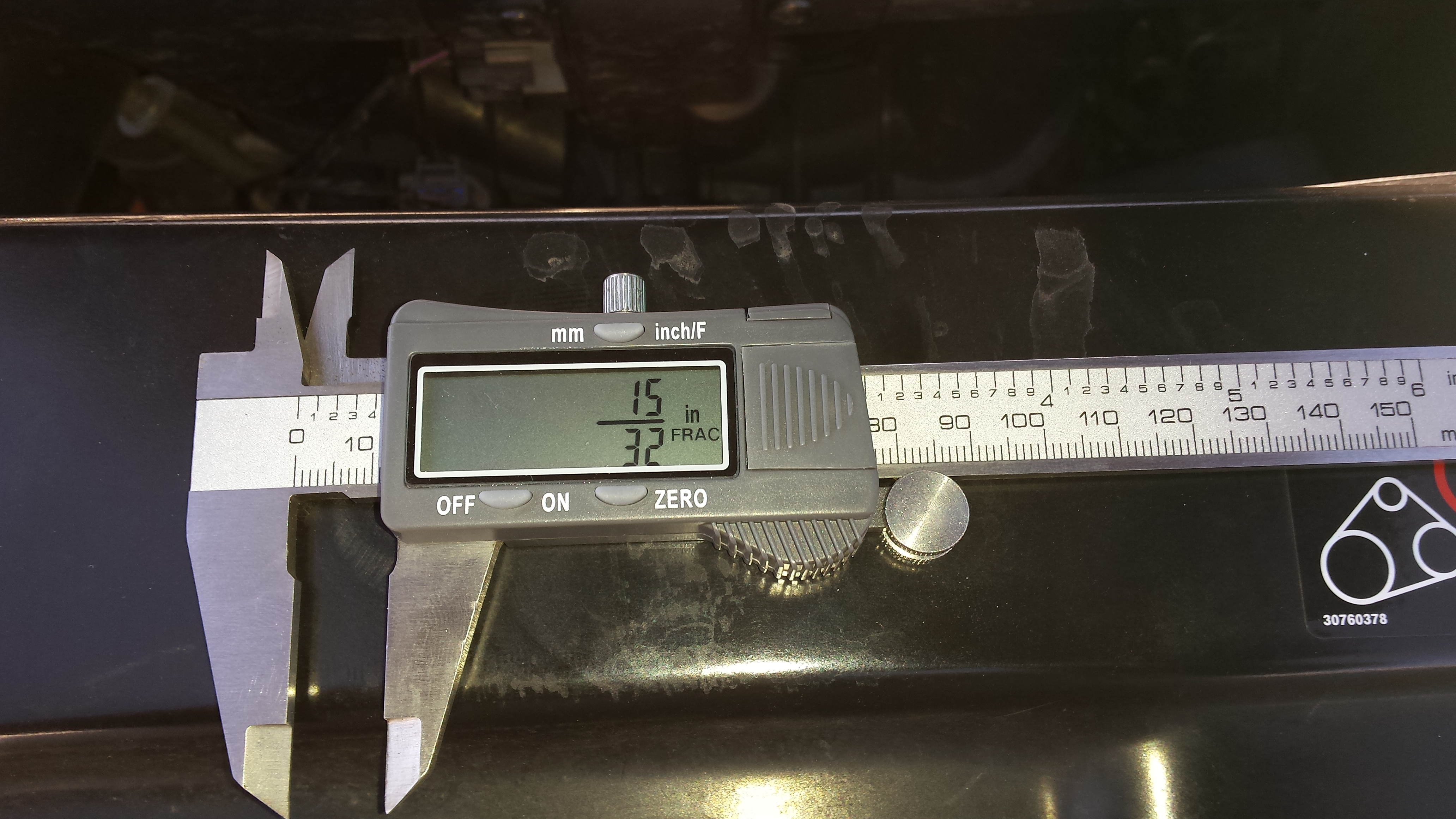

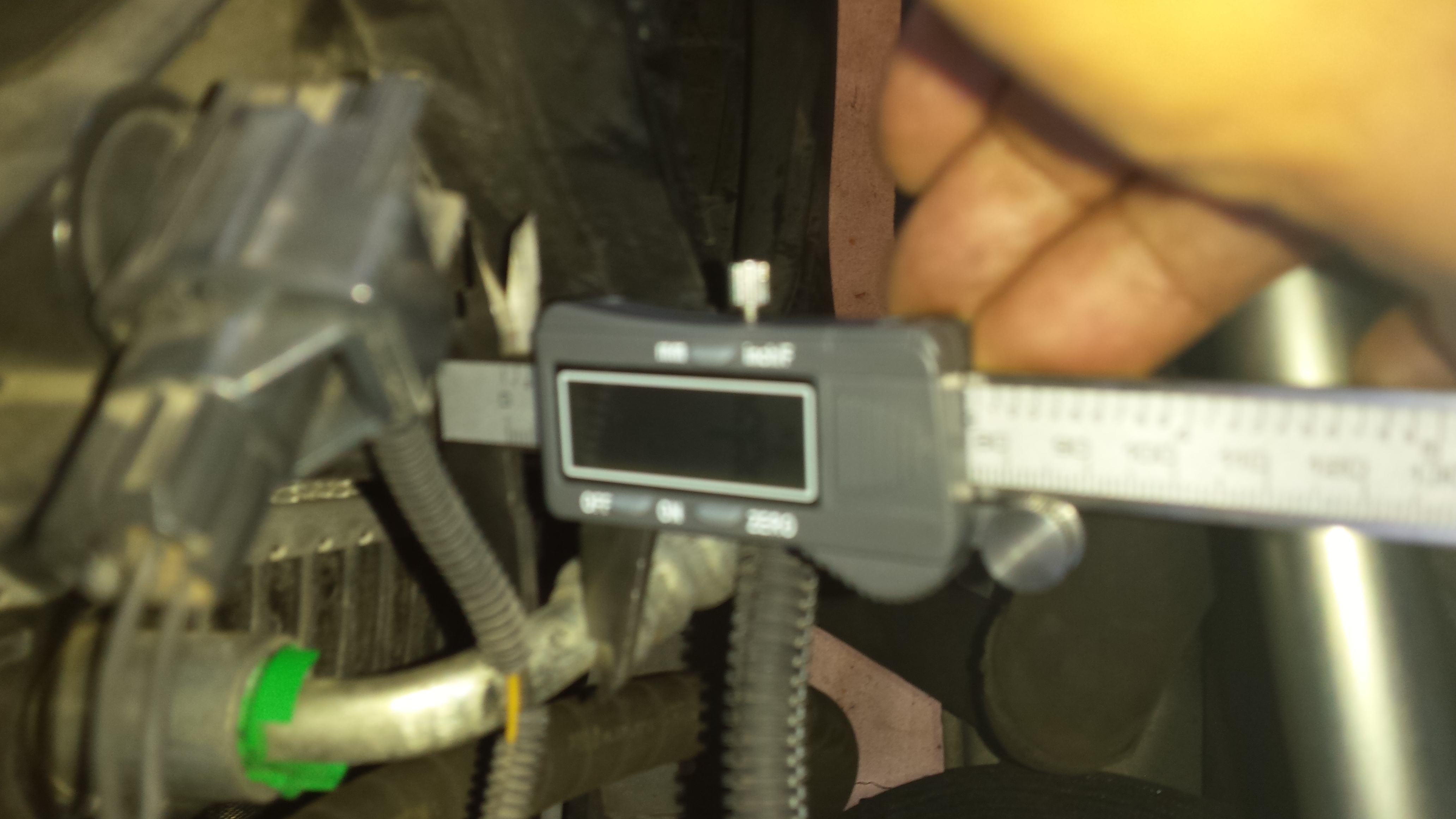

I have a 2008 XC90 and planning on installing a Magnefine filter. But before I start cutting a $106 hose, I just want to ask if anyone has ever installed one of these in their 2008 XC90. I measured the OD of the pipe connected to the upper radiator and it measured 15/32. Much bigger than 3/8. I dont know the ID of the hose but any info from those who installed a magnefne filter on their 2008 XC90 is much appreciated. The rubber hose is crimped on to the pipe. The only way find the ID is to cut it.

I believe the pipe that goes in the radiator is around 1/2" at where is has the two o-ring seals inside.
Gently press both sides of the green clip against the pipe, and while keeping the clip down this way, start shacking gently and pulling the hose with some force, it will come out without issues. You'll want to have the two yellow o-rings replaced.

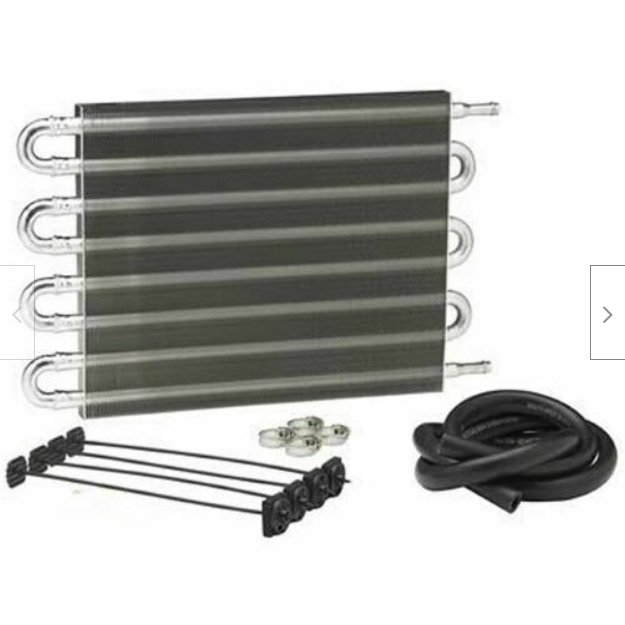

From the amount of metal shavings in the pan of the 03 S80 T6 I encountered early this year when it failed I wouldn't recommend these filters. Just put several strong magnets inside or outside the pan and change the fluid once or every two years. A transmission cooler, have installed several, is a better investment.
Currently have either the 1405 or 405 on the 03 Odyssey bypassing the radiator. Have done inline in the past but after researching decided to try the bypass. Well, the radiator inlet and outlet threads to the transmission cooler were stripped so...
I have 3 to 4 Magnefine packed somewhere and I'm glad I didn't have the time to install them. If anything maybe the power steering line.
https://www.ebay.com/itm/175200706964?_ ... 1417752579

Can use 2 brass T's and split the fluid flow if you want to use the filter. One side free flow the other side filtration.
