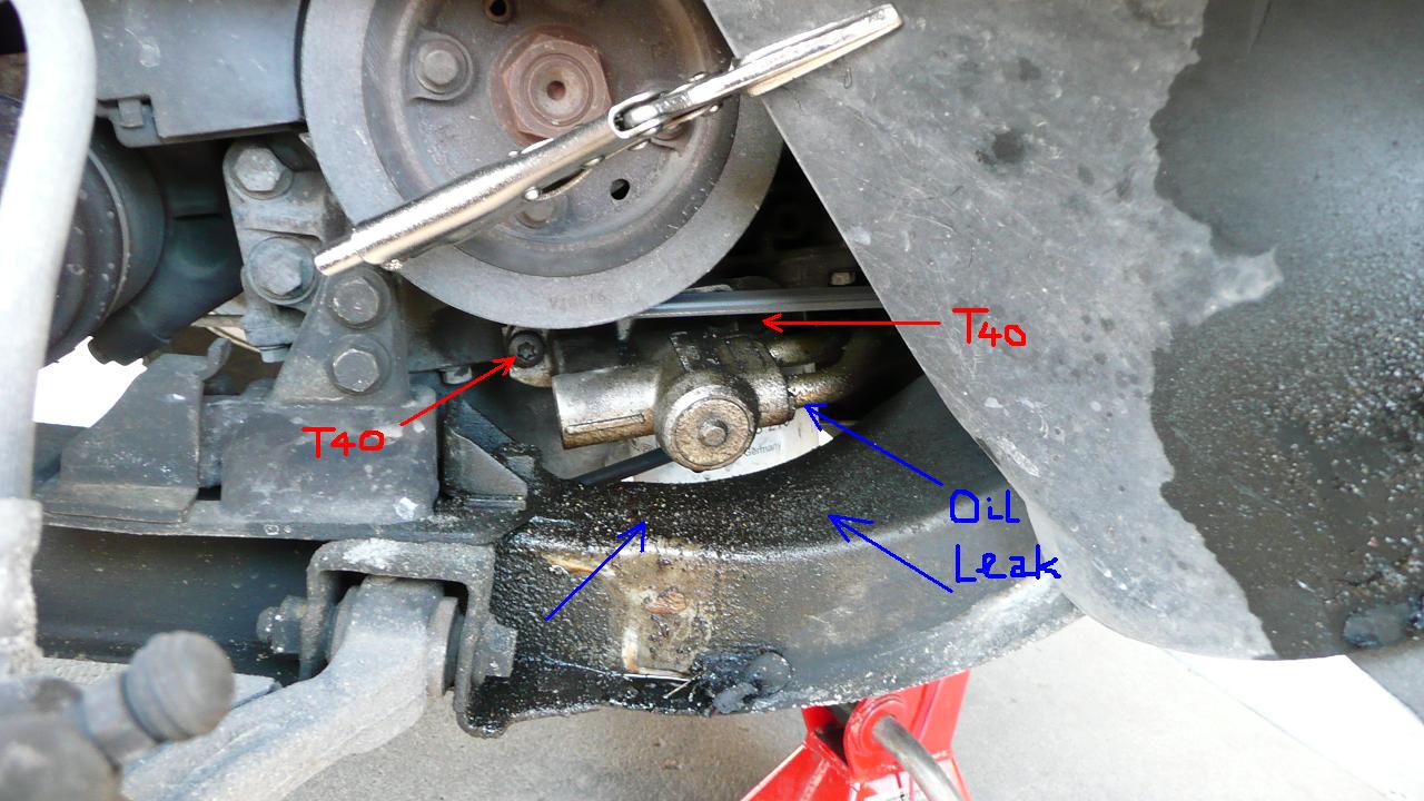

You are correct, the only way to replace the rectangular seal is via the wheel well. Even so, I stripped the rear T40 bolt!!! Read on...
1. Jack up RF area, remove wheel, fold back liner with vise-grip to expose the crank pulley, place jackstands under subframe etc.
- Now you can see the oil leak blown around during driving...
- For the records, P.O. replaced the oil cooler lines x2 and the O-rings, but didn't replace the rectangular seal. So the oil leak was at the rectangular seal area.

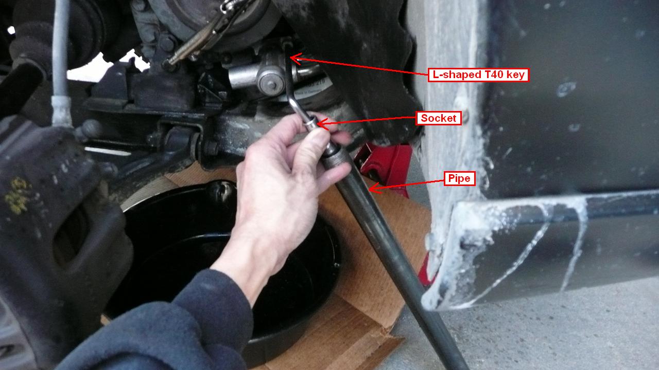

2. The FRONT T40 came out nice and easy with this combo:
* L-shaped T40 key + socket + iron pipe.

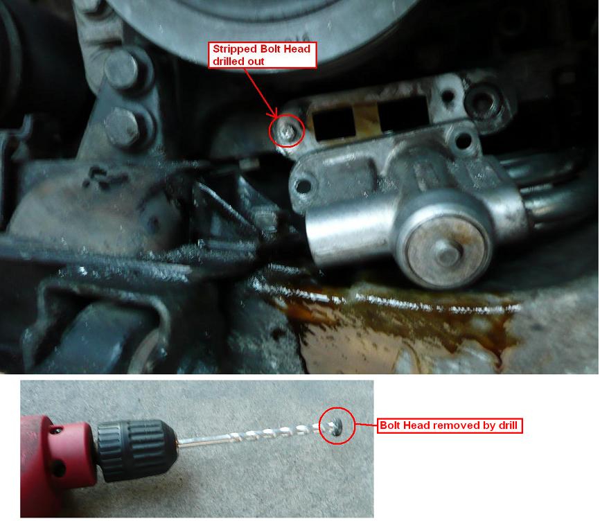

3. The REAR T40: I stripped it, even with tons of caution (going slow, making sure the T40 key fit properly in the hole etc. etc.). It took close to 1.5h to drill out the bolt head! Finally I realized I had a masonry drill bit, which made the drilling job easier. The bolt head came out. Then I used vise-grips to remove the broken stud.
The dealer was closed, so I used an old Tstat housing bolt (it was longer so I used some nuts/washers to achieve correct height) as a temp fix until I get the correct bolt.
The bottom line: get new bolts before starting this job!

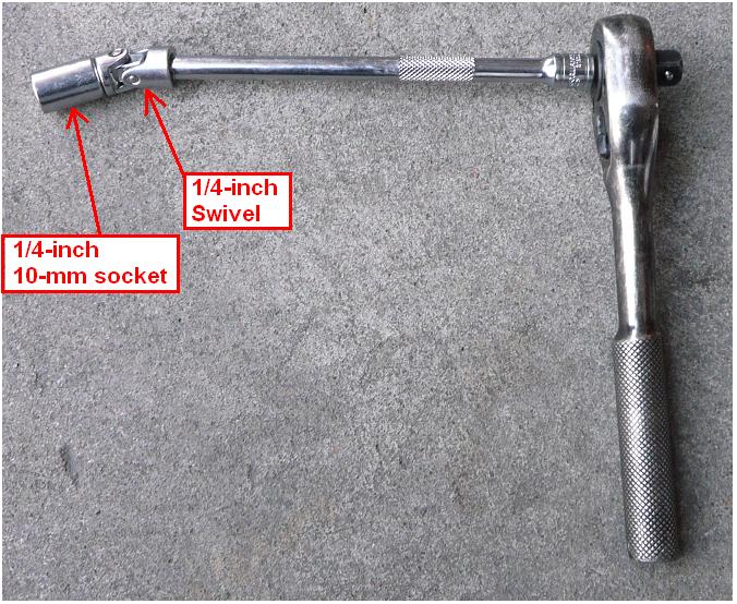

4. For the 10-mm bolt holding the cooler lines bracket (near the AC compressor). The only combo that worked:
* 1/4-inch 10-mm socket + 1/4-inch swivel + 1/4-inch extension/ratchet.

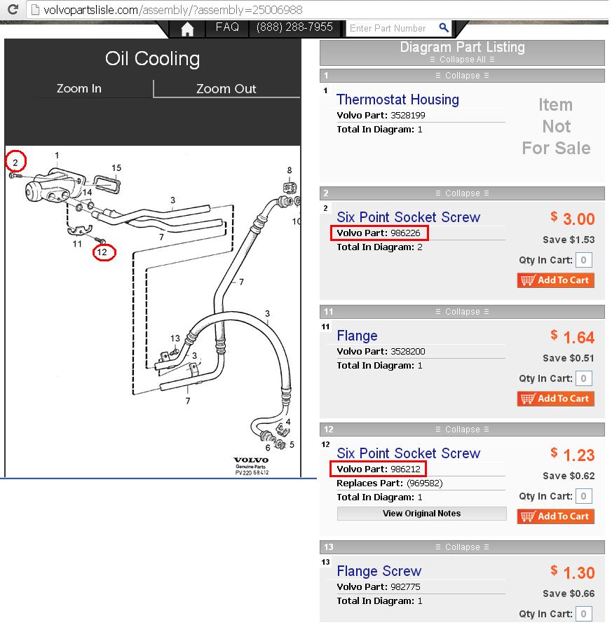

Can some gurus help re PN? I need PN for:
1. The two (2) T40 bolts that hold the oil tstat housing to the engine.
2. The single Torx bolt that holds the 2 cooler lines to the tstat housing.
Thanks!
Thanks!

I came across a Volvo website (Volvo of Lisle parts website) and saw these PNs:
* The two (2) Torx bolts: 986226. But when checking 986226, it seems this bolt is longer that what I have in my 1998 S70 GLT.
* The single bolt 986212, seems correct.
