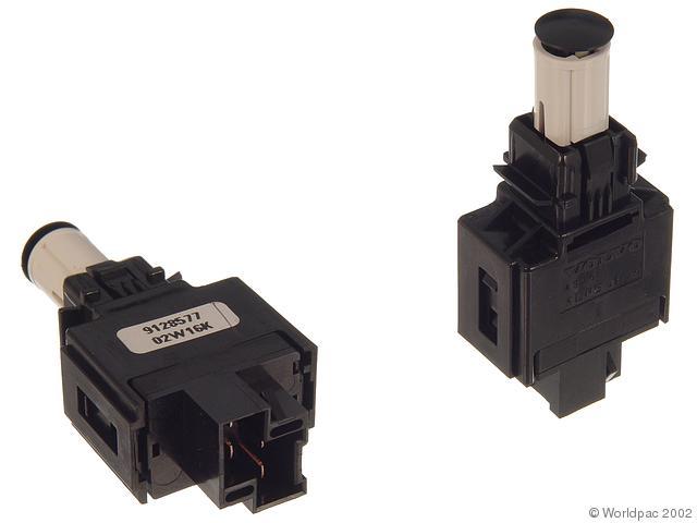

Is there any way of getting photos of what exactly you replaced and the bracket you had to bend?

Here is a picture of the switch:
Courtesy of FCP.
Courtesy of FCP.
Remove the knee bolster by removing the single Torx screw in the middle. You also have to disconnect the courtesy light to get the thing out of there.
It's all pretty simple from there. Look at your brake pedal and follow it up. You'll see the switch from the picture position in a way that lets the pedal hit that raised part of the switch when it retracts. The metal bracket is pretty obvious, and I was able to bend it a couple of degrees by pushing with my thumb, and my other hand as support. It's tough and cramped, but it's even easier to do with the switch removed.
However, as someone mentioned in this thread earlier, if your switch is original, it's probably pretty brittle. I broke a couple of the clips on my old one when I took it out. I'm not sure how I would have done it if I had to re-use that switch. But I get the feeling that there would be some JB Weld involved!
