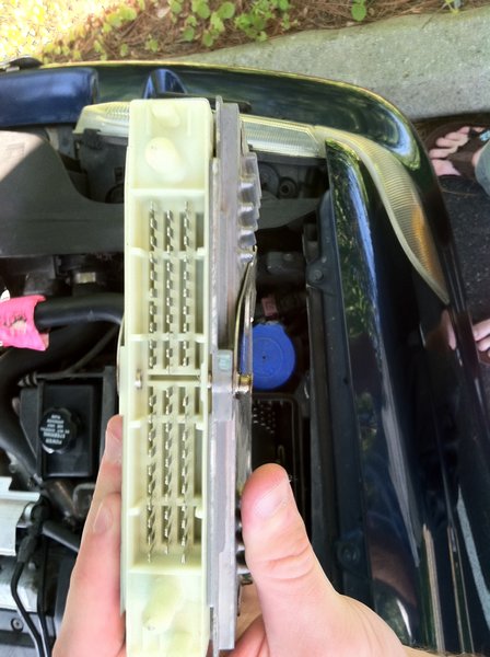

You could also try checking out the pins on your transmission controller if it's shorting or something - though I kinda doubt it's that. Mine looked brand-new.
