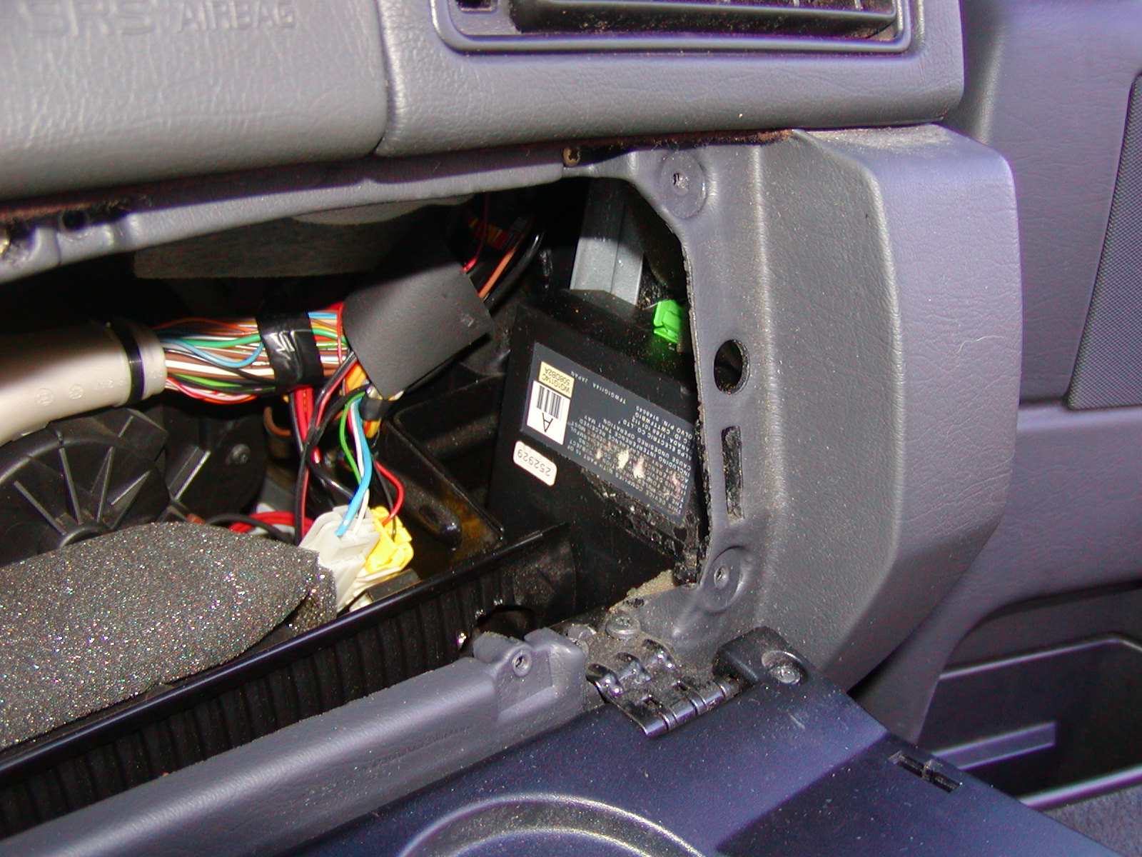

There is another part that is vital, the receiver unit. You may or may not have one. On a left hand drive car it is located on the A pillar, next to the glove box, I would assume that the right hand drive version has it in the same place as a mirror image.
Here is what it looks like:
If you do have the receiver then you need to get the part number off of it and match it (actually it is one part number off but chances are yours is the 3 series rather than the 9 series) to the remote.
If you don't have it then you need to scour the breakers and find a receiver that matches your remote. They interchange as a system between the old series and the new series but you cannot mix and match the components.
...Lee
