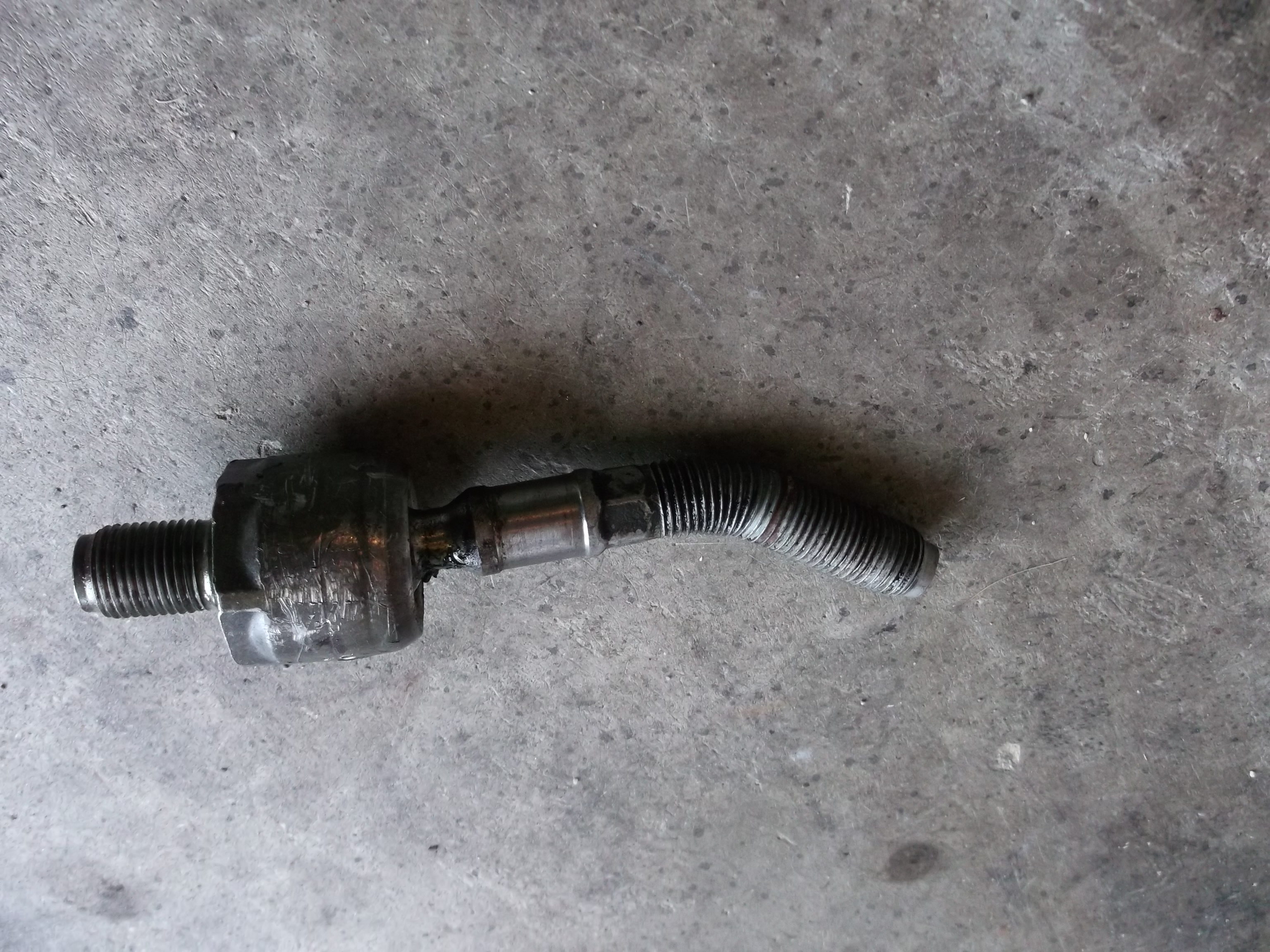

The inner tie rod end was easy to change. Take a look...
Passenger inner tie rod
