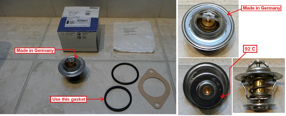

As mentioned in the beginning of this thread, many year ago, Volvo offered 88C, and 92C types.
Then they switched to 90C only, although you can go to rmeuropean dot com and buy the degrees you want.
I just did a search re 88C, 90C, 92C, and saw that Mahler recently offers 92C tstat: PN TX13-92D.
Has anyone here used this Mahle tstat?
PS: Just bought the Mahle tstat, will report back next week.

- Posts: 8360
- Joined: 31 Mar 2010, 09:54
- Location: Omaha NE
- Been thanked: 504 times
UPDATE:
- The Volvo OEM tstat (made by Wahler) was installed in July 2011, 5 years and 50K miles later, it is bad, cabin barely has any heat.
- Replaced with Mahle ($14 on line) 92C type. Heat is good again, even with today frigid temp of -10F!
The Mahle tstat is made in Germany.
- A few years ago, I used antiseize on the bolts, so removing is easy this time. So, always use antiseize on the bolts. You will thank yourself later.

- Posts: 8360
Cosmetically, the tstat looks good, no broken prongs, but I have replaced enough tstats in my life to know that old tstat can fail in 3 ways:erikv11 wrote:What went wrong with the old stat, did it break, can you see the problem? Just curious.
Of course the heat is good, your engine will always generate more than enough heat to overheat, even when it gets much cooler than -10.
1. Tstat shut off completely ---> engine overheats.
2. Broken prongs: it is always open ---> engine cannot warm up properly.
3. Cosmetic good look (no broken prong) but the wax mechanism fails, allowing the tstat to open too soon: engine cannot warm up properly.
- Temp gauge is usually on the cool side after a run, around 3:30 o'clock or so, this is a tip-off that the wax mechanism has failed.
- In other words, the new Wahler-Volvo tsat came from the factory as 90C, but with time, it may function as a 75C tstat.
Anyway, the new Mahle 92C tstat solved the issue.
