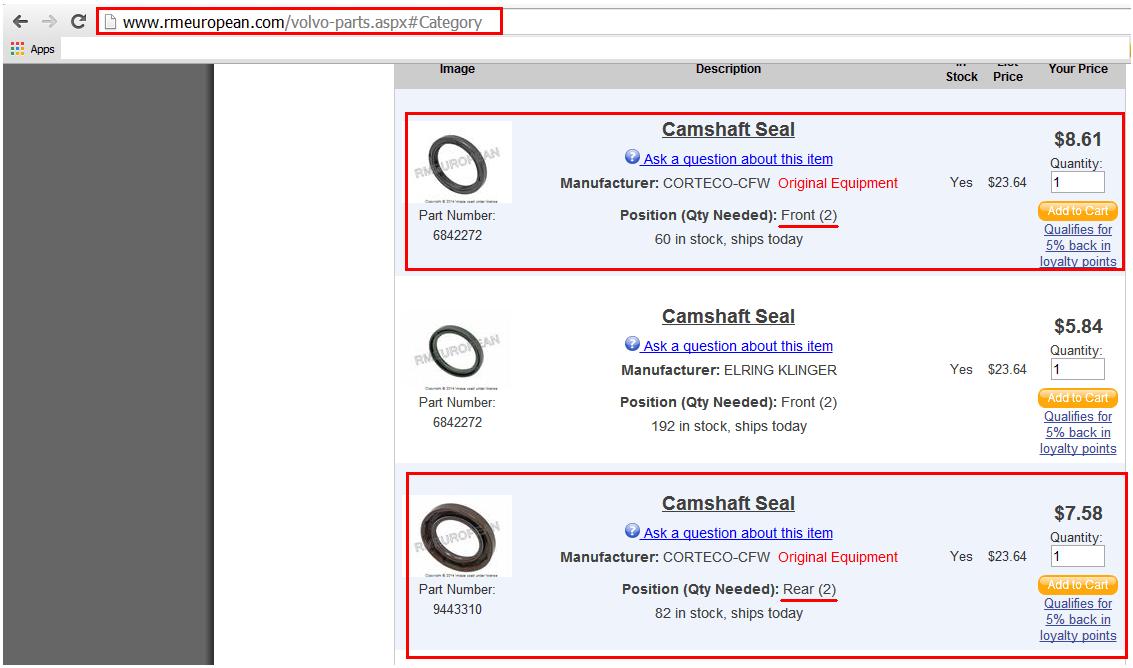

@phils94850, if no leak, leave it alone. Autozone stuff are hit-and-miss: I think their seals are OK.
The REAR cam seals are easy job, so no worry, worst-case scenario, do them again in a few years. No biggy.
The FRONT cam seals is another story!!!
Anyway, at the time of this writing (Nov 2014), rmeuropean carries Corteco seals for very good price. Corteco is one of the OEM supplier for BMW, Mercedes, Volvo etc.

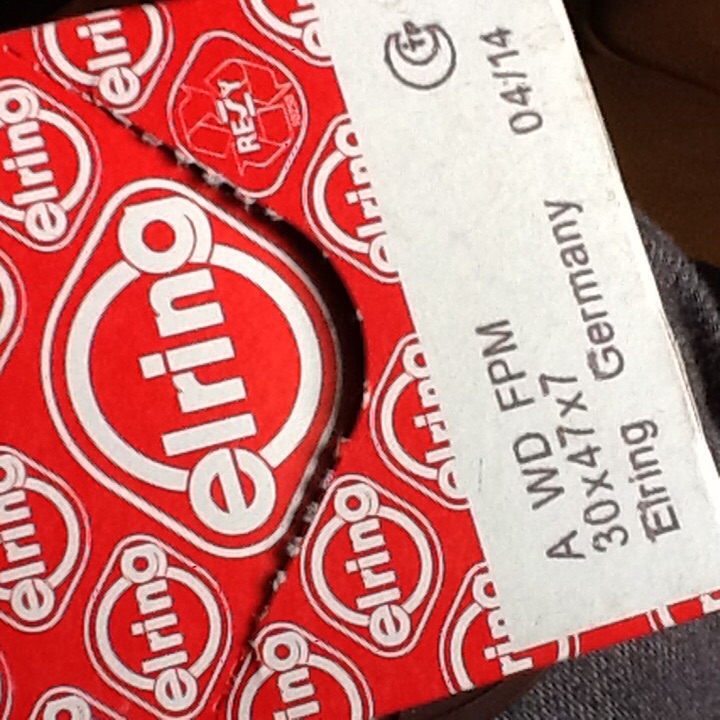

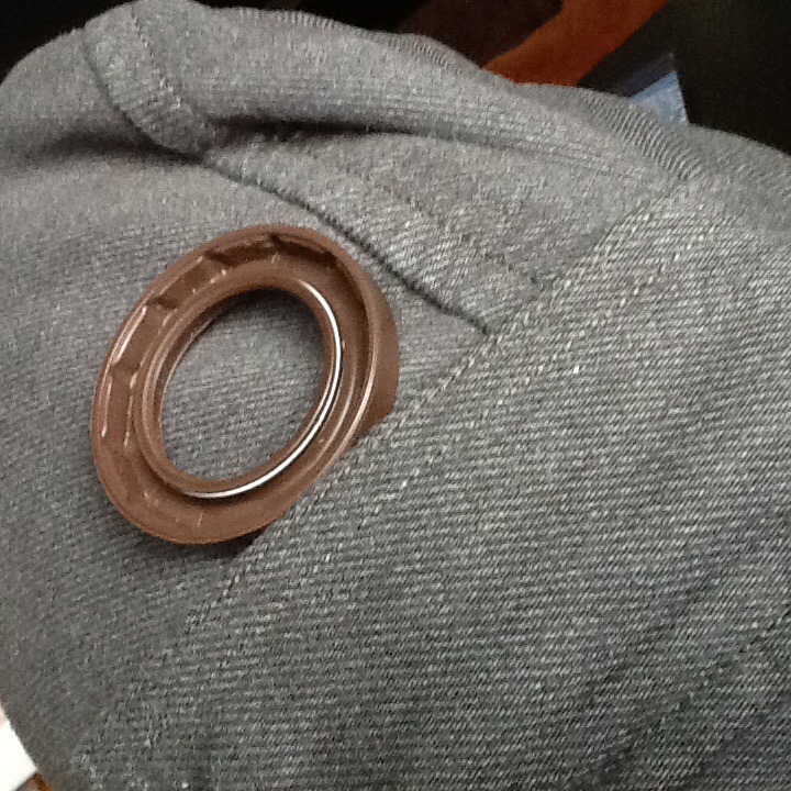

After reading this you will be scratching your head. I was getting ready to return some parts I didn't use when I came across the cam seals I purchased when I did my cap/rotor. There was no oil leaking so there was no need to change the cam seal. The local German parts supplier I use can only get Elring so I purchased it before I read this thread knocking them. I had a better look at the seal and low and behold it says: Corteco on it!
Has Elring been using Corteco seals all along, did they just switch due to problems or is that some kind of reference marking???

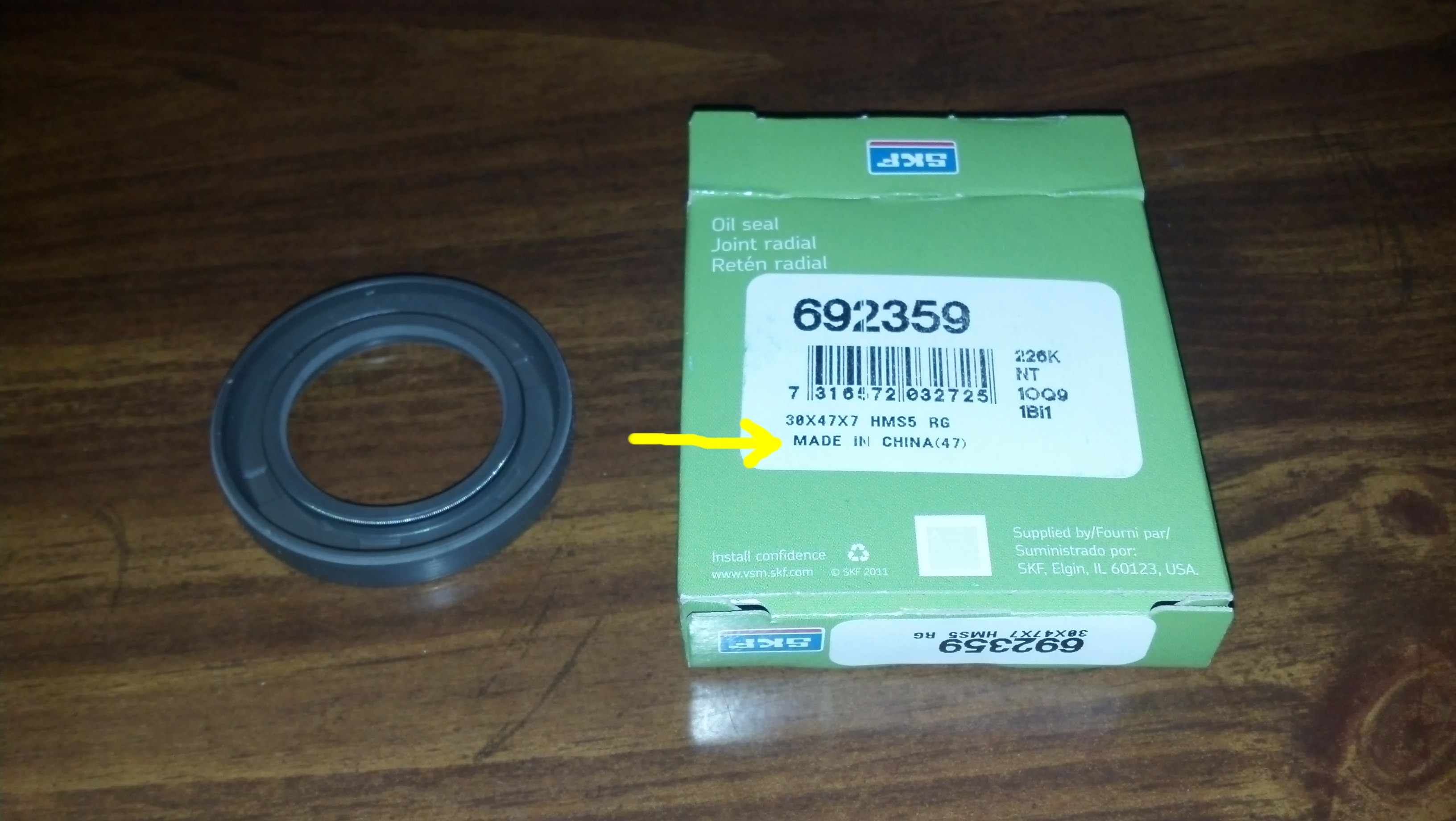

Contacted the local SKF distributor and gave them all of the info off of the box on page 1, to have them order me some seals. Went to pick up my order today and this is what I got... The end is near.
