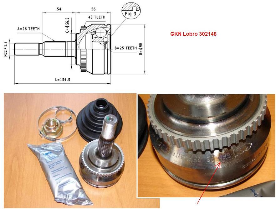

My 1998 V70 Automatic OUTER CV would be GKN Lobro PN 302148.

xHeart, the "GKN Lobro Kit" you find on the web includes ONLY the Rubber Boot + Grease + Clamp. The CV Joint itself is not in that kit.
As I mentioned above, the COMPLETE Kit (Rubber Boot + Grease + Clamp + CV Joint itself) is only available in Europe.
This is what you want to get, again very difficult to find in the US:
