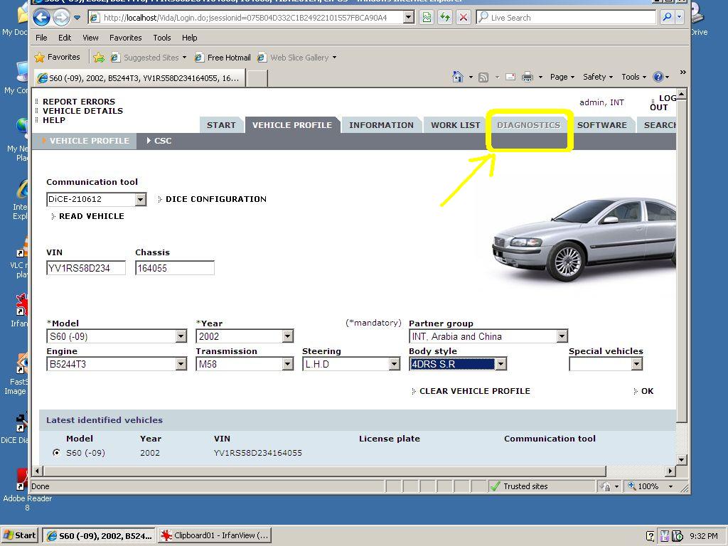

I get greyed out communication tab on my Vida install until transmission/engine is selected and I click OK.
Even with no Dice connected the above is true.
Pos II for ignition
Pos II for ignition
I don't seem getting any answer to my prayers! 3 weeks without my S60!
What am I missing?
What am I missing?

Sorry obvious question but are you clicking OK after selection?
Also choose Ame under Partner Group as stated in previous post?

Never had to do that with either of my Vida installations, but what the heck you've tried everything else!!jda2000 wrote:click the software tab first, then the diagnostics tab becomes available.
precopster, you were right again. I forgot totally the most obvious, to click OK !!
