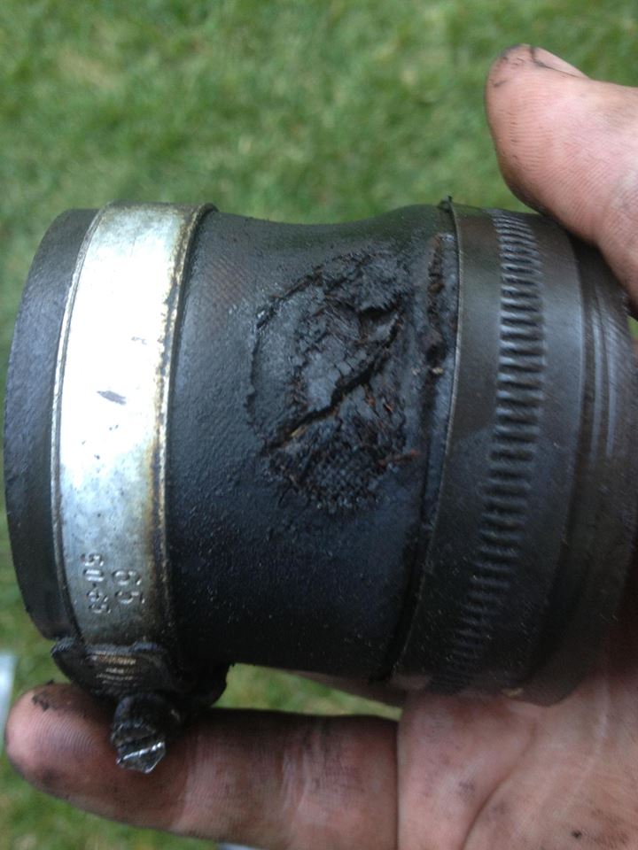

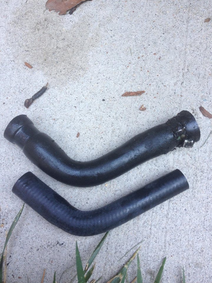

Also, it's worth looking at your vacuum lines/ TCV/CBV at the same time. The TCV's internal valves can wear out, and the CBV develops cracks in the rubber as well as a weak spring (less boost)... My car was slower than my girlfriend's '98 Jetta 2.0 for a while. When it began to leak coolant, I pulled the 16t off (dropped a CBV bolt in...stupid big, clumsy hands) and overhauled the whole turbo system with new hoses. What I found was pretty disturbing... These are from my mostly stock '98 S70 T5 around 217,000 miles.
Now, the car pulls like a train once more. In the process I ended up replacing every rubber hose under my hood, except the PCV which had been done about 20k prior by my brother (the PO) and I.
And while checking all this, make sure your heater hose coupler is intact. Mine came apart under boost on my way home from work one evening and gushed coolant everywhere; I had to get my car towed home. Those heater hoses are often overlooked, but can be just as deadly to our motors as any other cooling hose with the high volume of water passing through them.
