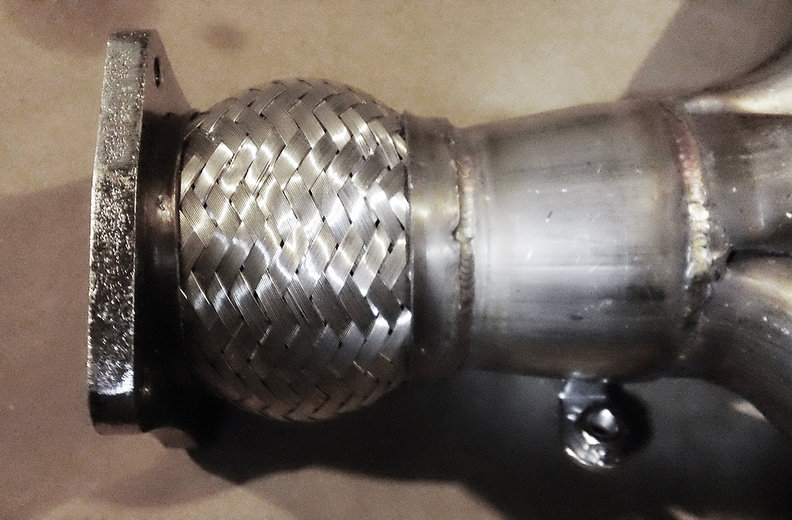

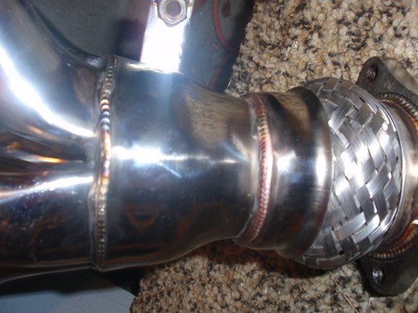

xHeart wrote:A side-by-side visual of two manifold for area around the flex...any comments?
DNA Motoring
Estonian variation
The first part is by far of better quality. It also seems to be in inox. It has very good welding.
The cuts on the second part look really poorly done which can be a good indicator of the general quality. The welding seem acceptable. It also seems to be regular steel going to rust everywhere. Even then, a cheap part might be worth if it lasts a few years, but this one looks so poorly manufactured, I won't buy it.

I will update on how Estonian manifold performs, meanwhile, we know for certain our bigdaddylee is running on the DNA Motoring's manifold for few years without change of heart, I guess.

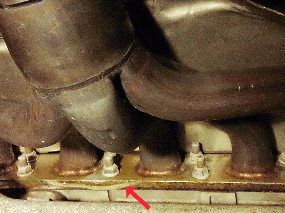

A view from below two weeks after the install of Estonian Variation. It appeared wet so I ran my finger, the red arrow points to the skid of my finger. Is it normal, or does it need tightening?
