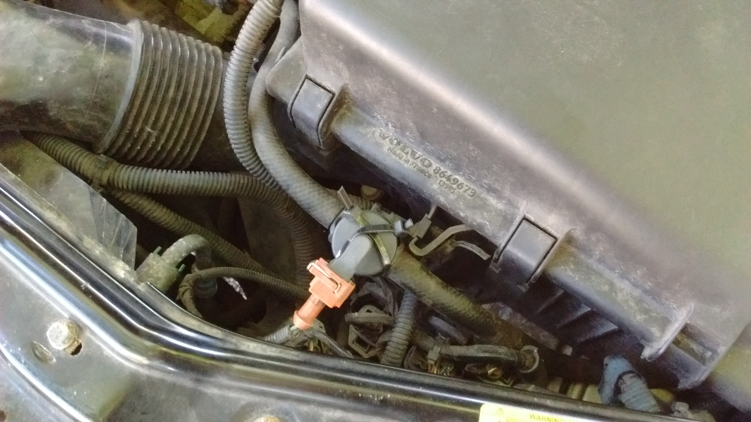

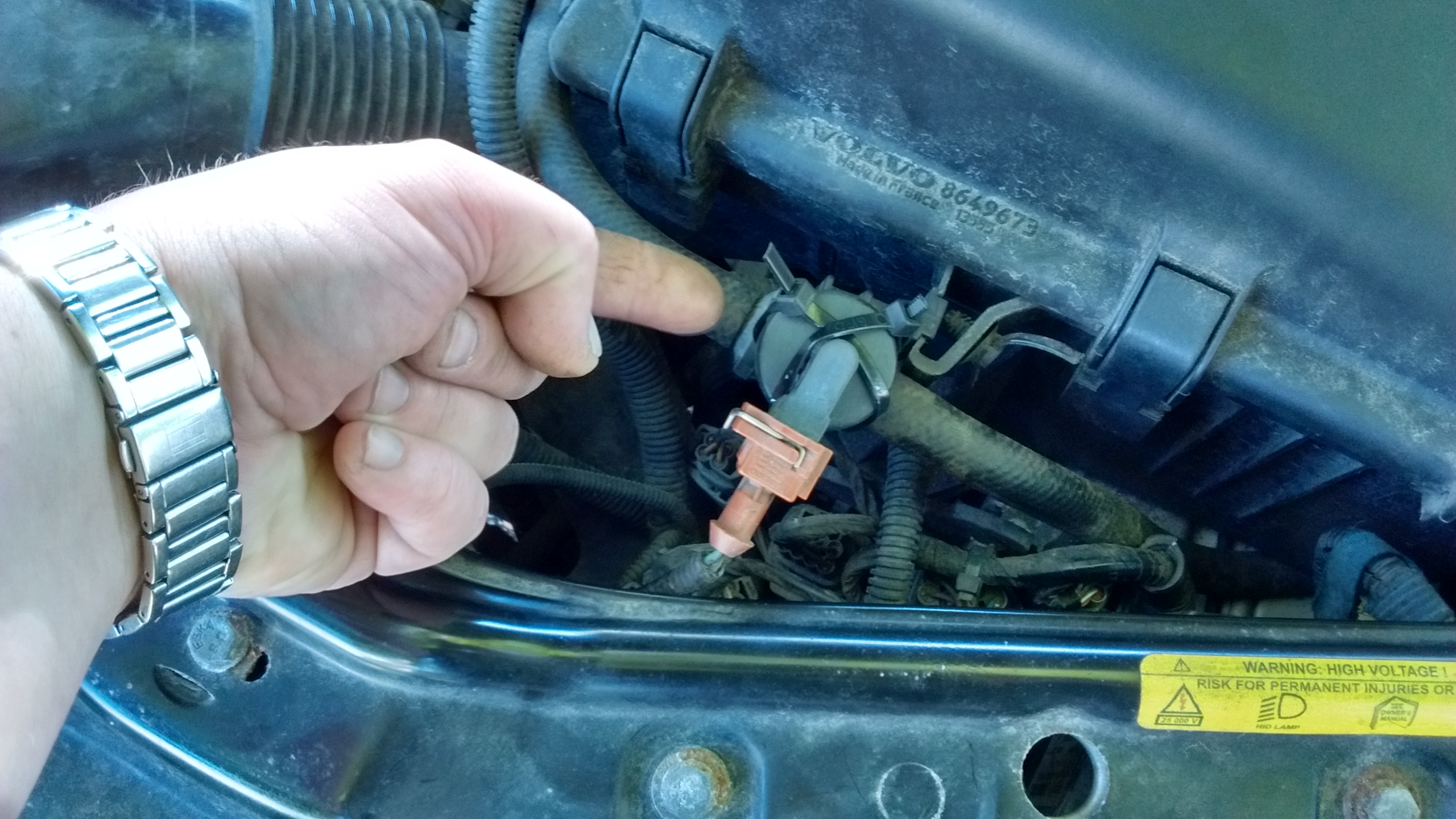

Does anybody know what Volvo calls this part I'm pointing to in the pic?
It's between l/F headlight and airbox on our 2004 Volvo XC70. A part number would work since I can't really see the part # on one in pic. Ever since my latex gloves snagged this thing we've had an issue. I found the spring that flew out of it then pieced it back together which in turn worked. She's been running without issue until this morning when the wife took our son to school. Sorry for long post and I'd really appreciate any suggestions/help on this. BTW the DTC is P2111 throttle actuator is stuck open/closed, the code in one stated it was stuck open originally, now it says stuck closed too.

I think that is the brake vacuum booster - it makes sure you have power brakes even when the engine is under low vacuum conditions.

It's the switch for the vacuum pump, they break all the time and if not replaced ASAP it will leave the pump on all the time and fry it

Thank you sir for your reply.JRL wrote:It's the switch for the vacuum pump, they break all the time and if not replaced ASAP it will leave the pump on all the time and fry it
Now correct if I'm wrong but doesn't the vacuum lines from this open/close switch run to the I/M and T/B?
That being said then that would explain my brief issue w/throttle...immediately after my glove snagged the top of the switch off the spring popped out without my knowledge. Right after I put top of switch back on using pull tie to help keep the top on since I broke a tab off. I started her up and the issue was present. I go back under the hood to check the switch and spot the spring on the ground in front of the car. I knew at this point it had to go inside this switch cause it was the perfect diameter to fit inside the opening with the top of the switch pulled apart. I replaced the spring then used 2 pull-ties to hold everything inside this switch and at this point restart the car without issues.
