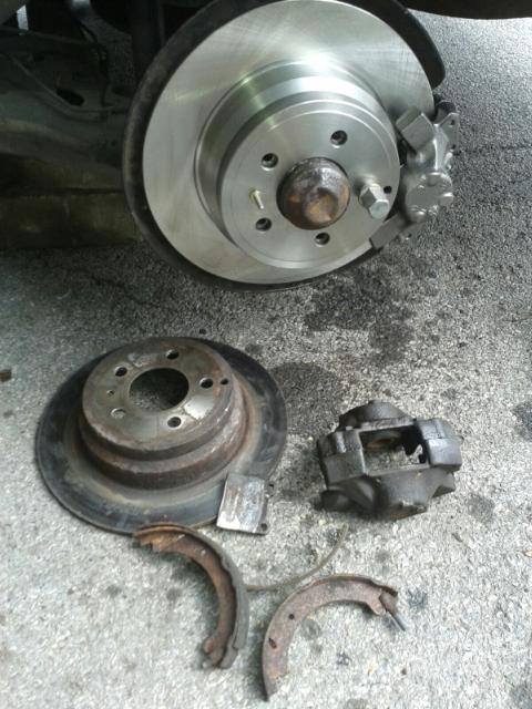

....so to conclude, finally (hate leaving a thing un-done)
Ended up just replacing the rear left caliper that had the broken off bleeder rather than try to extract. Turns out that one of the pistons in it was frozen anyway. So....good.
....and since i replaced it of course i replaced the rotor/pads
.....and since I did that side.....of course I did the right rear caliper/rotor/pads too.
Ebrake had virtually disintegrated on left side.
So ended up with basically a brake overhaul.....that's what credit cards are for .....right?

- shur are pertty
- 20140911_115535.jpg (59.06 KiB) Viewed 1072 times

Important note....truck put a wheel bolt into the rear rotor to make sure it was flat and true before adjusting that parking brake. This is important!

Those new rear brakes look gorgeous!

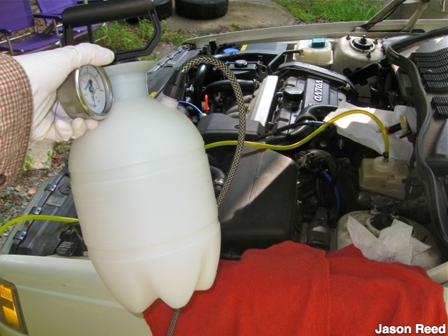

I built a power bleeder using a sprayer from Home Depot or Lowes plus a brake reservoir cap for a Volvo 240. I think it cost about $10 for the sprayer and about $5 for the cap. You need a couple fittings, clamps and hose to connect it up. It works pretty well for a home-made unit.
