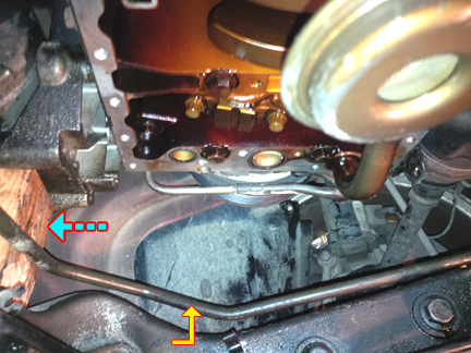

Update:
Before anything let me add a few pointers on removing and replacing the oil pan. I know its been covered on this site but these two points were key got getting it off and back on:
1. Drive the vehicles onto ramps and remove the two 19mm bolts securing front motor mount to frame. Use jack to raise engine. (i used a 4" long piece of 2x3 and placed it under the AC Compressor.
2. To create extra room, remove power steering line clamp from frame then move it up and away from its retainer.
As for the issue.
I used my air compressor to blow crud from the vent hole inside oil pan, replaced seals on pan and closed it up. (Added new oil and filter).
Made sure all hoses, trap and vent holes on engine were cleaned and that there were no oil leaks.
Put everything back together and fired her up.
The engine ran much better so i took it for a spin and monitored some data.
After 5 minutes engine went from CL to CL-FAULT and remain that way, however fuel trims remain normal (SF -2.3) (LT 6.3) I also notice a little smoke coming out of the oil cap and dip stick. is this normal for this engine?
It also has a P0420 pending.
Will drive on hwy tomorrow and will post some more numbers.

- pan.jpg (133 KiB) Viewed 1711 times
- jack.jpg (136.42 KiB) Viewed 1711 times
