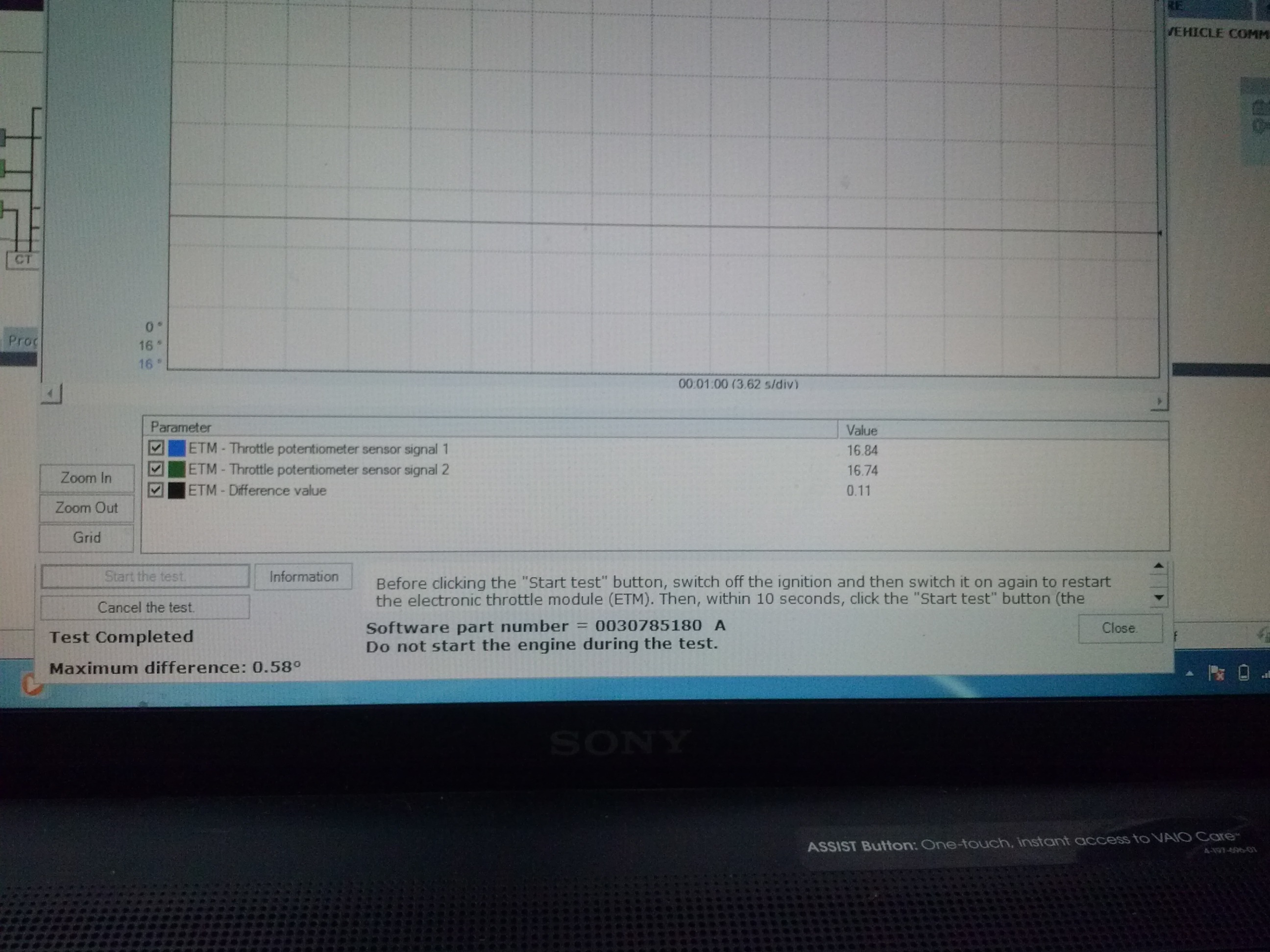

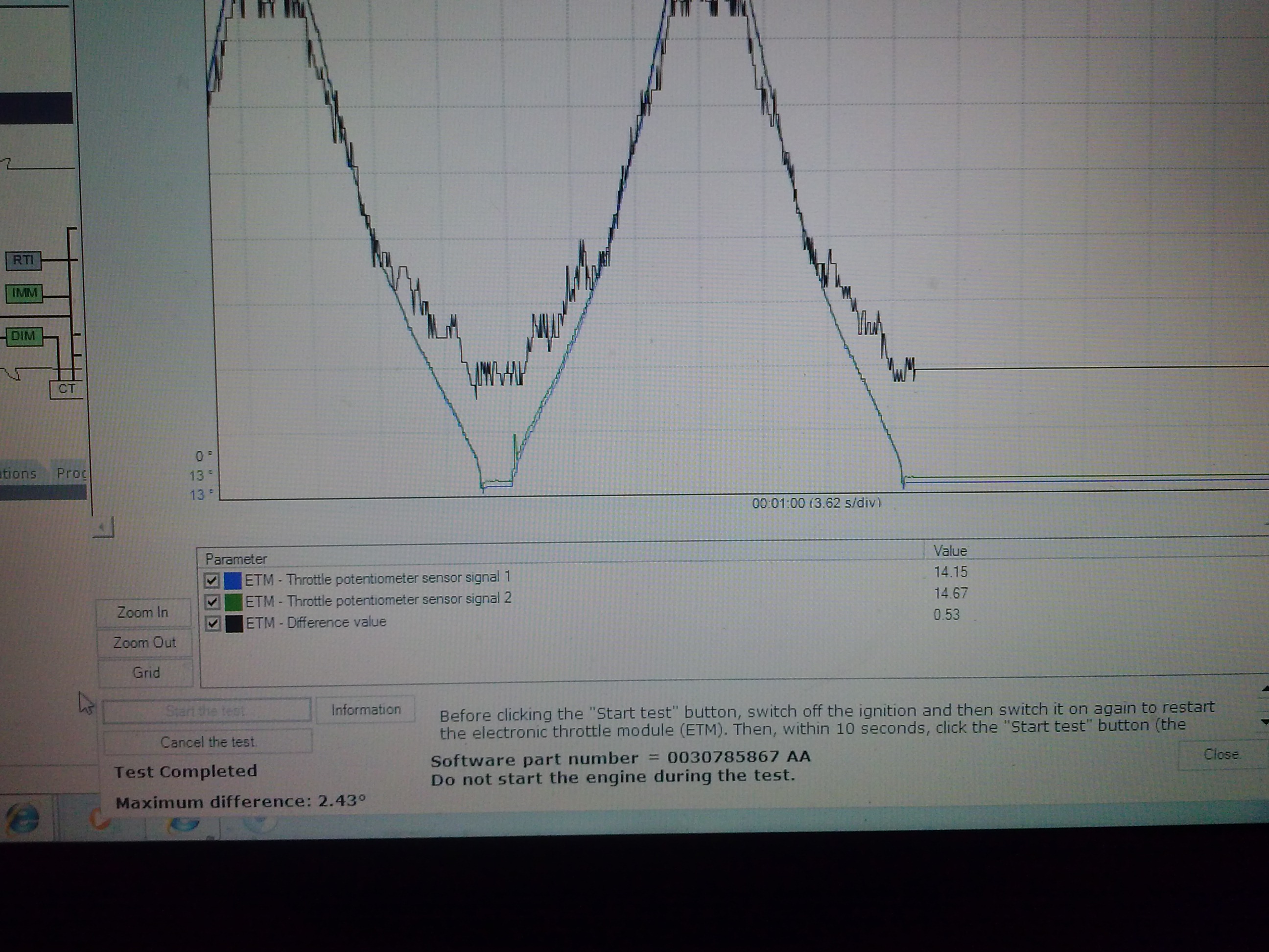

Throttle should stay open by about 12 degrees at all times. It only opens to between 18 and 24 degrees and then closes to the 12 degree mark after the self test.
From what you describe you have a match.

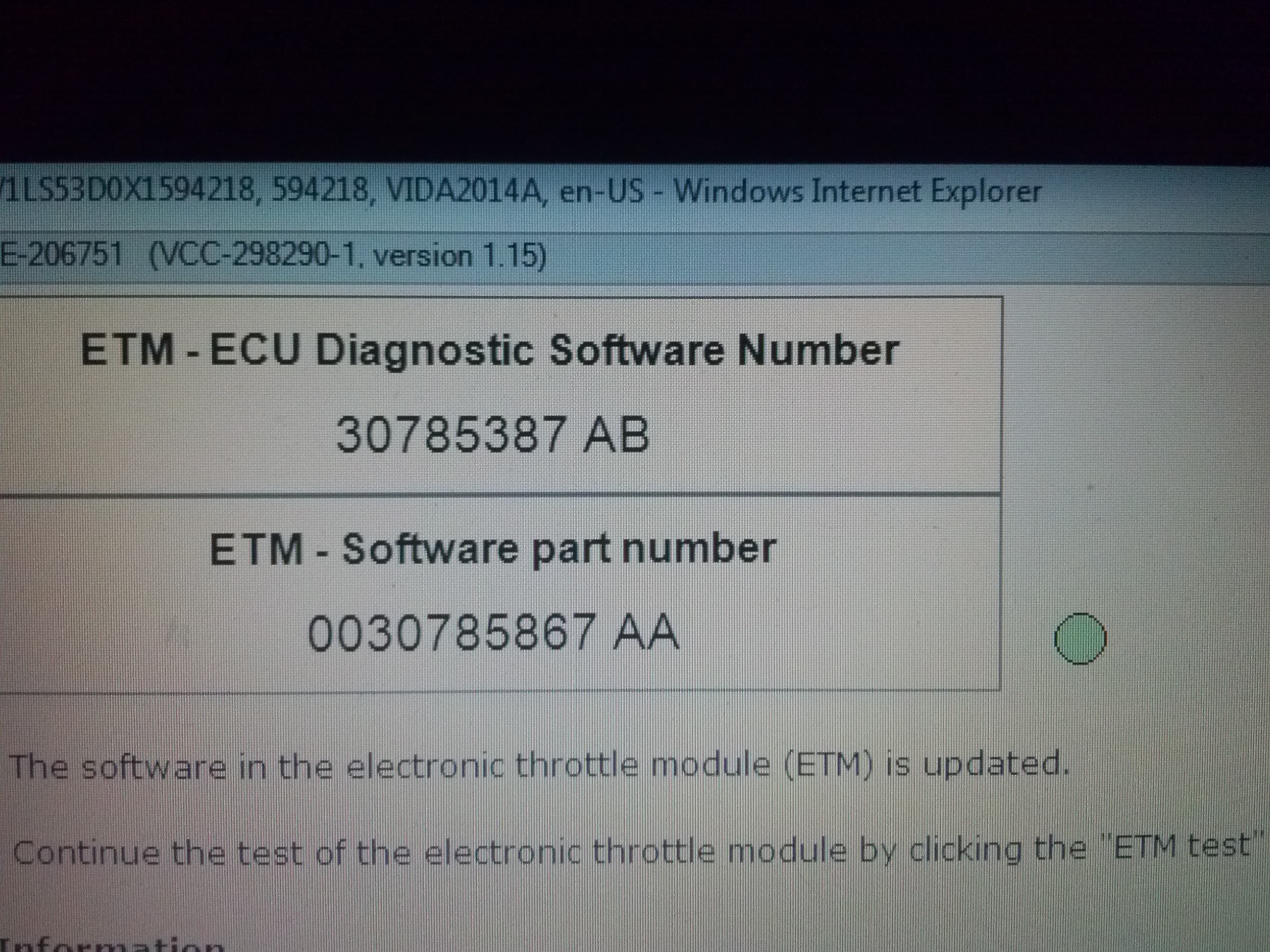

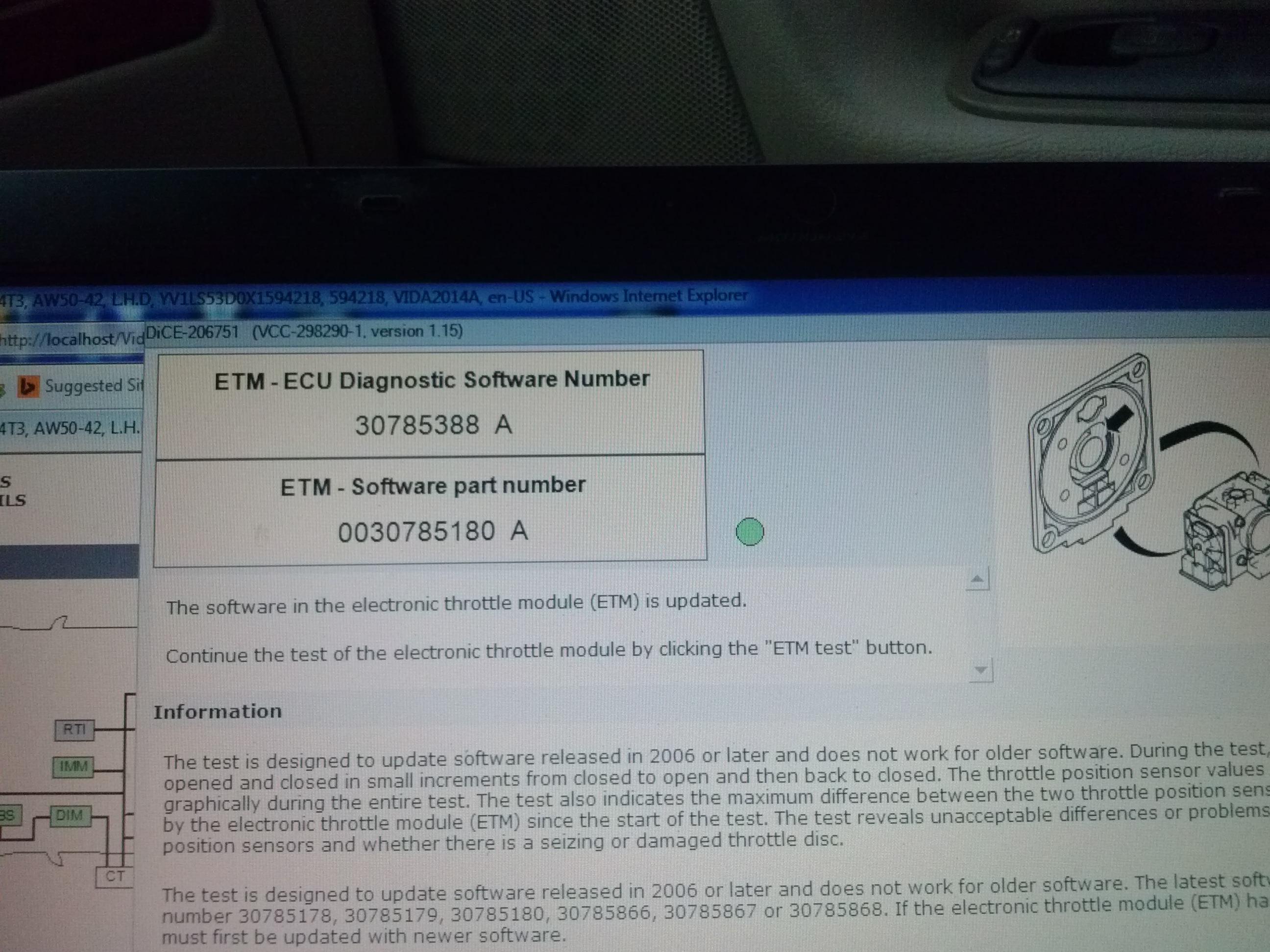

Got some software numbers off of both ETMs and they vary but when scanning for faulty codes, I didn't receive any ones specific for that. I also couldn't resist but to start the engine with the new ETM plugged in while sitting on top of the air cleaner box and the old one still installed. To my surprise the car started and ran rough (self explanatory) with me tapping on the accelerator pedal. It was still responding to my feedback although not anywhere near crisp and it couldn't idle. I can't wait to find some time to remove the old one and install this new unit!
Is there a way to know which model and engine size this new ETM came from just by the software numbers?

Some ECM (engine control modules) can accomodate two or more different ETM software versions. This was the case with my 2001 XC70 which first had early firmware (pre 2006) and then received a later one without touching the engine control version. The firmware you have there on the new one is one of the later versions.
Any ETM will respond to pedal input. You really need to road test it.
