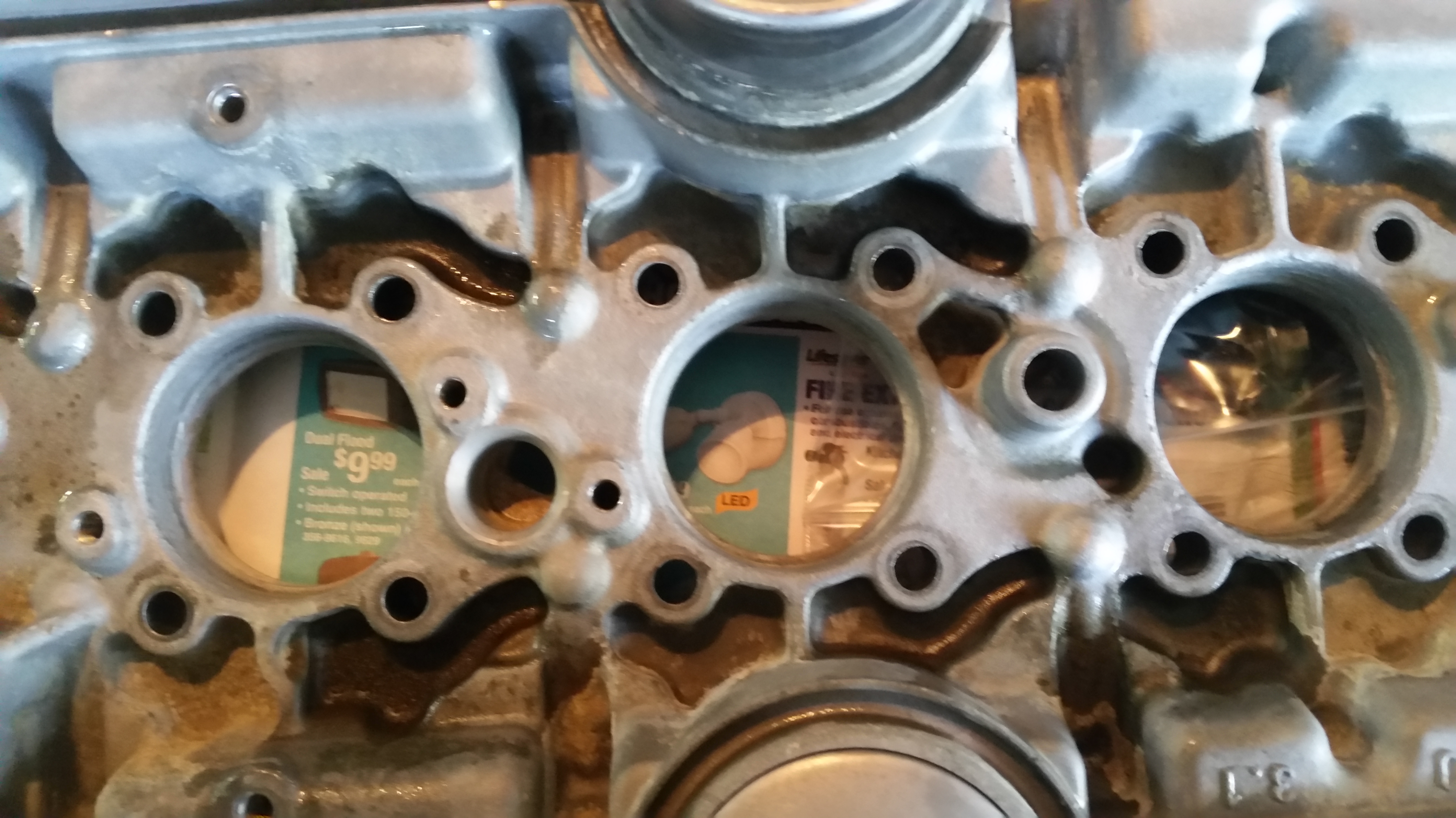

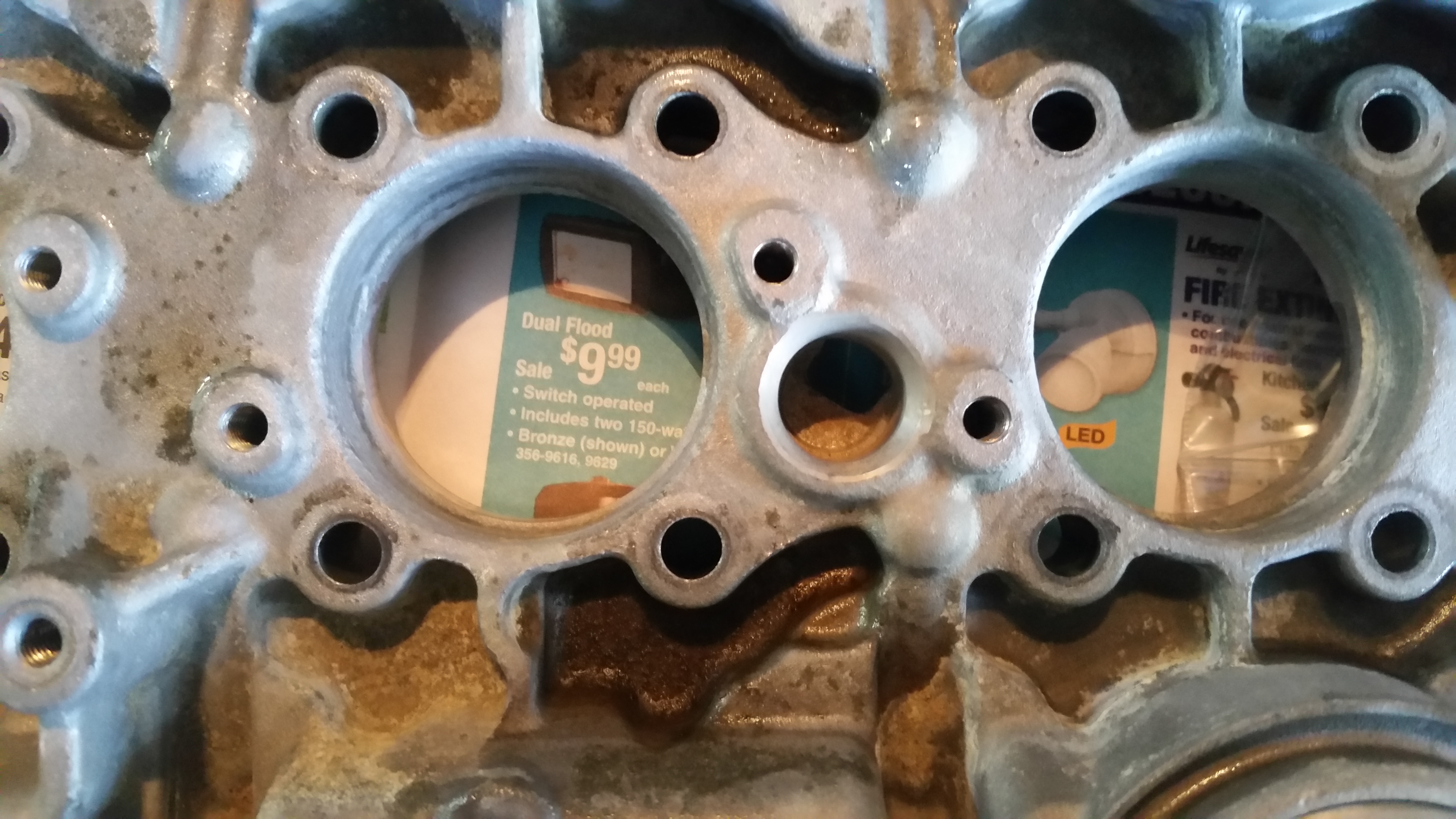

my turbo oil O-ring plan.....hum I'm getting a gallon of kerosene tomorrow and filling the oil pan full. Let it sit for a day and hope with finger crossed that it will be within reach when i drain the pan. I HOPE!.
My next issues is I don't remember removing anything from this opening? The shop did it I think?
