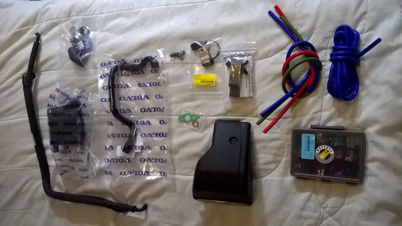

Surprisingly, the IPD shipment came in this morning! It included the PCV kit, iPd's HDTCV and mounting kit, TCV silicone lines, 10 feet of silicone vac line, the turbo drain pipe seal kit, a new throttle body cover, and some fuses for good measure ^^
Work schedule is in the way at the moment but I should be able to get to it either Tuesday next week or the next Sunday!
