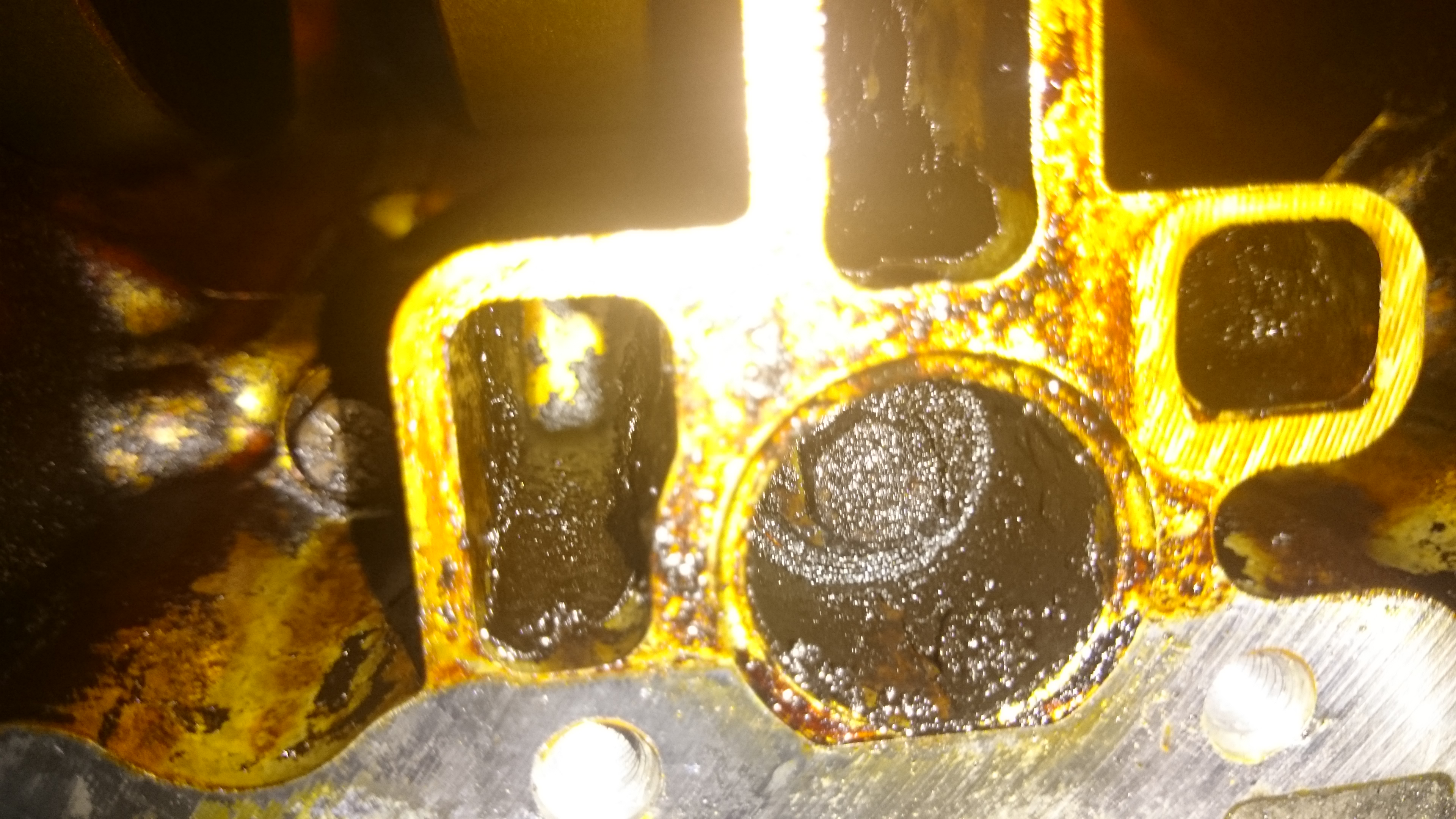

I would call that relatively light sludge, not too bad. Clean it out of course. I'll try to find you a picture of my 1.8 turbo VW pan. You can find heavy sludge pictures on the. Inter webs

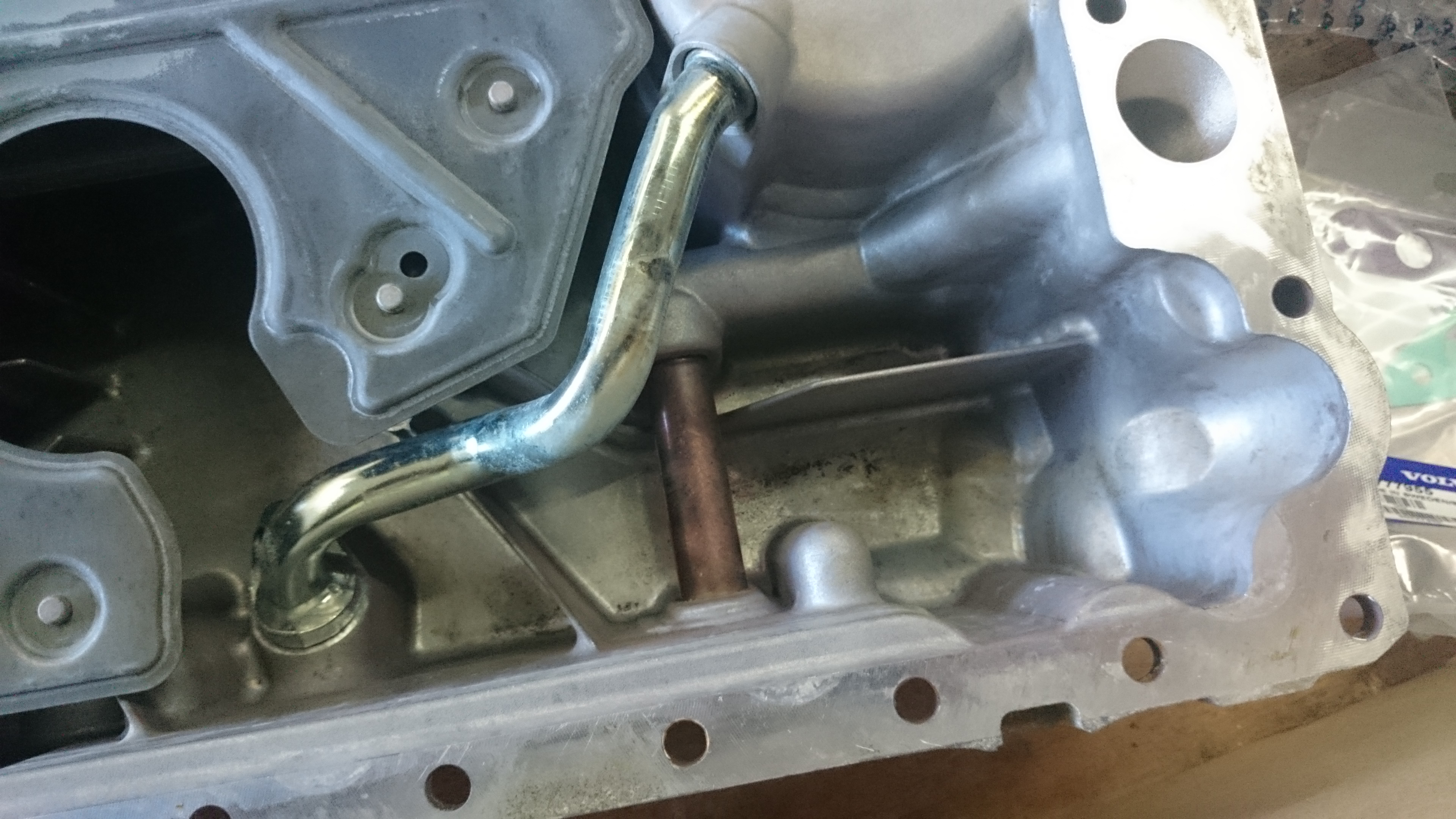

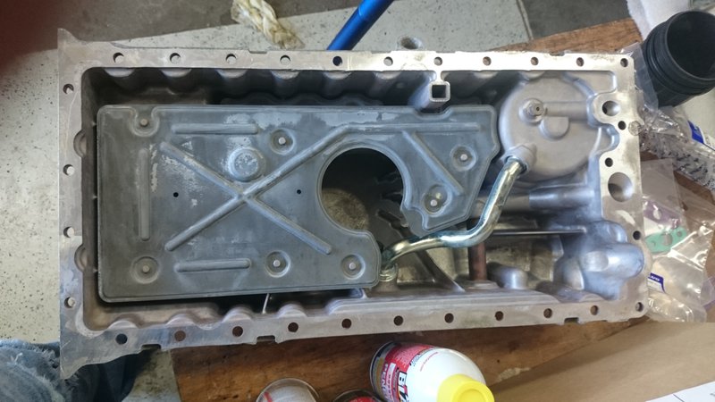

Well here's an update on my situation:
O-rings have been replaced, new 06 style sump has been installed, oil pan has been cleaned in hot bath, crud in engine has been scrapped off, and oil pan received a gasket at install.
After all that, I put in rotella 10w30 synthetic blend. Had the car running at idle for 20-30 minutes with no warning lights coming on. Feeling good about this I took it for a drive. The first half I was taking it easy and things were good, but on my way back I pushed the car a little bit by giving er the beans and flying around corners. About a mile from the shop, the light came on again. After about 10minutes and 10 miles of driving it popped back on.

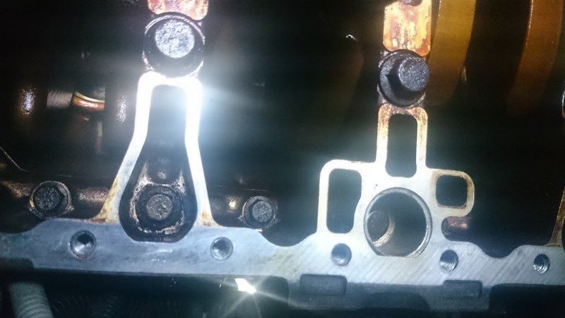

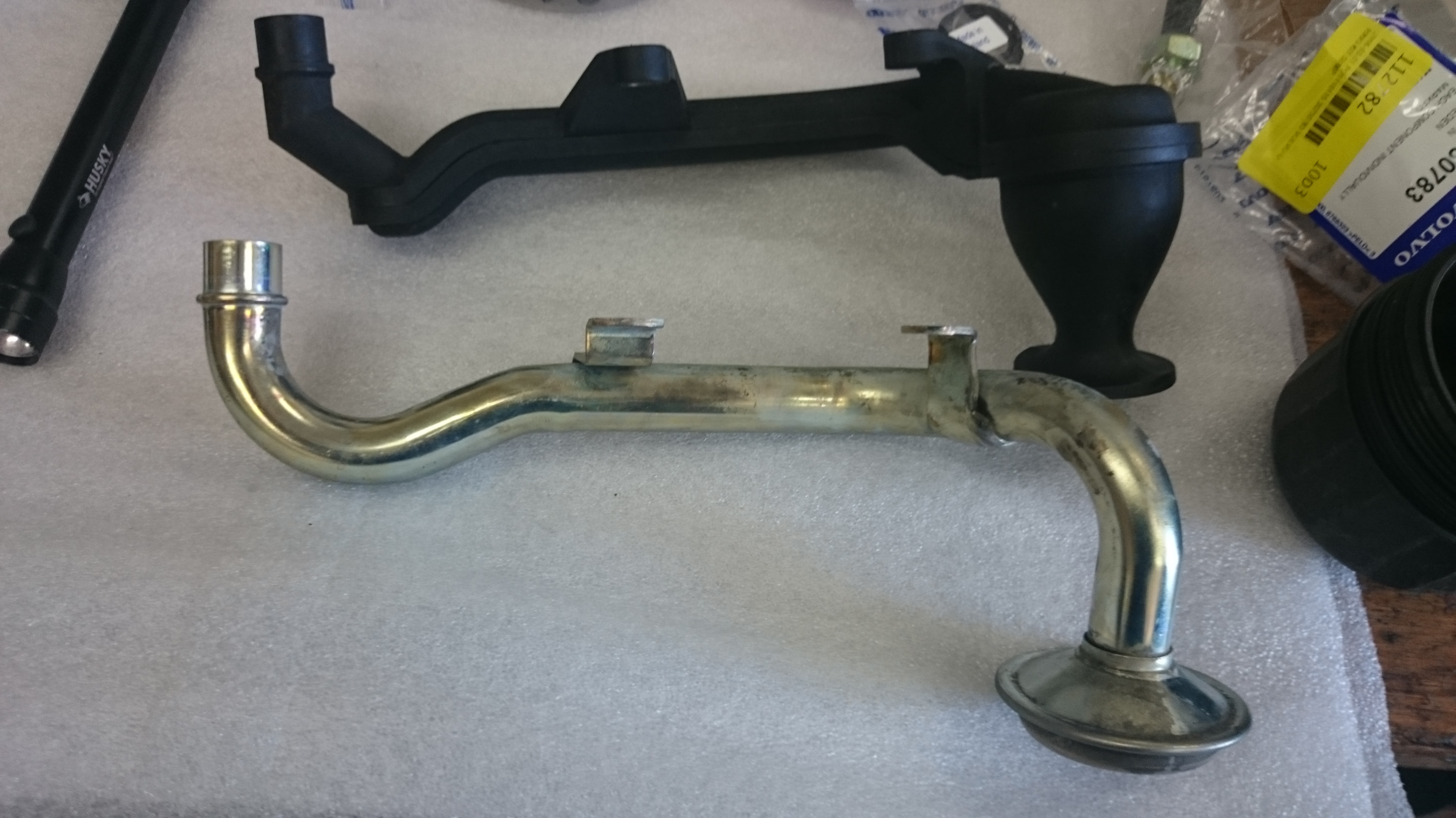

Here's some pics to look at:

Did you check the rod bearings for play when the pan was off? First thing to do once the pan is off for pcv/sludge cleaning/low oil pressure.
