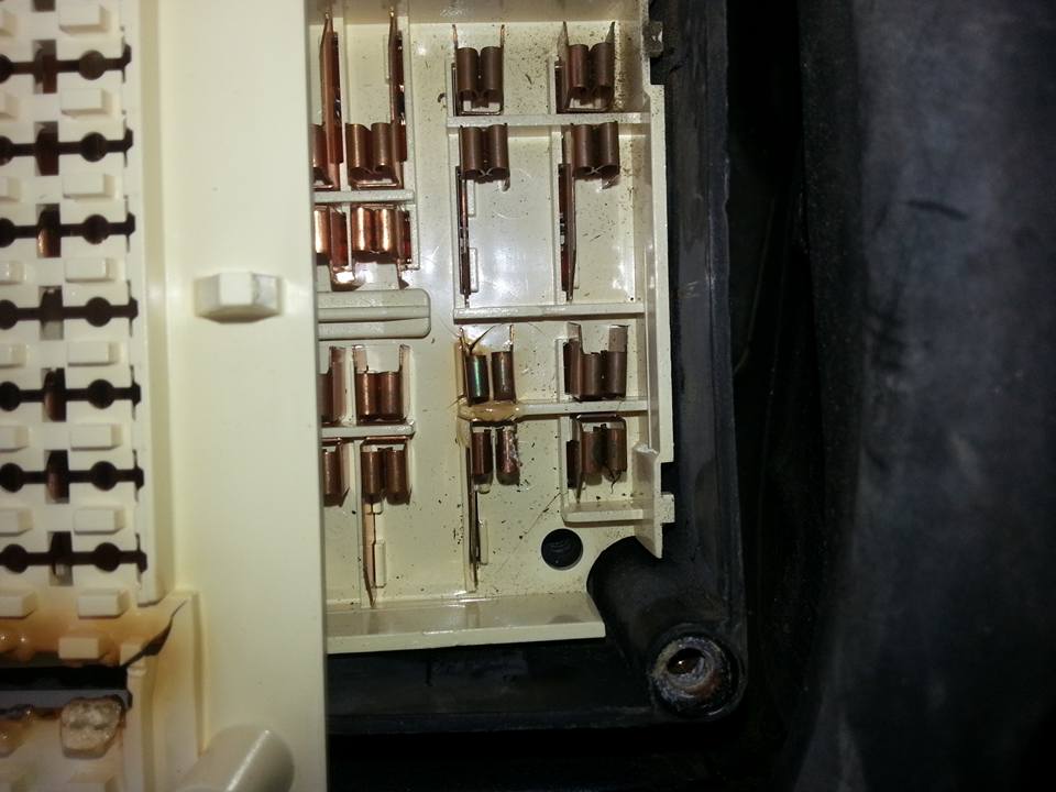

A long holiday weekend and 2 days of rain have slowed down my circuit breaker work! But I'm back on it now.
This is what was under the melted fuse box. It doesn't look like much, but if you zoom in, the slot second from the right is melted too.

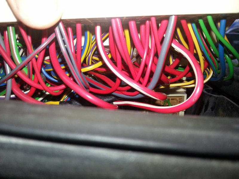

THIS is what was under the previous picture. That's a Lot of wires!
