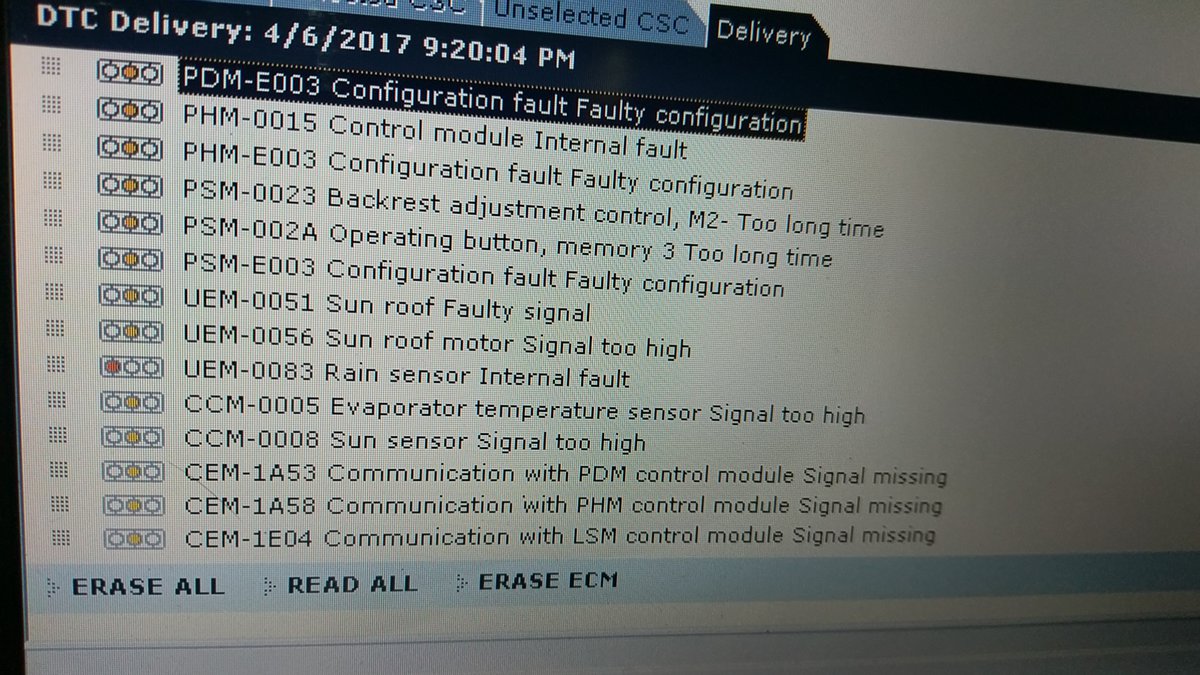

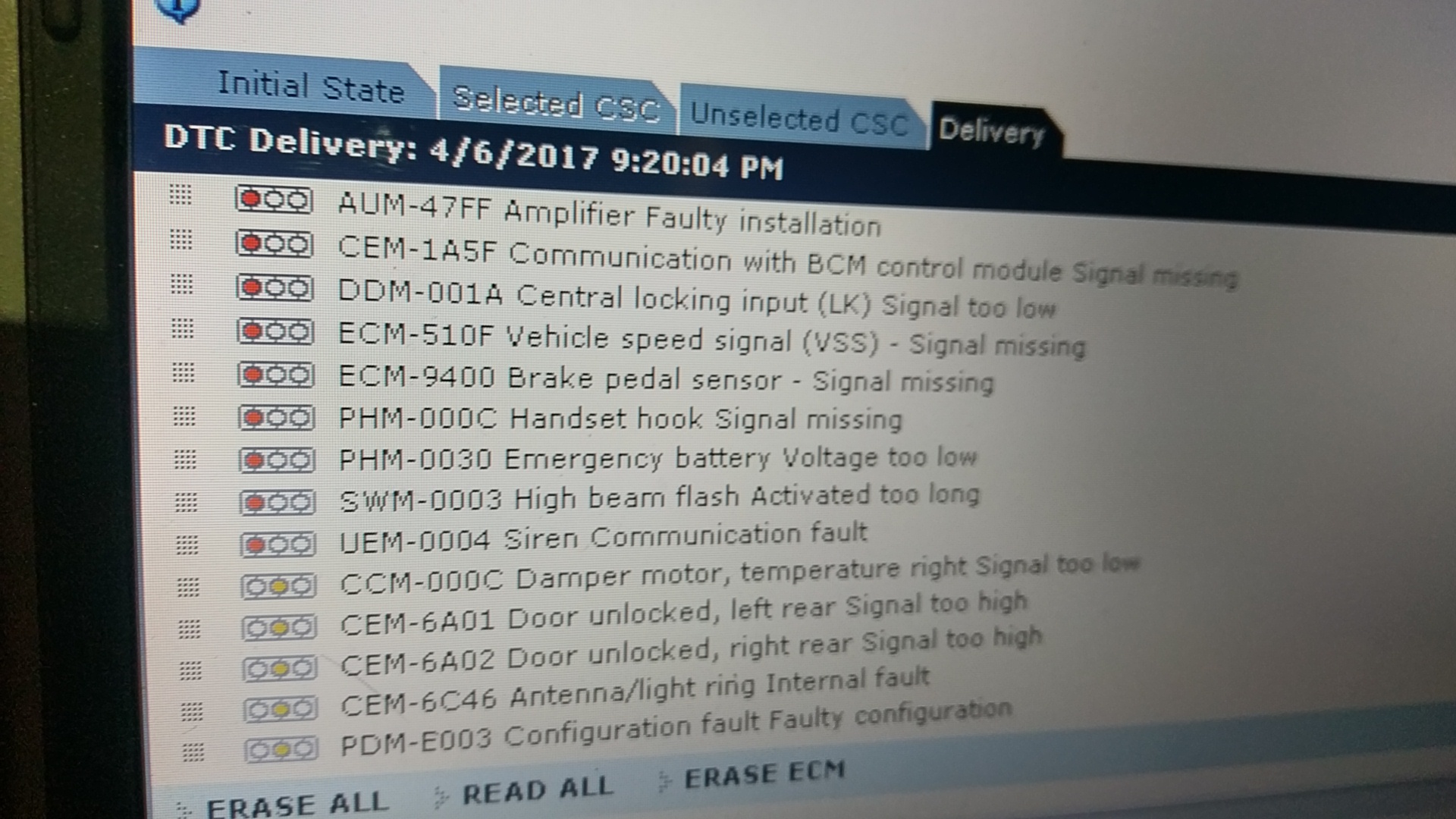

It was wonderful to drive in this morning with absolutely NO DTC errors in the DIM text window and no annoying Yellow Triangle of Annoyance burning it's ! into my retinas!!
Thanks to all that helped me get Sven to this point, but especially to Sergey (Yagger)!! That man is a wizard and within an hour on 2 different occasions he's cleared errors that I am sure dealers would have balked at unless approved to spend multi-thousands of dollars!! He programmed the BCM last week and last night he deleted the PHM module. All this over a VPN and Skype! Amazing! Keep him in mind before you head to the dealer as he is way cheaper and far less snotty!!
In the span of just a few weeks and a couple of well spent $$, Sven went from this.... to nothing except the Amp error and I have a new one of those coming this week!
First VIDA read...
First VIDA read...

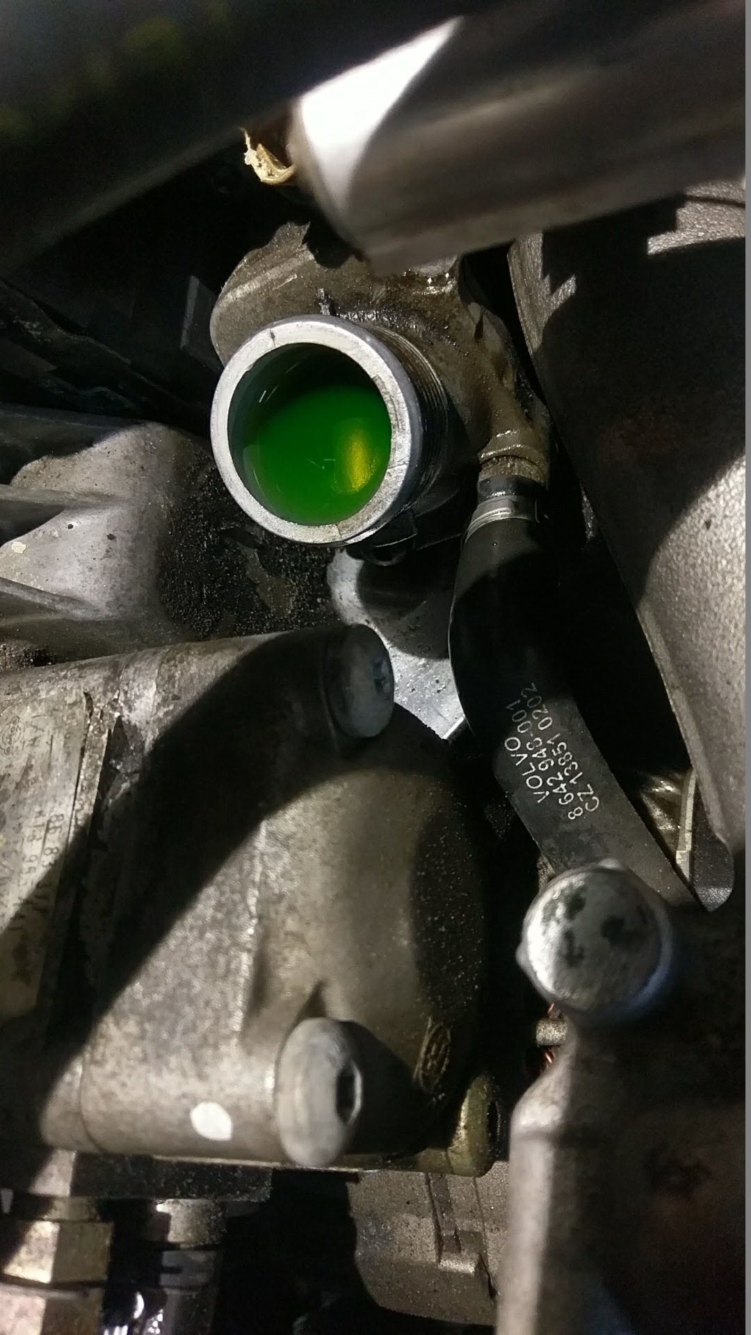

Hmmmmm Think this one is bad??

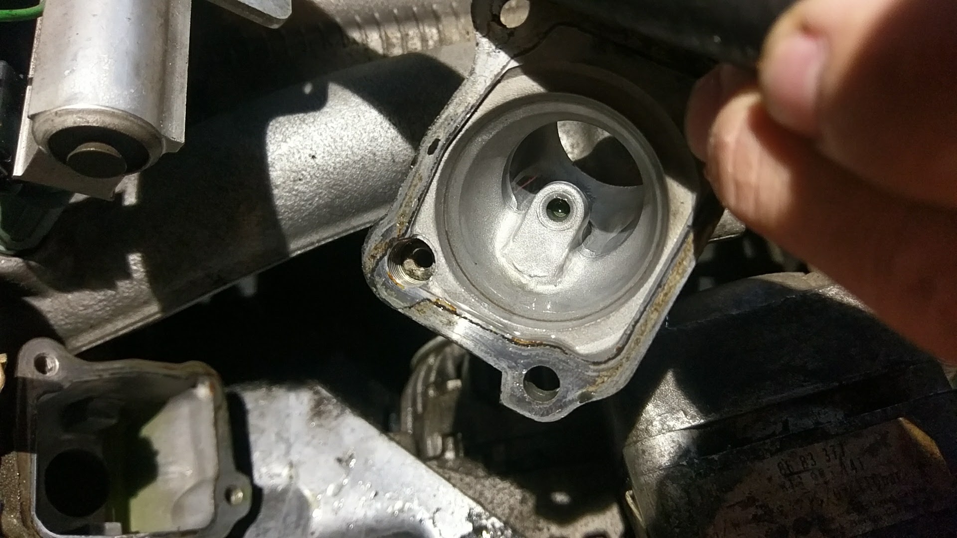

Not that it was a surprise, but it just annoys me that such a simple a repair as replacing a hose caused not only the damage here, but also the sub-frame bushings to congeal. I guess I shouldn't complain too much as that's probably what allowed me to pick Sven up for $600!!! I'm in for a bit of elbow grease.. which is cheap in my book!

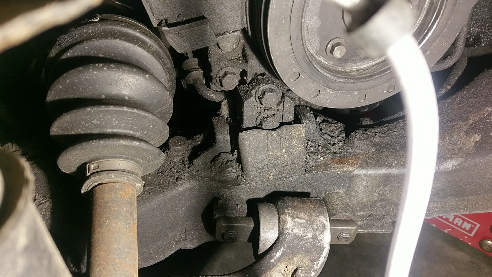

The one that surprised me though was after picking up the kiddo from school the other evening. On the way back home, after sitting in the Pick-Up in the school lot for 30 minutes of Stop-n-Go, I got the "low coolant" warning. Checked it and sure enough it's low... not pouring out the car but dripping... hopefully enough to get home! I made it..... barely!!
Looking at car it was leaking from somewhere on pass side of the car. Nothing coming from the coolant tank.... nothing leaking from the hoses.... no rad leaks... WTF!!! Where is it coming from? I narrowed it down to the front of the motor... somewhere up under the intake?!?! It was dripping down the oil filter housing so I started searching straight up from there. I start poking around up top and found my AH HA! location... how did I know? It was the cleanest spot on the entire motor!!! See for yourself!
Took a bit of disassembly to find this one though!
So come to find out that particular gasket is actually Unobtanium!!! You can get it WITH the assembly but even Volvo doesn't sell it alone. So, desperately late on a Tuesday evening, I set about making a gasket for my T-Stat! While in there, I found out why it leaked. At some point someone tightened it down so badly that it pushed the rubber/metal gasket out, leaving only a fraction of an inch to seal... How hard do you have to try and screw up a seal with a METAL FRAME GASKET?!?!?!?
Bet you can't tell where it was leaking from!!
So I made a gasket and with a little help from PermaTex, got it to seal up nicely! Been a few days now and nary a drop of the green is to be found!

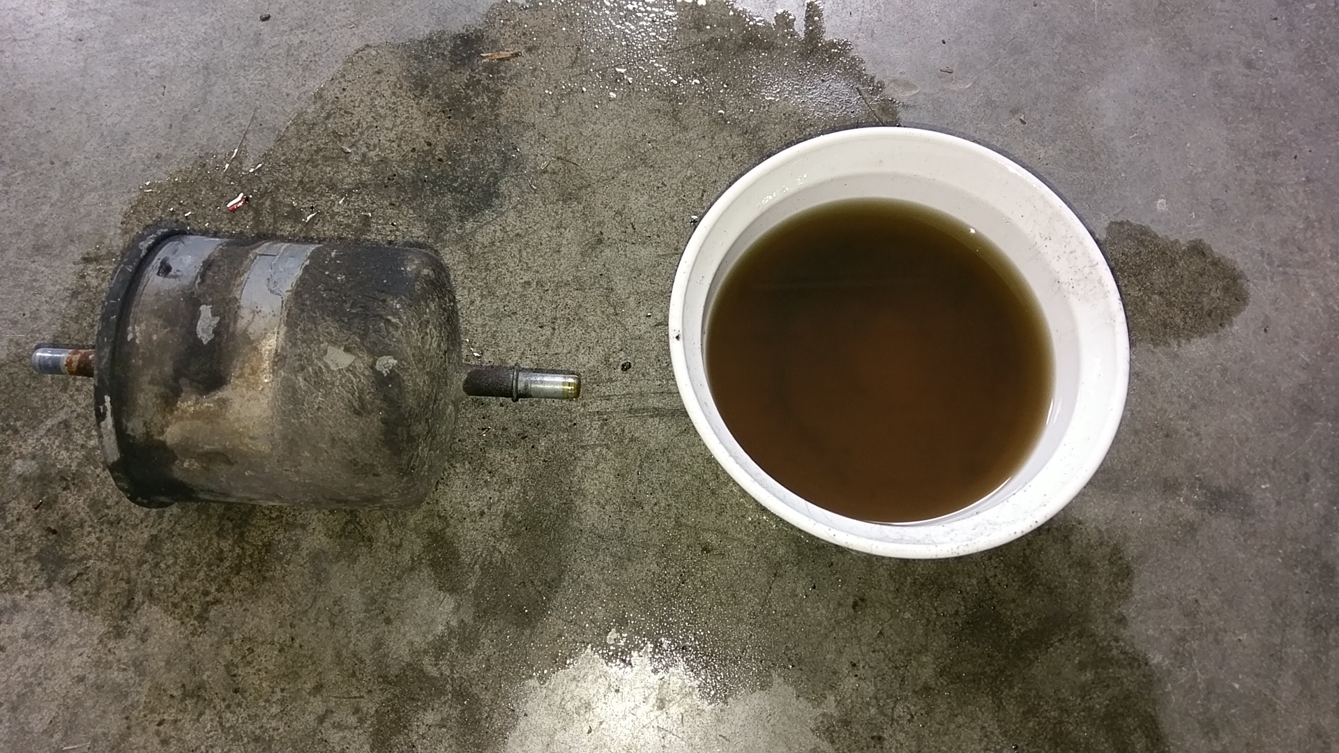

I started from the back of the car and worked forward. First Stop.... Fuel Filter, or in my case, Dirt Collector! How on earth this thing was passing fluid is beyond me! Pump should have a much easier day of it now!
Think this one was original!!!
The coolest feature EVER!!!
2017-05-25 19.11.57-2.jpg (153.9 KiB) Viewed 1678 times
I must say... I have worked on a lot of Euro cars, but Volvo with their little engineering Easter eggs are awesome! Replacing the fuel filter has always ranked low on my scale of repairs. Getting fuel all over everything isn't fun in my book, but as I pulled this one down I noticed a Schrader Valve... Hmmmm?? Now the typical car, you pull the FP fuse, run the car till it dies and then usually still have some residual pressure to spit fuel at you. Hit the Schrader on the fuel rail.... Yuk! Volvo put a Schrader right there at the filter!!! You release the pressure into your drain pan!!! I got less than an ounce worth of gas out and never had to pull the fuse or start the car!!! AWESOME!!!
But what came out was not!!! Ewwwwww :shock: That was bad. I am betting it hadn't ever been changed. 132K+ worth of dirt and crud! The car got up and went before I changed it... but I don't know how! It's got to be pumping a lot easier now!! Can't wait to see if that changes it's already pretty good gas mileage around town :D

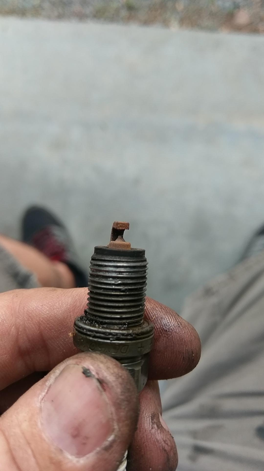

Dirty job now complete... I had one job ahead of me that I had been dreading. Spark Plugs. Why you ask? Because when inspecting the motor after getting it home, I pulled the plugs. #5 gave about 1/2 turn and stopped hard. A couple of back and forth and I got about 3/4 turn but that was all I was willing to push it. So I sprayed a bit of oil down the hole, replaced the CoP and waited for new plugs to come in.
Being no time like the present... having 5 new plugs... and the spare V70 up and running.... I decided to try and pull #5. Well, the oil and having a mildly warm motor worked! It came out with just a bit of hesitation. It never "loosened" up to undo by hand, but I didn't have to push too hard on the wrench. So I got it out and inspected it....
Can just see the rolled spot on the thread.
Well... there were a couple of shards of AL on the plug, so I tossed the borescope down the hole. I found a couple of shards and mis-shapened threads in there too. A few minutes with a dental pick and a the scope showed rough, but clean threads. I'll see if I can't get them out of the scope and post them for all the techno-nerds like me here. It really is a valuable tool!!
So after brushing the bejesus out of the threads, I hosed them down with WD40, slathered the plug with copper anti-seize and prayed to the automotive gods above!!! I must have held my tongue right, because the plug, although taking a bit more than hand pressure to move, hit the seat and torqued to a nice 20ft/lbs on a warm to the touch cyl head. It looks like I may have dodged the bullet on that one. I really hope that I never change the plugs again. If I do I may simply forgo that cyl or find some unsuspecting garage and let them do it!! Nah.. I'm not that mean. I'll have this handy next round... Time-Sert... but hopefully since the plug that came out didn't look that bad and it seated nicely, that day is a long way off!!!

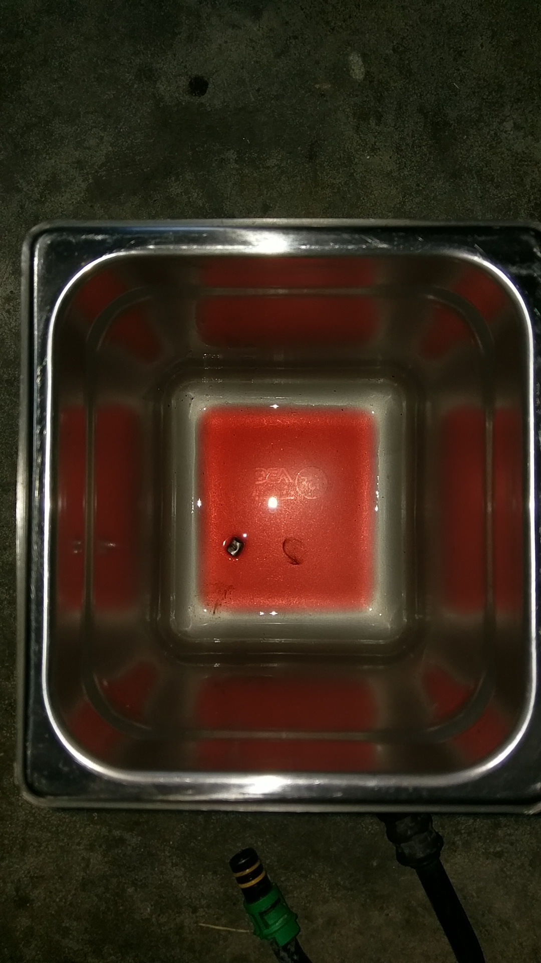

So after 200 miles or so over the weekend, I once again flushed all the TLS yesterday (yes... it was a known sacrifice!!) and inspected it. I think I got all the oggie boogies out, don't you?? It's shifting even smoother than it was before and I didn't think that was possible. I can barely feel some of them and flip it into Geartronic to see what gear it is in!! I need to do a full CMA (Control Module Adaptation) now with the new TLS fluid and rebuilt Solenoids to really tell... but there is more to this...
TLS Fluid after 100 miles in bad trans.

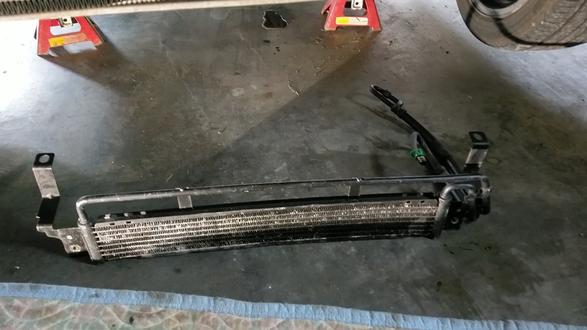

Sven has had one nagging little problem that no one has been able to give me anything more than a somewhat educated guess and no amount of flushing has corrected. From trans guys to forum answers to car restorations nuts. Nothing made the problem better... I'll tell you what I am talking about.
Sven shifts AWESOME... 99% of the time. First thing in the AM... Great. Freeway up shifts... Great. Standing starts to ###mph... GREAT!!! :twisted: but the one time he hiccups is after sitting while in drive... like a Drive-Thru or in line to pick up the kiddo after school. 1-2 is often rough and he mis-shifts 2-3 and slightly into 3-4. After a bit of driving, all is good again. I think that there is something happening in the Valve Body, binding or leaking, because once on the roll for a bit all is perfect again!
So short of guessing at a $500 VB and an afternoon of fun replacing it, how do you fix the issue??? An Aux Trans Cooler since it appears to be a heat issue, right? That's pretty straight forward, but you know me... I like to make the simple complicated! Actually I just wanted something that I knew would fit easily without hacking the car apart. My answer... and S60 Trans cooler!!
S60 Trans Cooler. With hoses!!!
Unfortunately it wasn't a complete bolt-on, but because it was Volvo, it was darn close! I'll detail out the process out in another post 'here'.

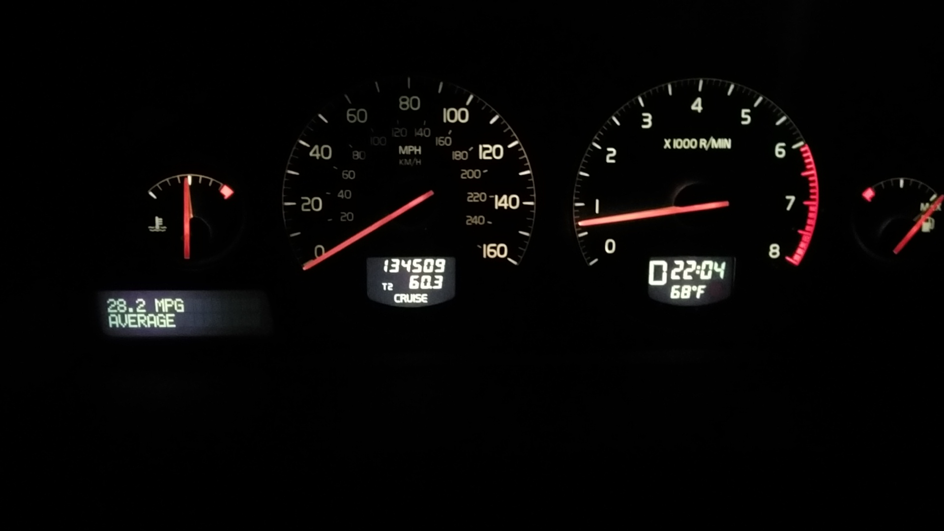

The overall result of my weekends efforts?? I took Sven on a late night drive. Some high speed back country roads (on/off throttle twisties) mixed with some Interstate. I was quite surprised! Sven's Trip computer has been pretty accurate. Within about 1 MPG over the last several tanks. On the first portion of the drive I watched the MPG steadily climb from the high teens to the mid-20s. I filled up at the apex of my loop and reset the counters. On the way home I kept the cruise control on as much as possible to limit my desire to see just what he could do now... passing is effortless and 90s come up faster than I care to admit. I am enjoying my HPT P2!!! :twisted:.. and I was floored! Here, take a look!
Mix of country and intersate.
So even at a mile or so off... That's about 3 MPG better than he was getting before this weekend! I noticed that at cruise, 70 MPH, the RPM has dropped about 200 RPM. So he running much more efficient than he was before!!! :D This morning I sat in a parking lot, in drive, while eating breakfast and just let it pull against the brake. I drove off and not a hiccup! Perfect shifting! We're supposed to be about 85F today, so I'll get him all warmed up at lunch and see if I can make it happen again!
What does this mean? Well, I know I have not "fixed" the issue... I have only hidden it a bit further down the scale. It won't tell me if it's either heat or pressure, but maybe the next time it rears it's head I'll be able to pin it down a bit better. I still have a VB from the 06... I just need to find a "B" wiring harness before I can install it. I may do that here soon, but I want to see how this effects it before digging deeper. I think, based on how well the trans works in almost every other aspect, that I have a worn VB shuttle or bore and that once it gets warm it acts up. Take the heat away and it's fine.
Only time will tell me, huh?
