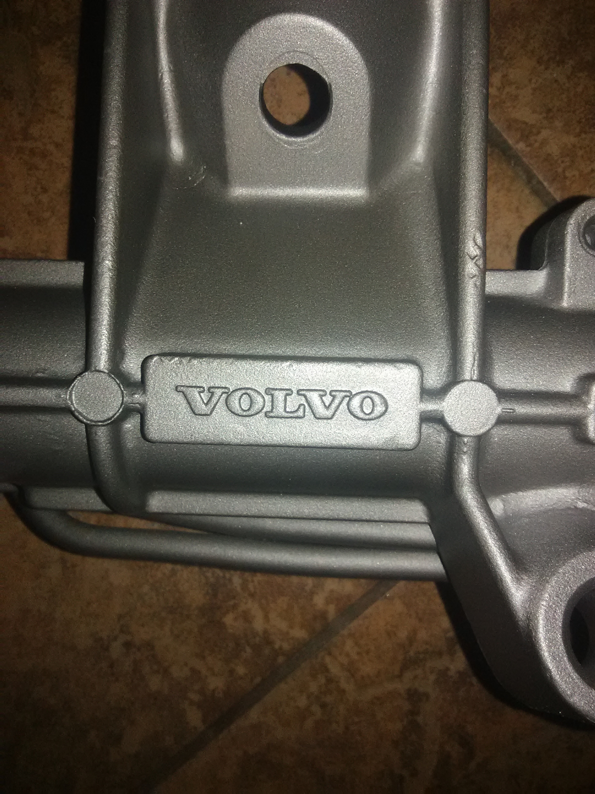

I saw in another thread that someone bought one of the V70 racks from Detroit axle and it did not have the motor mount bracket and Detroit axle said it was optional for rebuilds or something.
viewtopic.php?t=62195

Yikes, hopefully mine comes as a complete piece I can actually install. It kind of seems like this guy is talking about a brand new aftermarket rack, which isn't listed on their site now for our Volvo's but maybe was on there before? They do list new racks for several other vehicles.ZionXIX wrote: 14 Feb 2018, 11:45 I saw in another thread that someone bought one of the V70 racks from Detroit axle and it did not have the motor mount bracket and Detroit axle said it was optional for rebuilds or something.
If what I receive is a remanufactured Volvo unit I don't see why they would gain anything from removing the bracket. I'll know for sure Friday, the part is scheduled for delivery tomorrow but I'll be at work until 1am.

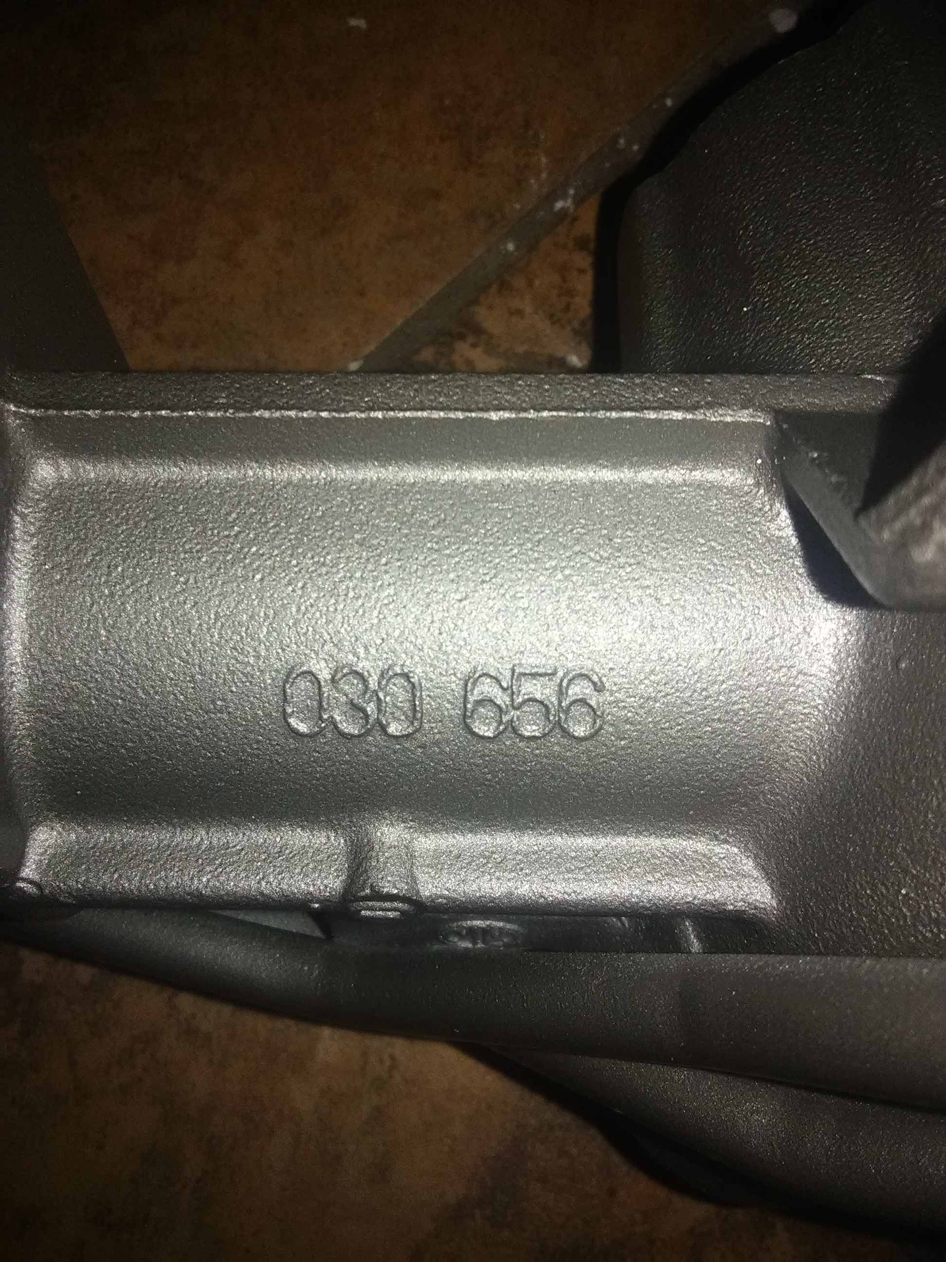

- Posts: 15486
- Has thanked: 2199 times
Check that the manufacturer of the rack is the same as yours. Volvo used 2 manufacturers but they are not a straight swap. I believe either can be used, but you then have to ensure you have the correct inner and outer tie rods.
