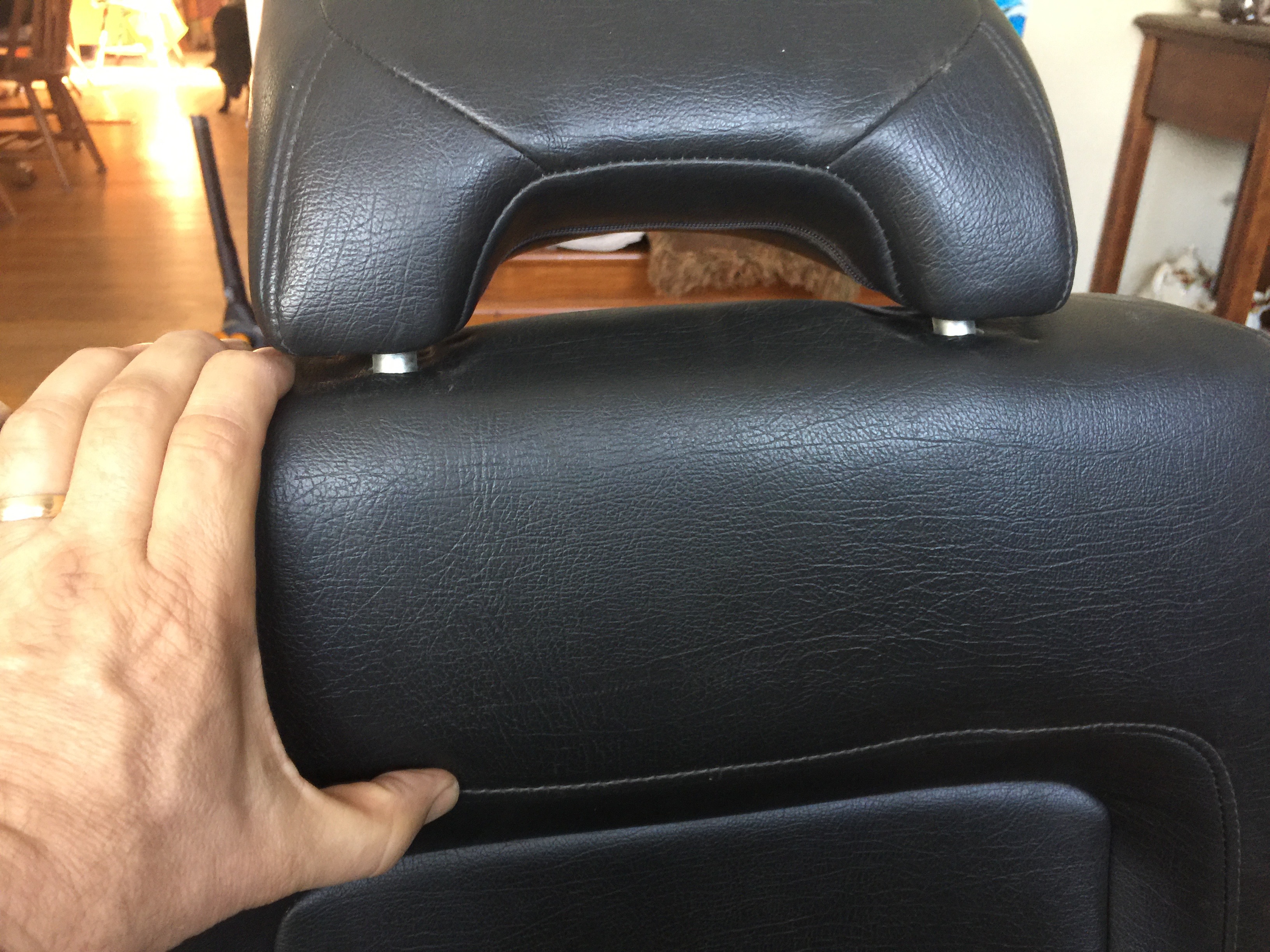

Head rest release detail - there are two places to push on roughly on the seam
Heres the actual latches you depress
This cutout for the SIPSS and the mount hardware makes the seatbacks not-swappable between pass and driver - I knew that, June had to remind me of that though...
