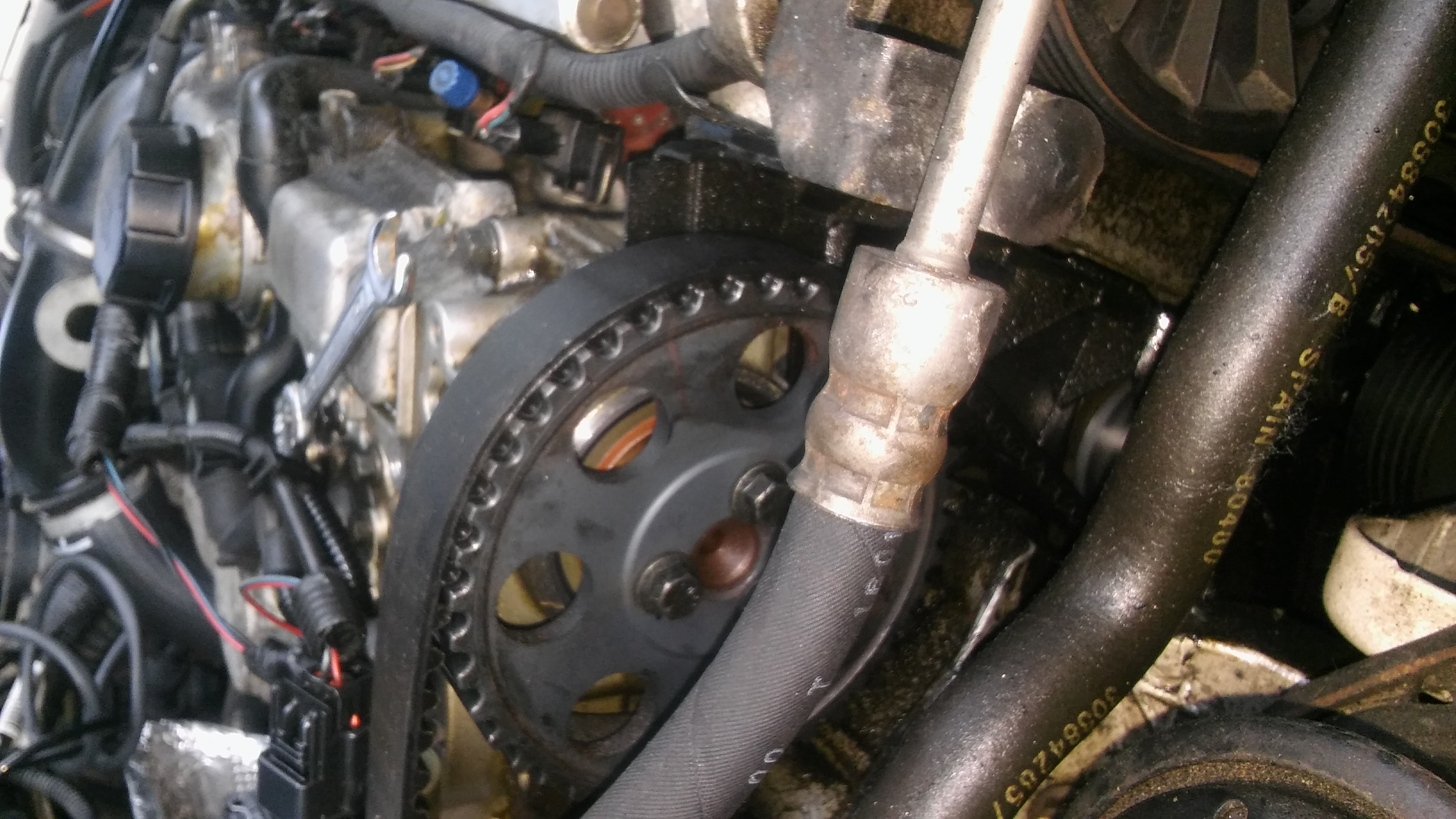

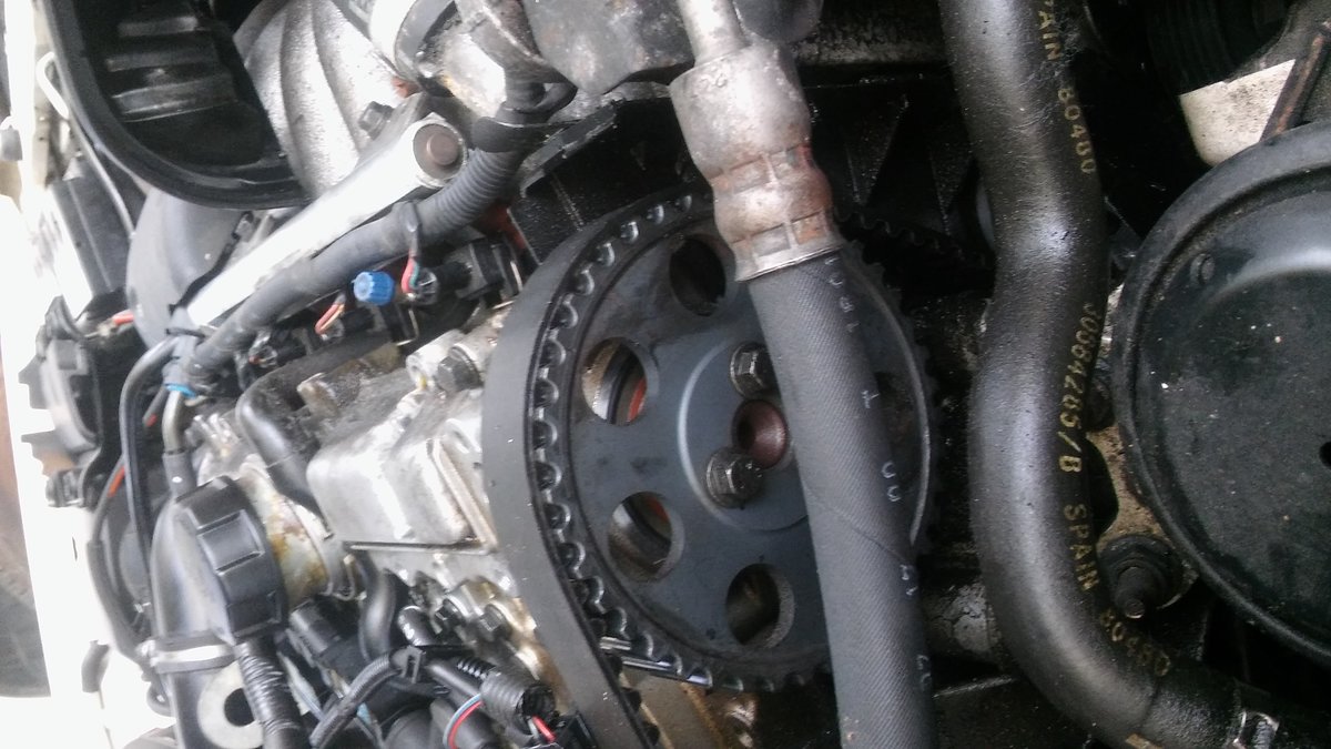

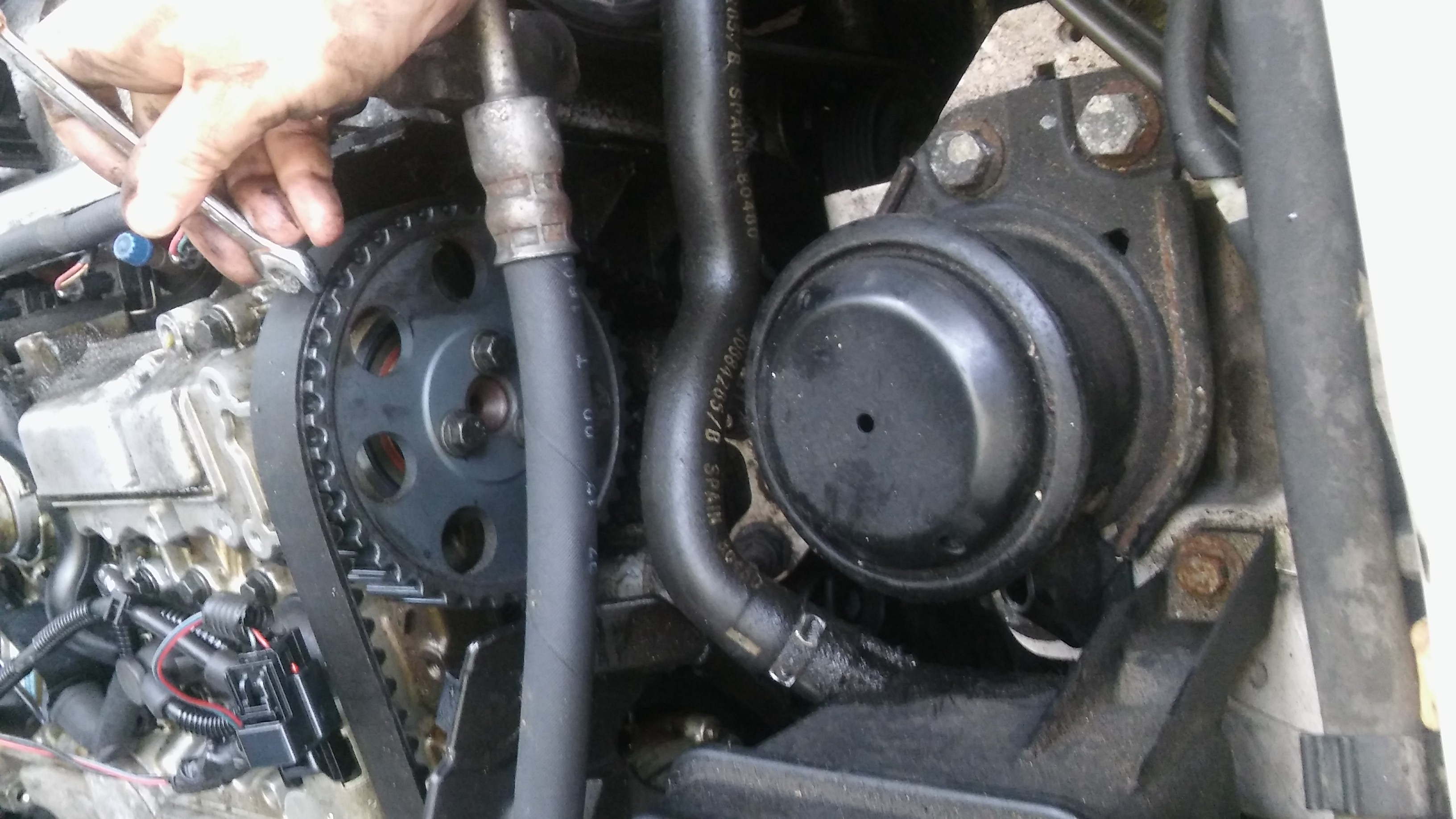

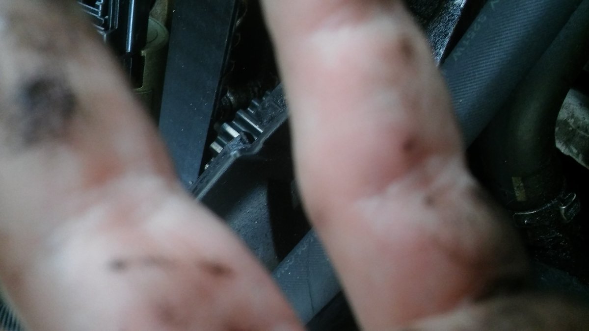

He is a neighborhood guy that has worked on cars most of his life. The belt was loose and covered in oil. He found the timing marks and said that they had skipped. He has a friend that works on Volvos he was going to see what he thought about and and give me a price. I can take photos of what he showing me but he said the oil leak was most likely coming from the camshaft and it was all over the timing area. I will post some photos of it. I was chasing all the codes the car threw off and then thought it was a fuel problem due to it not starting after I put more gas in it. He checked the spark and checked the fuel pressure all that was good so he went to the timing and pulled up the specs for my car and noticed that they were not lined up properly is what he told me.

It looks like the big ones notch is in like to 1-2 o'clock position and the other one that is really really hard to get to because I could not get the cover off the screw was rusted tight. That one is way down in the the 4 o'clock position. The belt is not lose but I can pull up on it. Oily. That is what he showed me they were in not sure I don't understand much of the car type but I do my best to research it or ask questions.

A common problem with this vintage S40 is a failure of the VVT (Variable Valve Timing) hub.
When they fail, the leak oil all over the "front" of the engine. That can lead to a timing or timing belt failure.
I don't remember how many miles are on your S40, but it's not uncommon to experience a VVT failure over 150,000 miles.
I had to replace mine at 185,000.
The bad news is that the engine in your 2001 S40 is an interference engine.
That means it's "possible" - some would say likely - that a timing belt failure can result in bent valves. Which is not catastrophic, but can be costly to repair.
Your "guy" is correct in that it's tough to determine if the engine has bent valves without either replacing the timing belt and checking compression, or removing the head and doing a visual inspection.
If the timing belt has "skipped". there is no way to replace it properly replace it without the proper camshaft holding tools.
It's not a terribly difficult job, but it does require some know-how.
