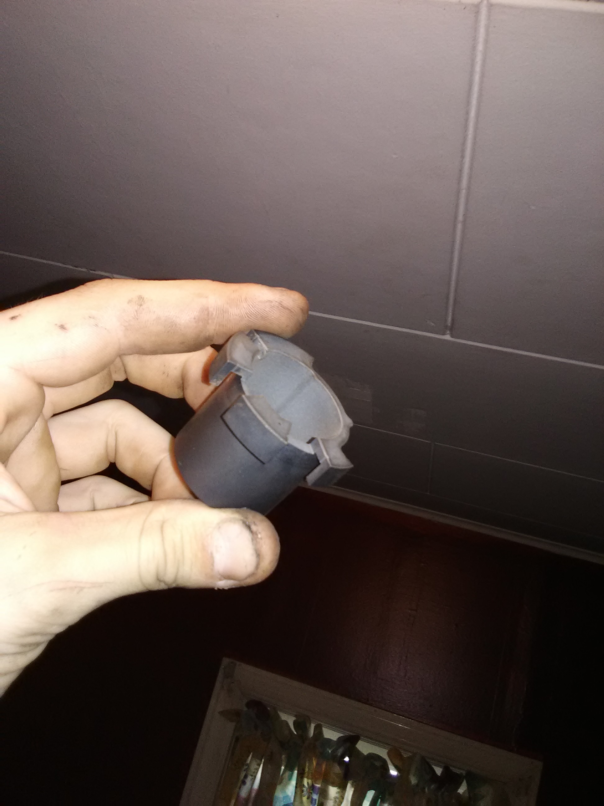

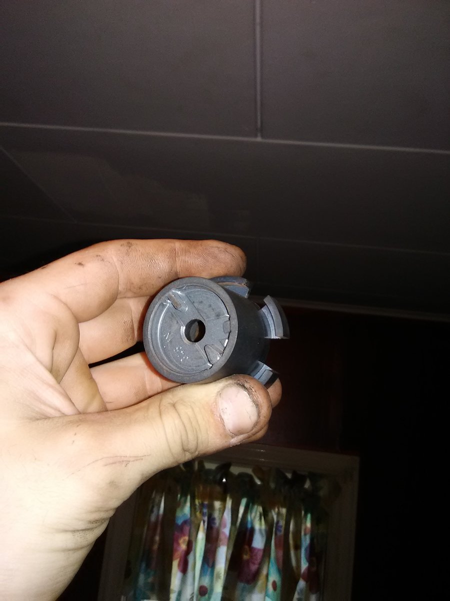

Hey guys, quick question. I had to take of a plastic piece that was bolted to the lock end of my VVT cam. In the midst of taking it off, a little piece of it broke off. What is this piece used for?

Can you post a picture of it? Not sure I recall any plastic pieces on the end of my VVT cam, just the metal camshaft position sensor and aperture.Cupojoe710 wrote: ↑20 Sep 2018, 11:20 Hey guys, quick question. I had to take of a plastic piece that was bolted to the lock end of my VVT cam. In the midst of taking it off, a little piece of it broke off. What is this piece used for?

The plastic piece on the rear end of the engine (left hand side of car) is a cam seal plug which self-immolates on removal. Order up a new one and replace.

Yeah, that’s the aperture for the camshaft position sensor. The sensor itself is mounted off to the side and reads the position of the camshaft using the gaps in the aperture as the camshaft spins. So if that’s broken then you’re going to have some issues.Cupojoe710 wrote: ↑21 Sep 2018, 15:24 This would be the piece that came off the VVT cam, it's metal not plastic lol
