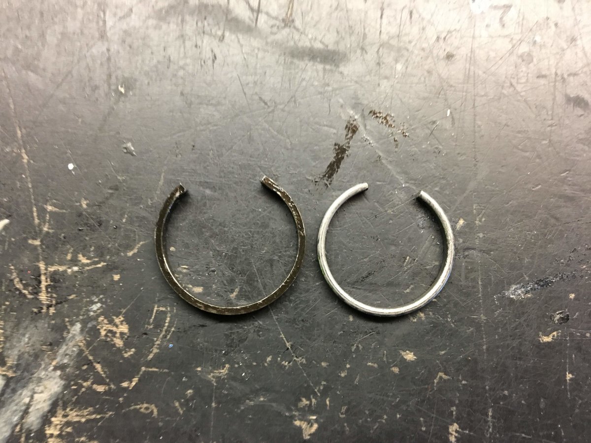

Well, I got the axle out... finally. I decided to give it another go today, and I was able to pop it out just a little bit more with a flat bar. Then after a lot of prying and pulling, I decided to go rent a slide hammer from Autozone. The OEM 27033 slide hammer paired with their FWD CV axle removal attachment (27058) worked wonders! I was able to pop it out in a couple of blows with a little effort. Sometimes you need the right tool for the job, and nothing else will do!
The circlip on the new axle (that I just removed) was definitely larger than the original one, you can see the difference pretty clearly. Unfortunately this axle still won't fit, even with the original Volvo circlip. I ended up getting the original axle socket/inner piece stuck in the transmission when I was test fitting it, but I guess that's okay though, I'll just get the rest of the axle and pack it with fresh grease and a new boot. I can't pry it out enough to get the slide hammer attachment back there, so I might as well just leave it there.
I tried to use the new axle, but the CV joint is bigger, so I can't do anything with it.

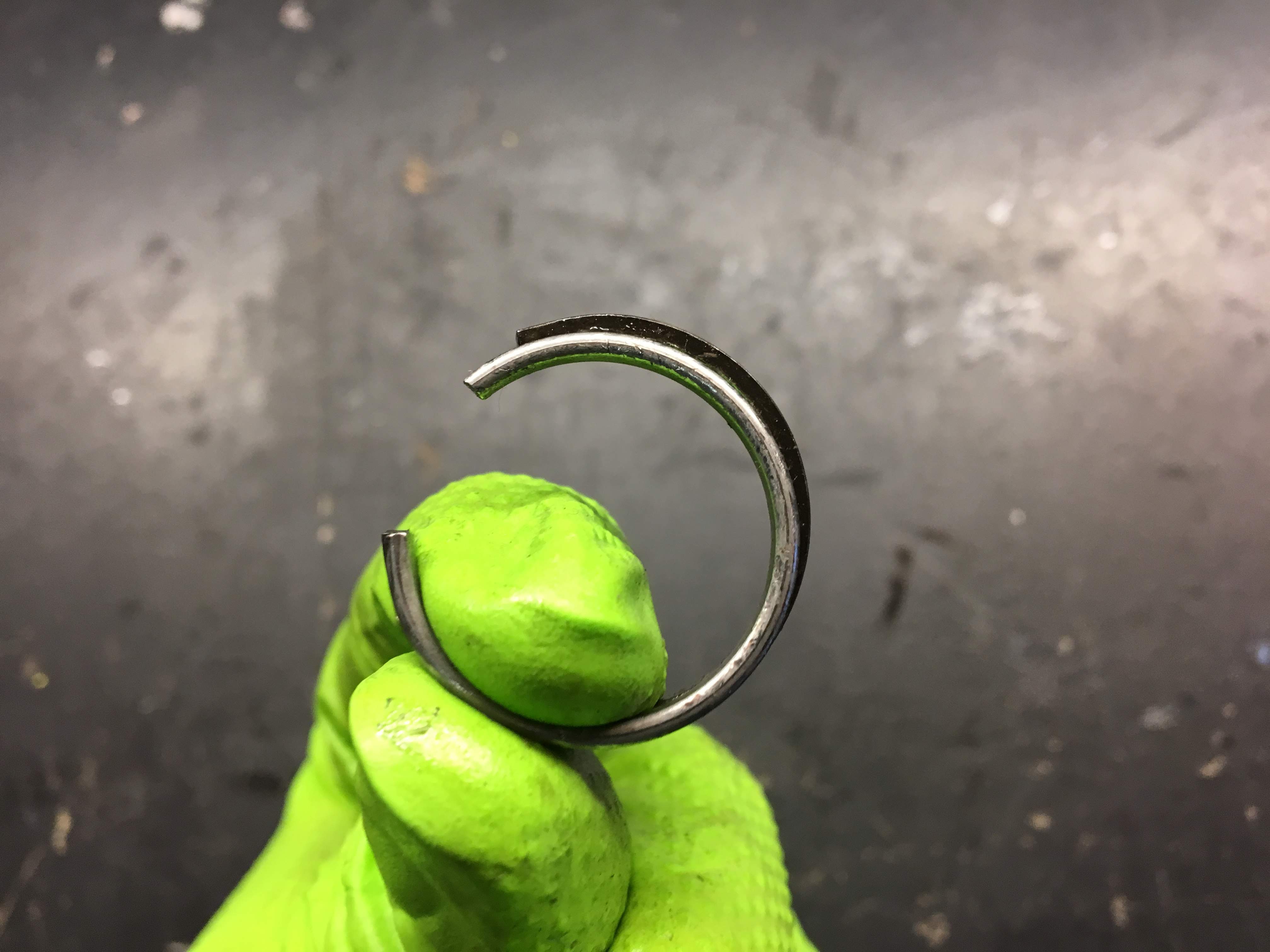

Assuming the silver one is the OE Volvo part, then if you also look at the profile of the ring, the edges are rounded but the aftermarket one is flat sided. That would allow it to possibly rotate and dig in. It may have then caused a ridge in the hole in the transmission. Carefully run your finger in that hole and see if you can feel a ridge. Just don't get you r finger stuck in there!!

scot850 wrote: 03 Jan 2019, 21:27 Assuming the silver one is the OE Volvo part, then if you also look at the profile of the ring, the edges are rounded but the aftermarket one is flat sided. That would allow it to possibly rotate and dig in. It may have then caused a ridge in the hole in the transmission. Carefully run your finger in that hole and see if you can feel a ridge. Just don't get you r finger stuck in there!!
I felt around and carefully looked at the splines in the transmission, and it appears all is well!
