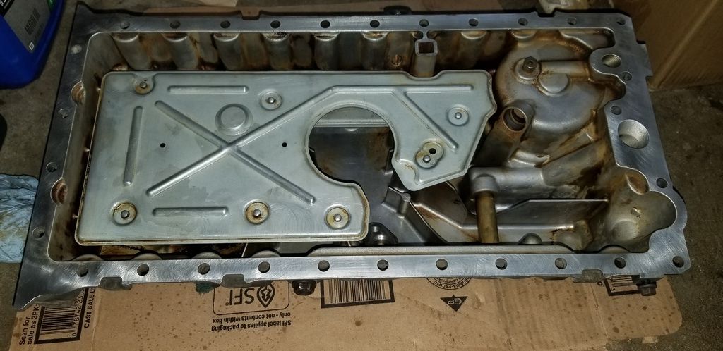

I mounted the scrubbed sump on Sunday.
As Xheart noted in his earlier thread the trick is to first get the front side laying on the fuel line. Proceed with getting the trans side mated then throw on 4 corner bolts with low torque. No extra hand nor jack is needed.

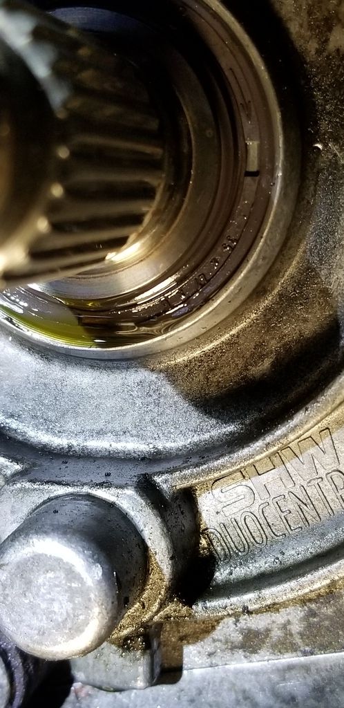

While fixing the oil sump leak I created another leak. The front crankshaft seal was slowly leaking. The UV dye found the slow leak.
Here's a pic using the UV flashlight.

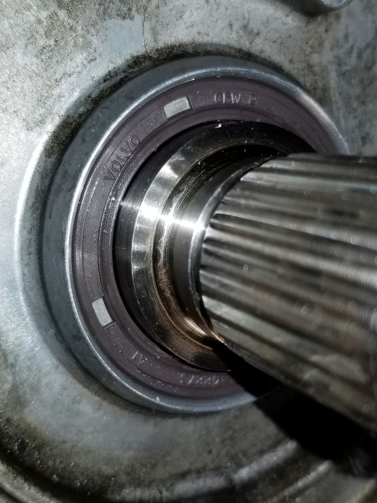

Here's the seal after removing the oil pump. As you can see the garter spring is torn off the seal. I obviously didn't use enough caution when installing the oil pump over the rod.

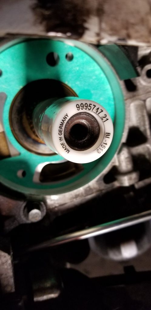

The mechanics at the Indie Shop gave me hints and let me borrow their Volvo Sleeve tool 9995747. I coated the sleeve, seal, and where it mates on the cranshaft rod with oil. I then slowly installed the oil pump onto the crankshaft rod.
I used a 1.5" PCV pipe and rubber mallet to firmly seat the new seal. I placed the old seal between the pipe and new seal for cushion.
With UV dye added to the new motor oil I'll check for leaks in a few hundred miles again.
