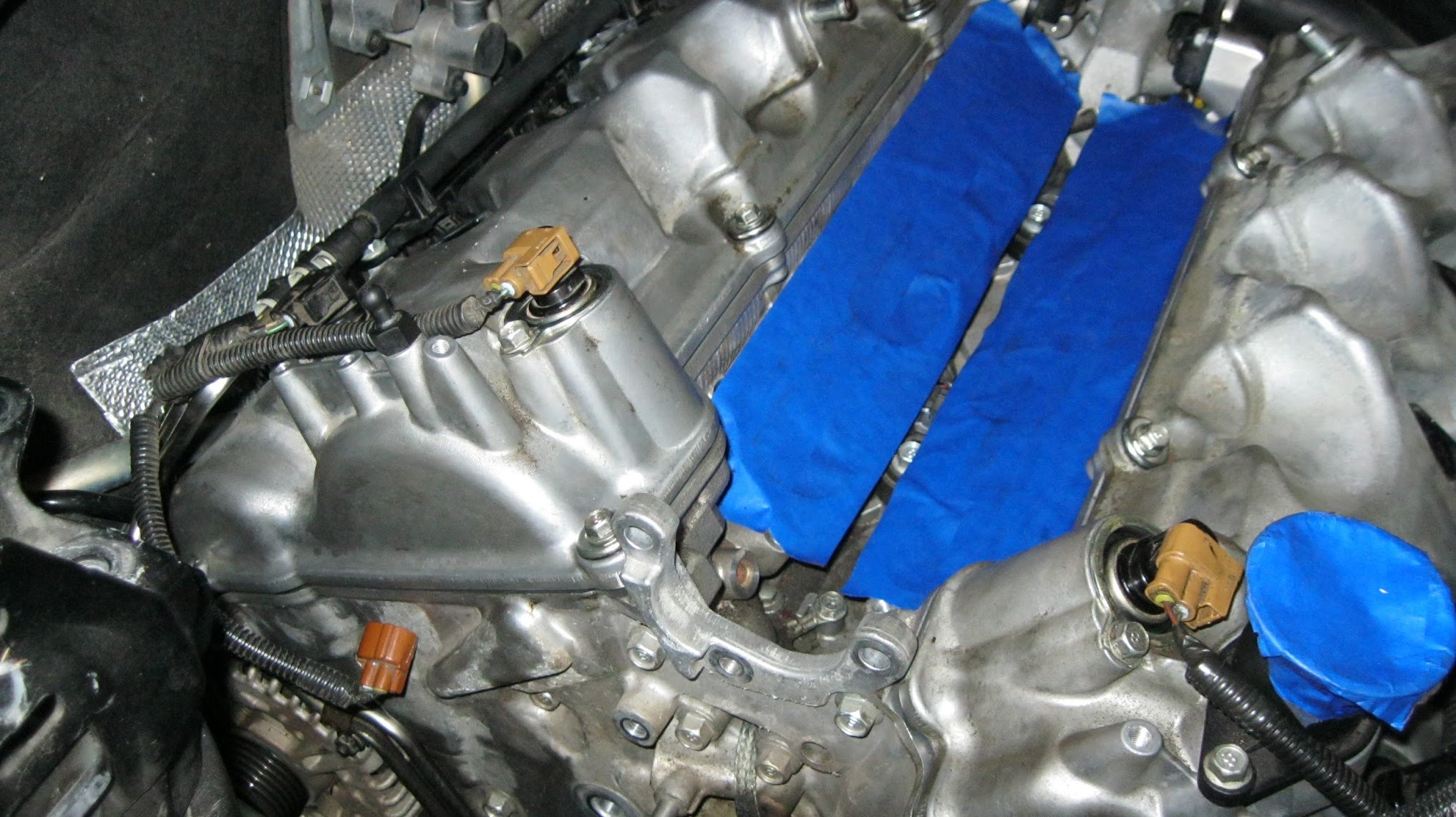

It's back on the road. Hooray! :D It took a while, primarily because we had a backup car, (it was merely inconvenient, not urgent,) and life gets in the way. All told, it took me 7 months. But that 7 months included new floor throughout the main level of the house, a day job, life with an active daughter, and just not working on it when getting home from work. But it's done!
The biggest problem was that I tore the rear valve cover gasket, and didn't realize it. I had to squeeze it in between the camshaft and the rear wiring loom, and didn't realize I tore it until the first test drive. On that test drive, I lost a quart of oil in 10 miles, all on to the rear exhaust manifold. (Oops.) I had to remove the intake manifold and rear valve cover to discover exactly what I had screwed up, then wait for parts (again) before getting it re-assembled a second time.
I'll post more details in the next couple of days, but I thought I'd share the good word that it's running again. And yes, I missed the V-8!

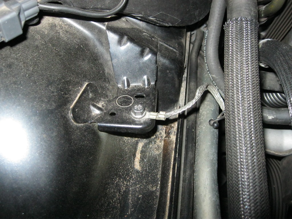

Hi, i was wondering if you could help me find this ground's home: It's the one that lands on the right strut tower under the power steering and coolant reservoirs.
i hope it isn't going somewhere i have to remove a head to land :(

Not sure if this is what you're looking for-

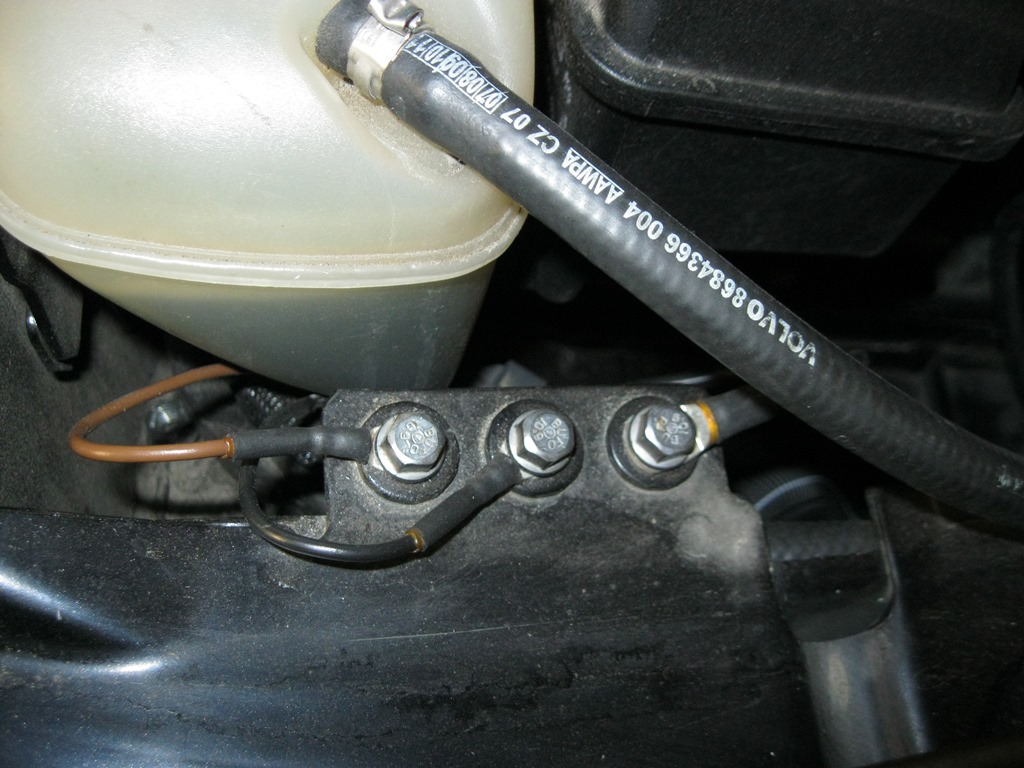

XC90 V8 Ground PassSide_1.jpg (279.12 KiB) Viewed 2456 times
XC90 V8 Ground PassSide_2.jpg (193.69 KiB) Viewed 2456 times
Have a link with some more photos in the even it's helpful- https://goo.gl/photos/tcLSKkYEp6KqkbaR9

ggleavitt wrote: 13 Jun 2019, 13:34 Have a link with some more photos in the even it's helpful- https://goo.gl/photos/tcLSKkYEp6KqkbaR9
It's this one:
Thank you very much!
