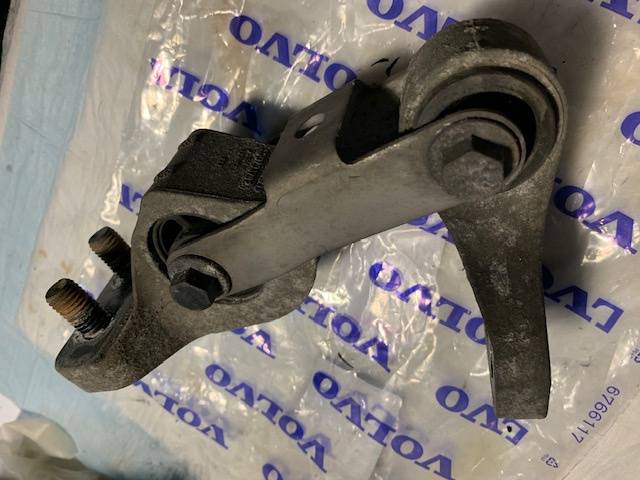

Our experience says that the Volvo transmission torque rod, aka transmission mount, is to be replaced after 100,000 miles. The loud clunk at a gear shift from P to R (or P to D) before rolling away is this failed mount -- not audible when AT shifts during a drive. Volvo PN 30793792. Bernoulli would love the drive -- just wow.
