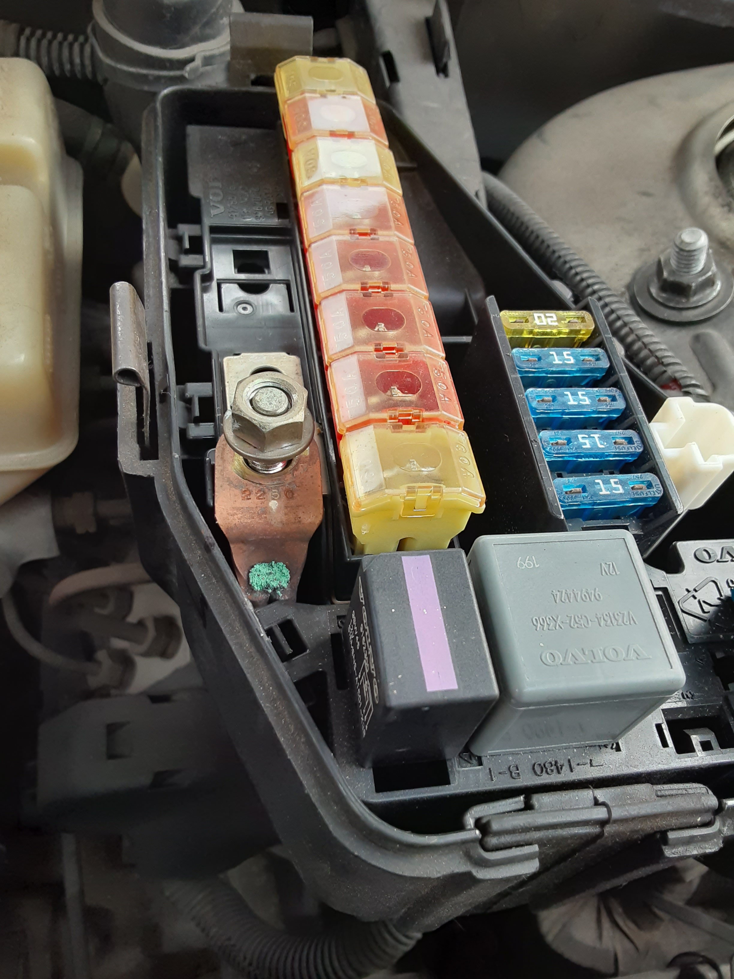

I'm trying to find a way to safely remove the positive cable and install the replacement cable . I've started a cut out on the fuse box .

Maybe cut off the lug, then pull new cable using old as messenger line??

Would it be safe to clip the old wire and connector off ? Or just install new cable on top of old connector and cover and secure the battery end of old wire ?

Find the battery end of the old wire and remove it. I think that is the one wire on the battery post but that needs to be put right

After installing the fuse box positive cable , I still get the same no start after warm. I'll have to let it sit so I can move it out the driveway .Think its about time to move on to something less finicky !
