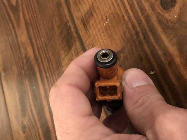

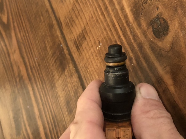

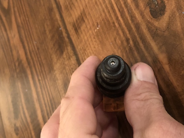

Post pictures of the rebuilt the injectors, business end views.
Measure the resistance of each injector and post the numbers.

Post by echosierra »
All 5 measured 14.9 ohm
Yes its weird to say that the rebuilds are bad, esp when the shop gave me a writeup saying that the spray pattern was improved, etc.
I didnt want to list the name of the shop yet....maybe theres some protective cap im missing or totally not seeing w/the rebuilt ones. Am I the idiot here?
If im not stupid, and the rebuilds are truly bad, then ill list the name of the shop.

Probably a distraction but are those yellow (wrong, NA injectors) or orange or red (correct injectors)? Presumably yellows would still fire, I don't know of anyone ever trying them in an HPT engine, but just curious.
