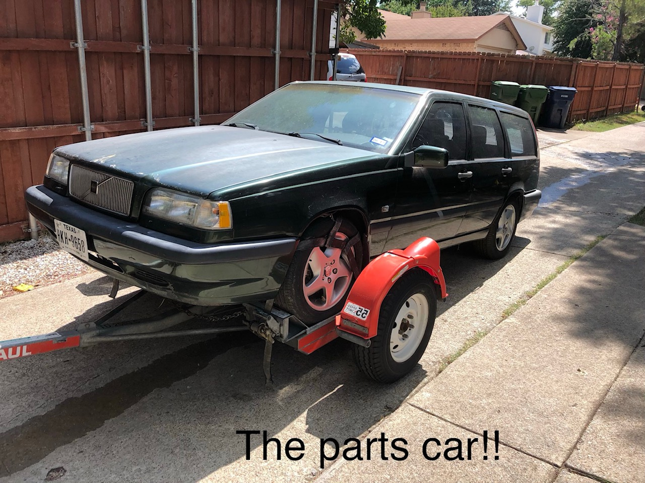

Where do i go next? this is my 1st Volvo and I love it but also starting to hate it. it ran strong before i decided to be my own mechanic. also I came across a running parts car (1997 turbo wagon) for free!! and brought that home a couple days ago

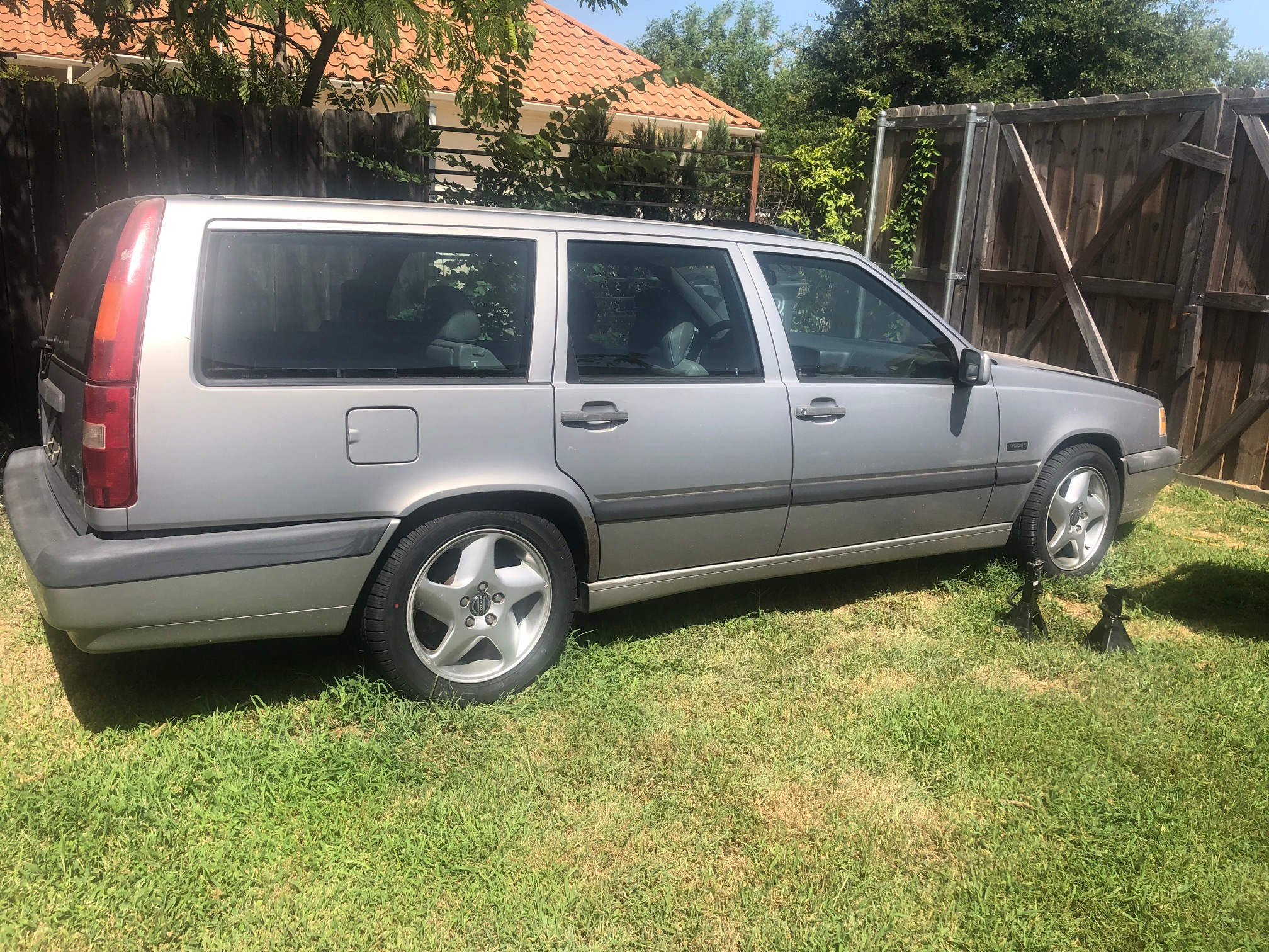

Here's pics to edify you all =)
