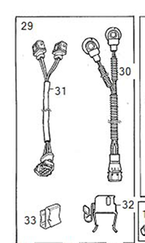

Okay, I got the wiring harness (9442158) and it has 2 male plugs on it, just like the plugs on the knock sensors. WTF? It's number 31 on the parts diagram, and right next to it is number 30, which is described as "knock sensor".
It says "made in Finland" on it though, which is pretty cool.
A little more digging, however has turned up a 2 pin connector identical to the one I removed with the severed wires available from Volvo for under 4 bucks, part number 979040, so I can do a gender change on the new harness. Apparently they are still using these same 2 pin connectors on 2019 V90's!!

Post by 850oldschool »
Clearly marked with the proper part number. Here I applied a filter to the relevant area of the picture they have at www.volvopartswebstore.com so you can see the connectors better, and also enlarged the relevant area of the parts diagram(#31). The connectors are male, just like the knock sensors themselves.

Oh it is the right part. Part number 31 is to adapt an old wiring harness (two female plugs) to a new knock sensor (one male plug, part 30). It is of course not a replacement for a bad harness, you'd need a whole new harness for that. Maybe you found your way out of things with the adapter but such is the risk with a google-based approach to things. Wish I had paid attention to the other posts about what you actually need, sorry about that.

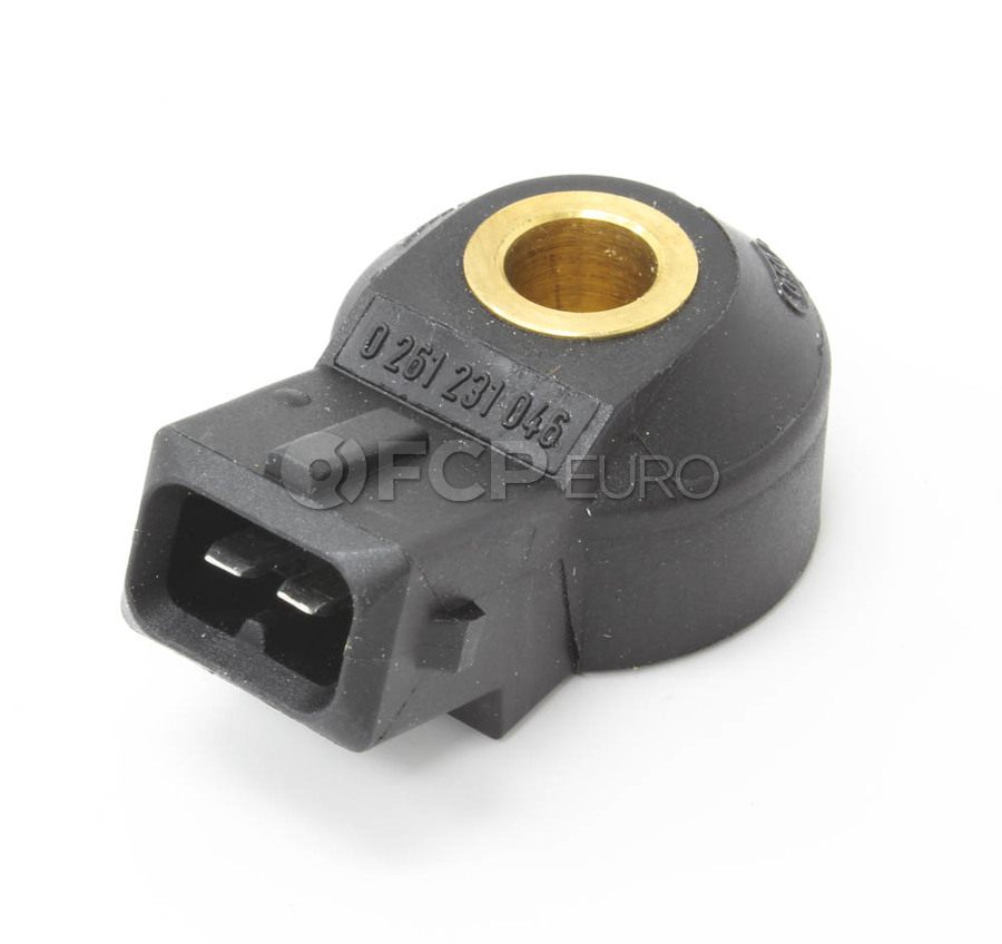

I'm really not sure what you're supposed to use 31 for. The Bosch 0 261 231 046 discrete knock sensors look like the picture below, with male connectors. Maybe in the early years there were knock sensors with female 2 pin connectors?
The part number (1270492) associated with 30 (pair of knock sensors with wiring loom) on the diagram looks a bit different from the drawing. 31 has a 3 pin female JPT connector, while 30 has a 3 pin male JPT connector.
The good news is that the online Volvo OEM parts sellers have the proper female 2 pin JPT connector (979040) brand new for under $4, so I don't have to spend an hour driving to and from the junkyard to get one, I can just get it delivered to my door, and I can repair my existing wiring.

Pretty sure the knock sensors didn't change across early P80 cars. They are just simple lo-tech microphones. Been too long (thankfully) since I was pulling lots of intake manifolds, I don't recall ever seeing a difference.
But sounds like you're on it! Let us know what finally fixes it, surely others will run into this problem at some point.
