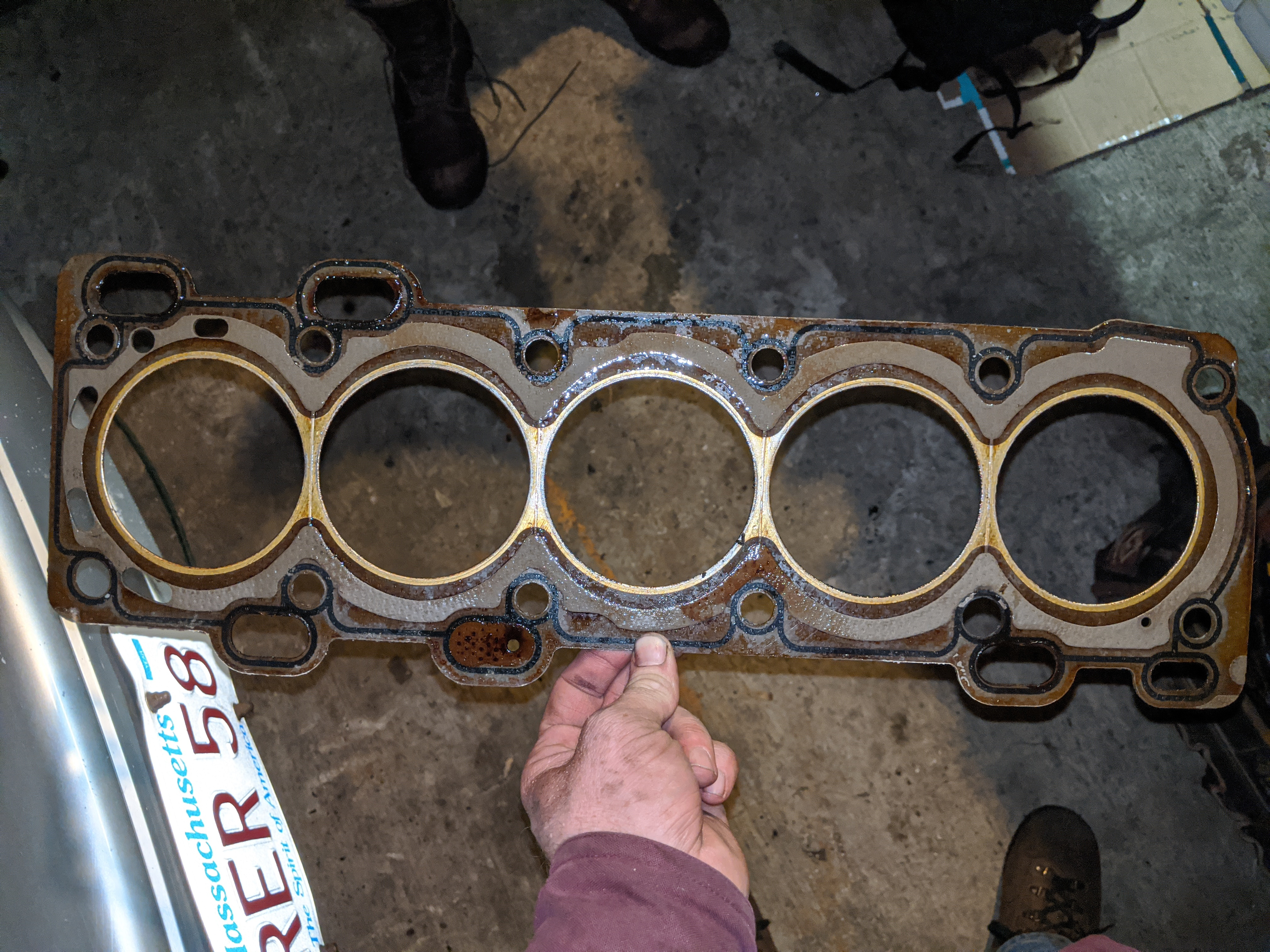

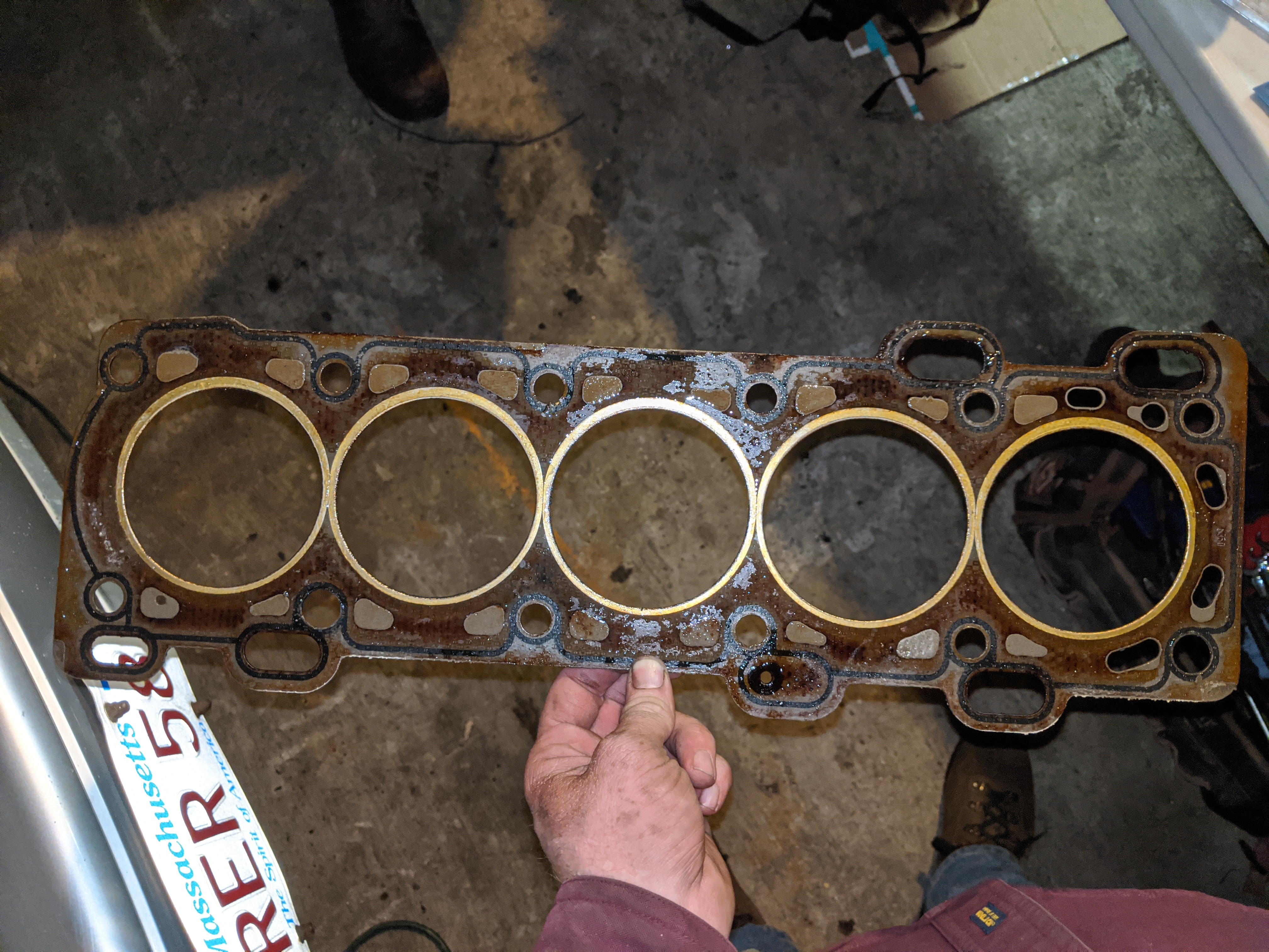

Got it all off, the head gasket doesn't have any super clear problems to my untrained eye.

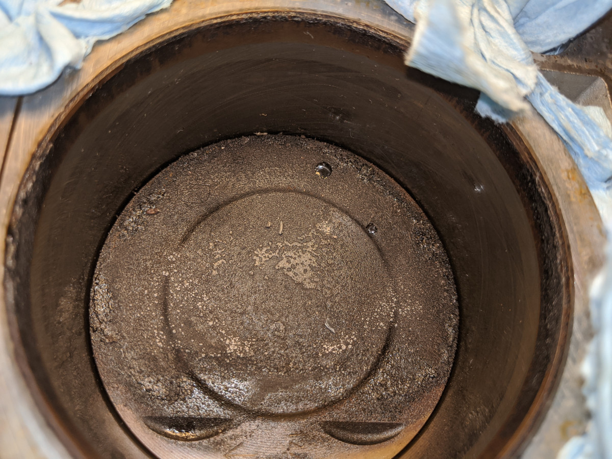

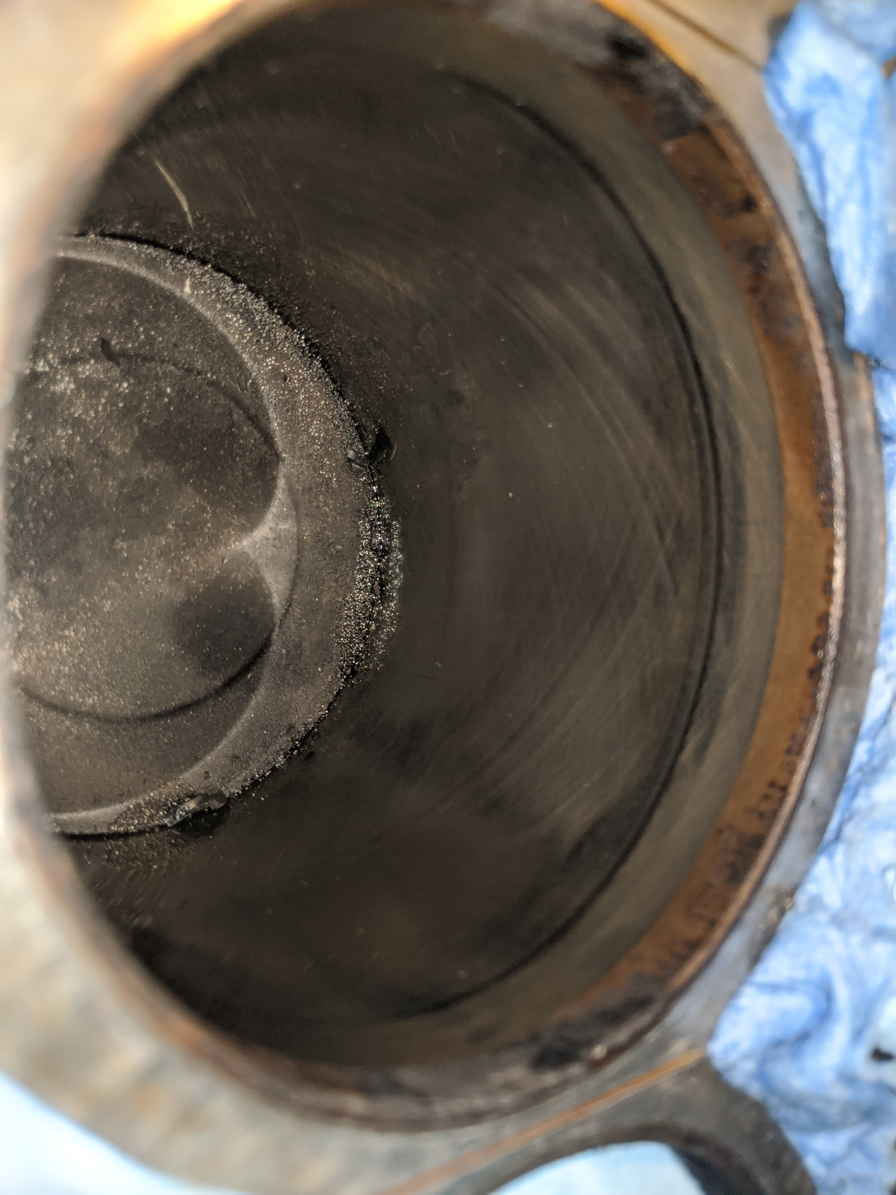

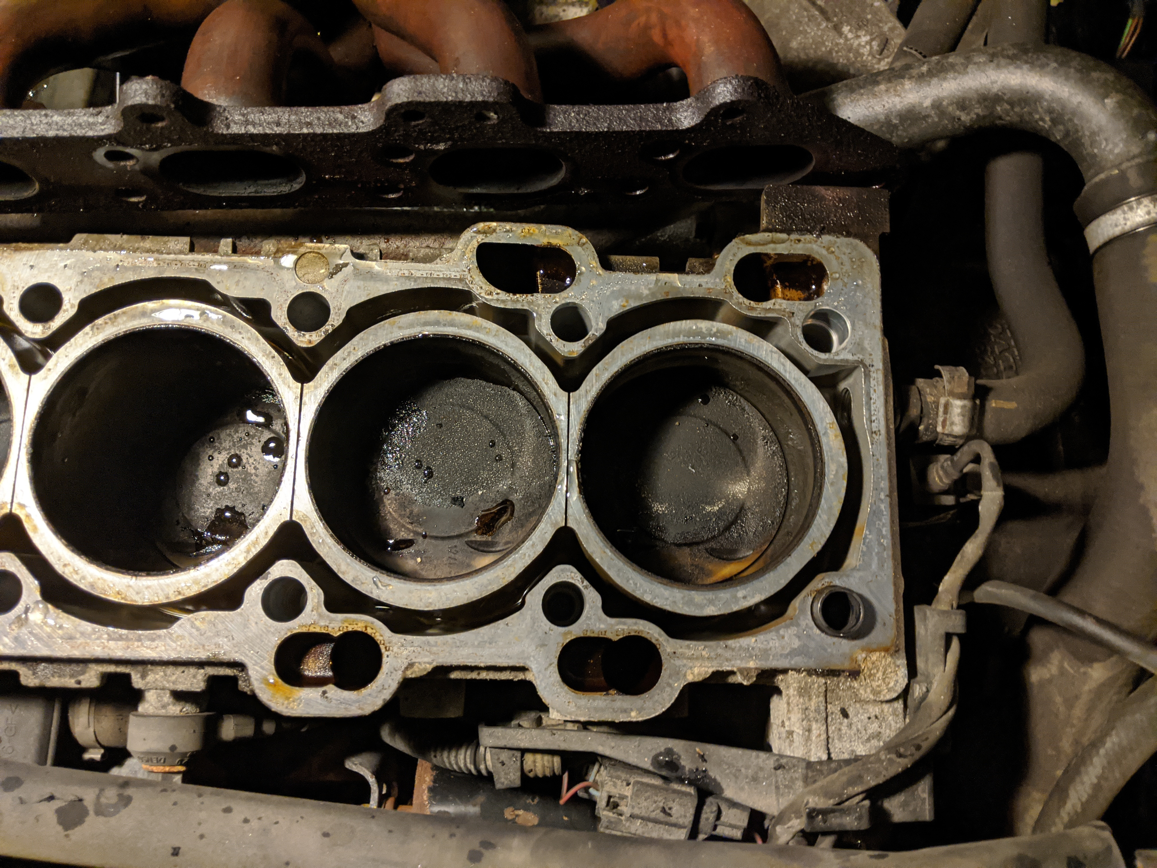

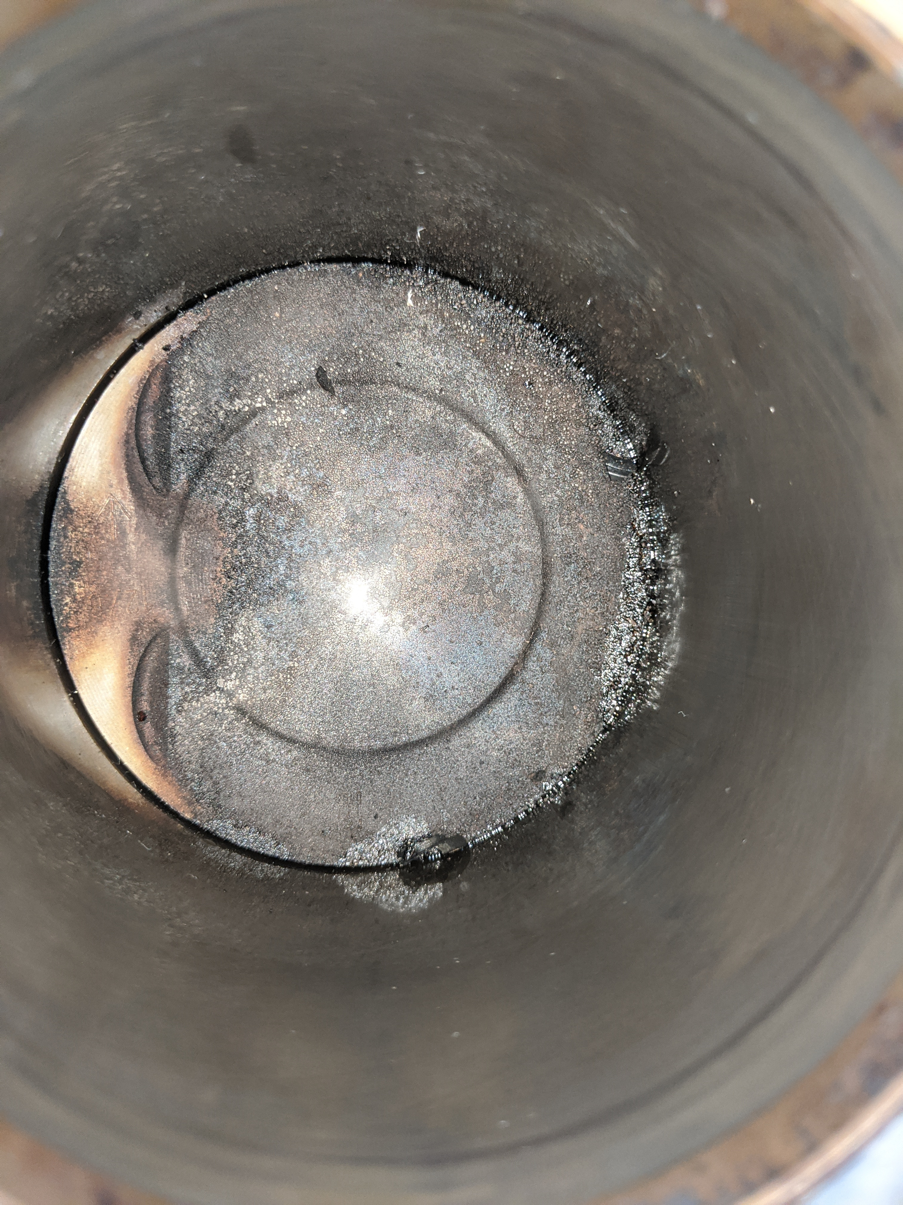

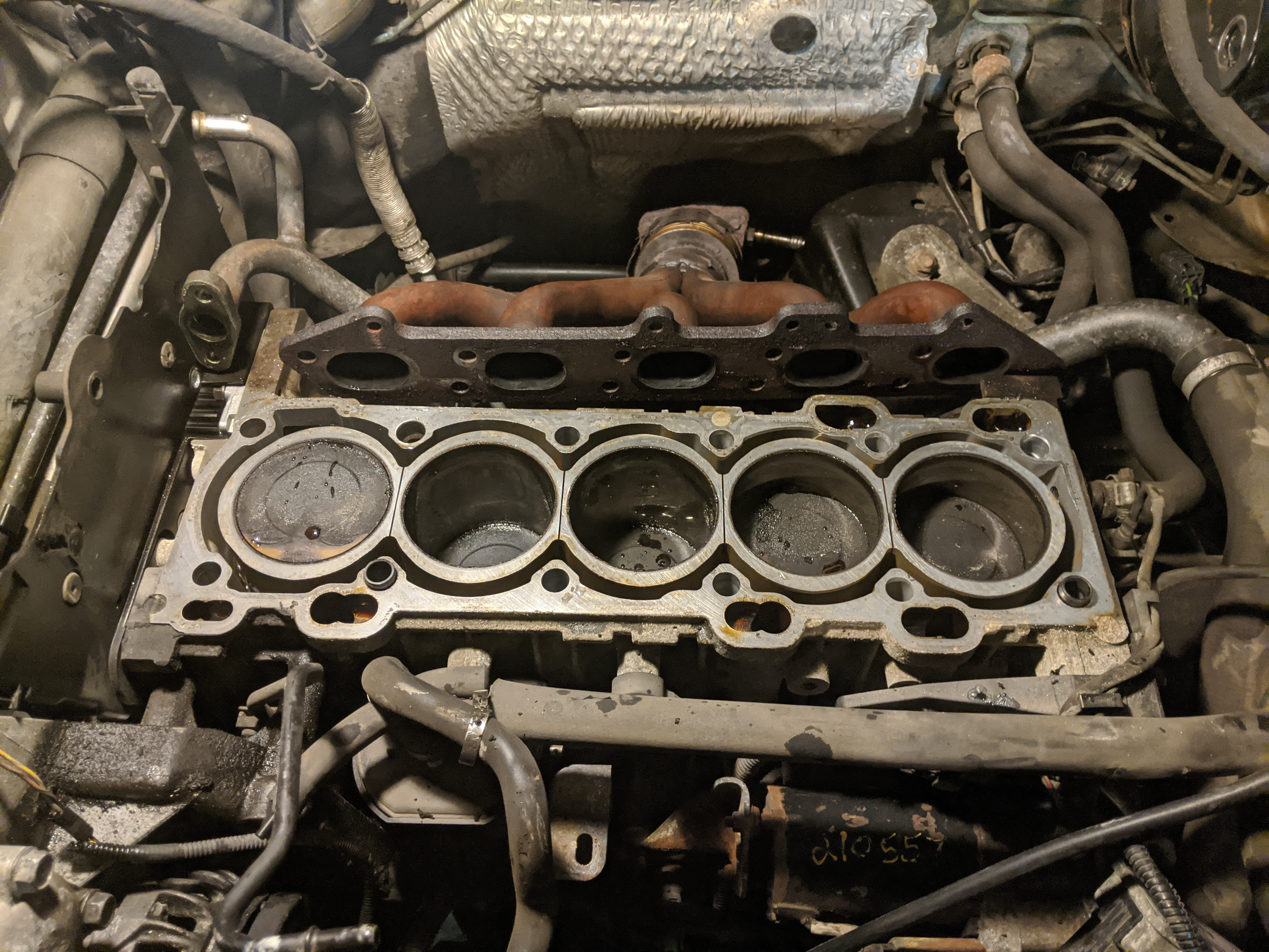

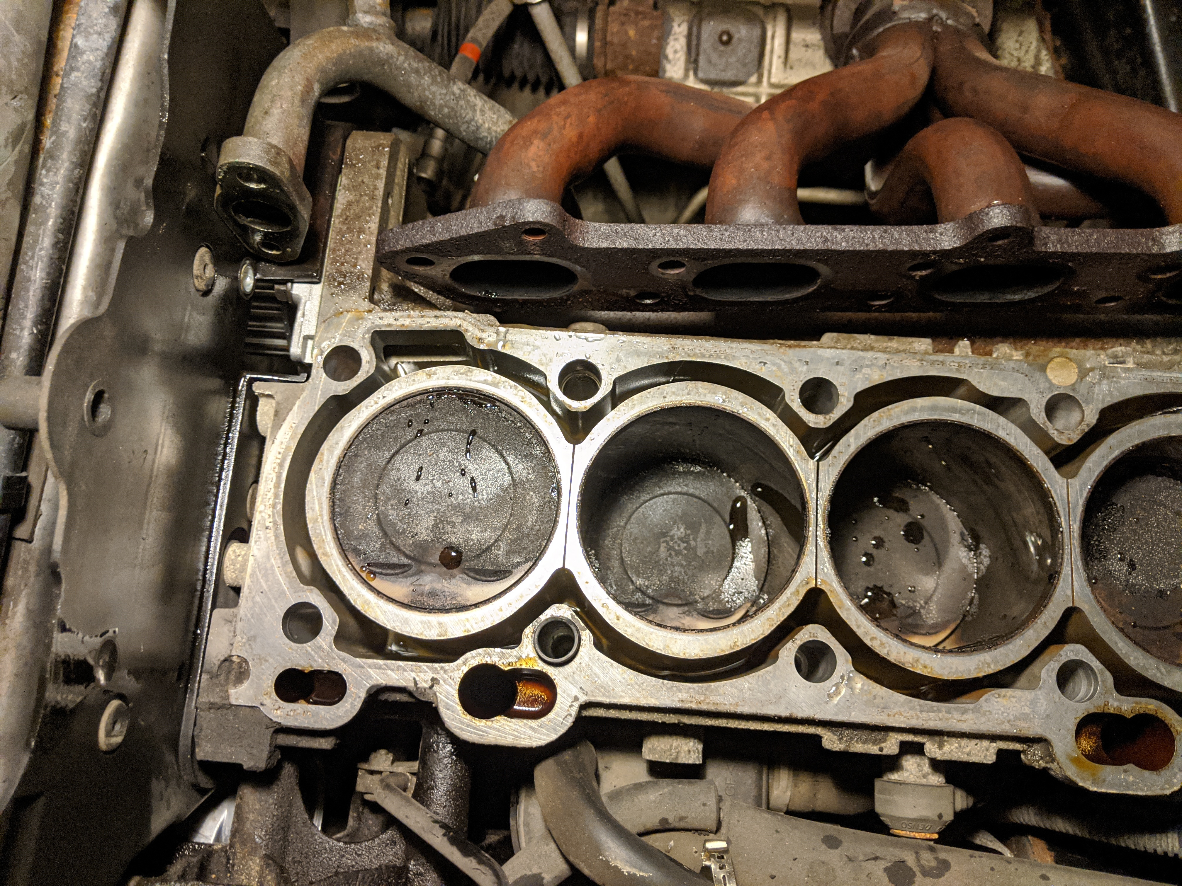

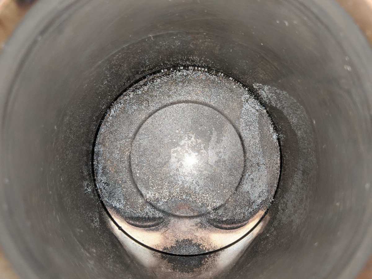

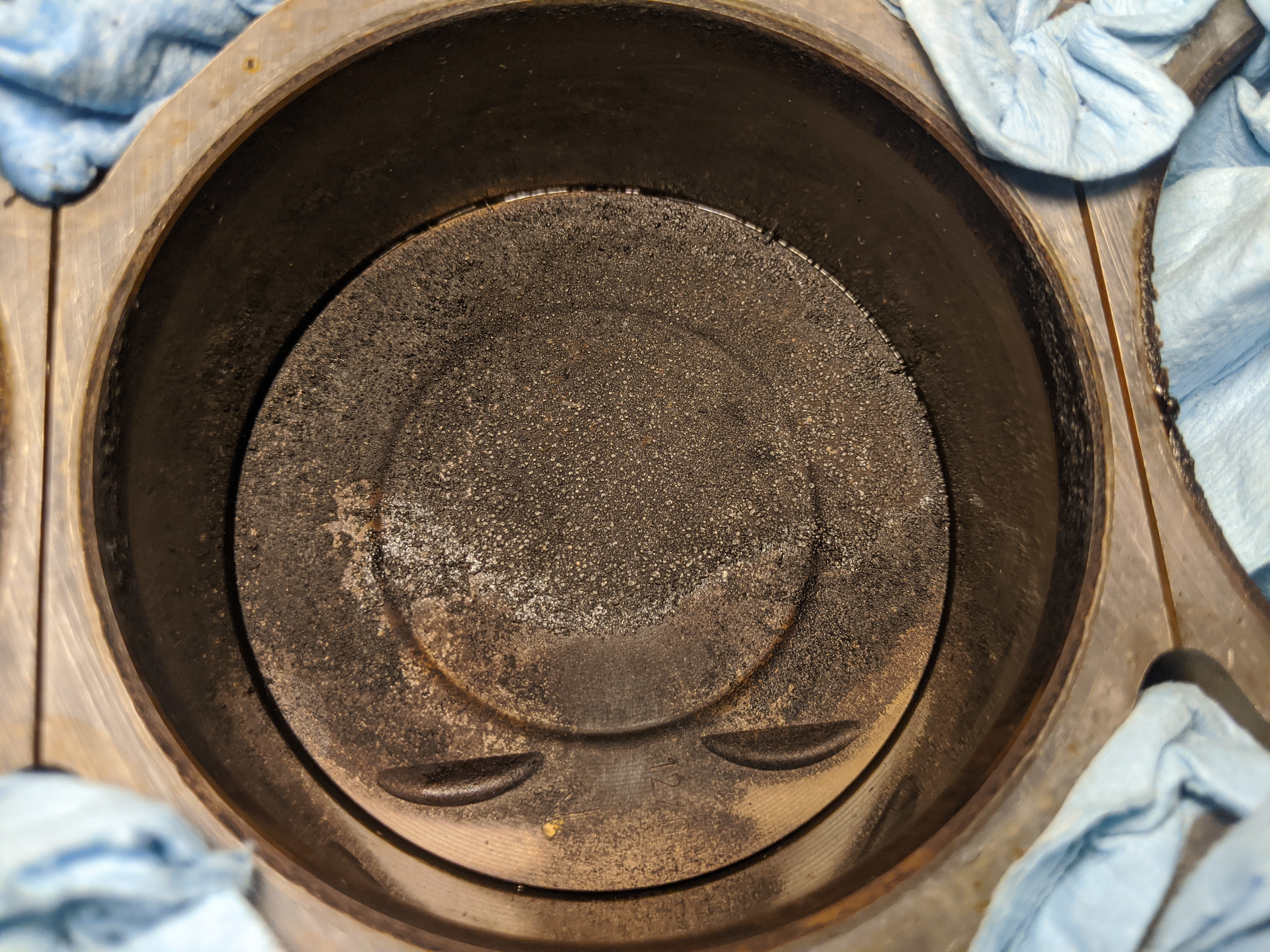

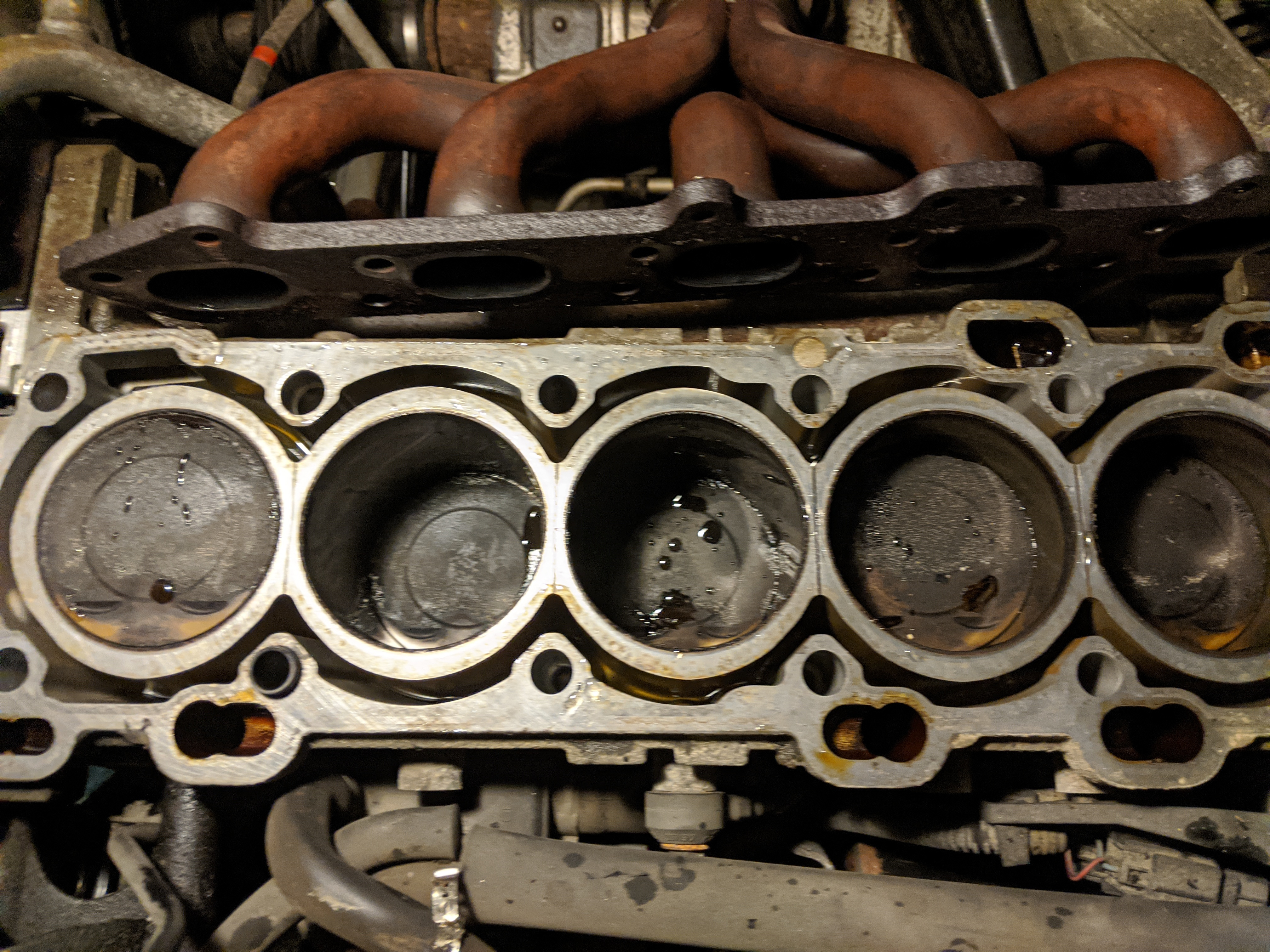

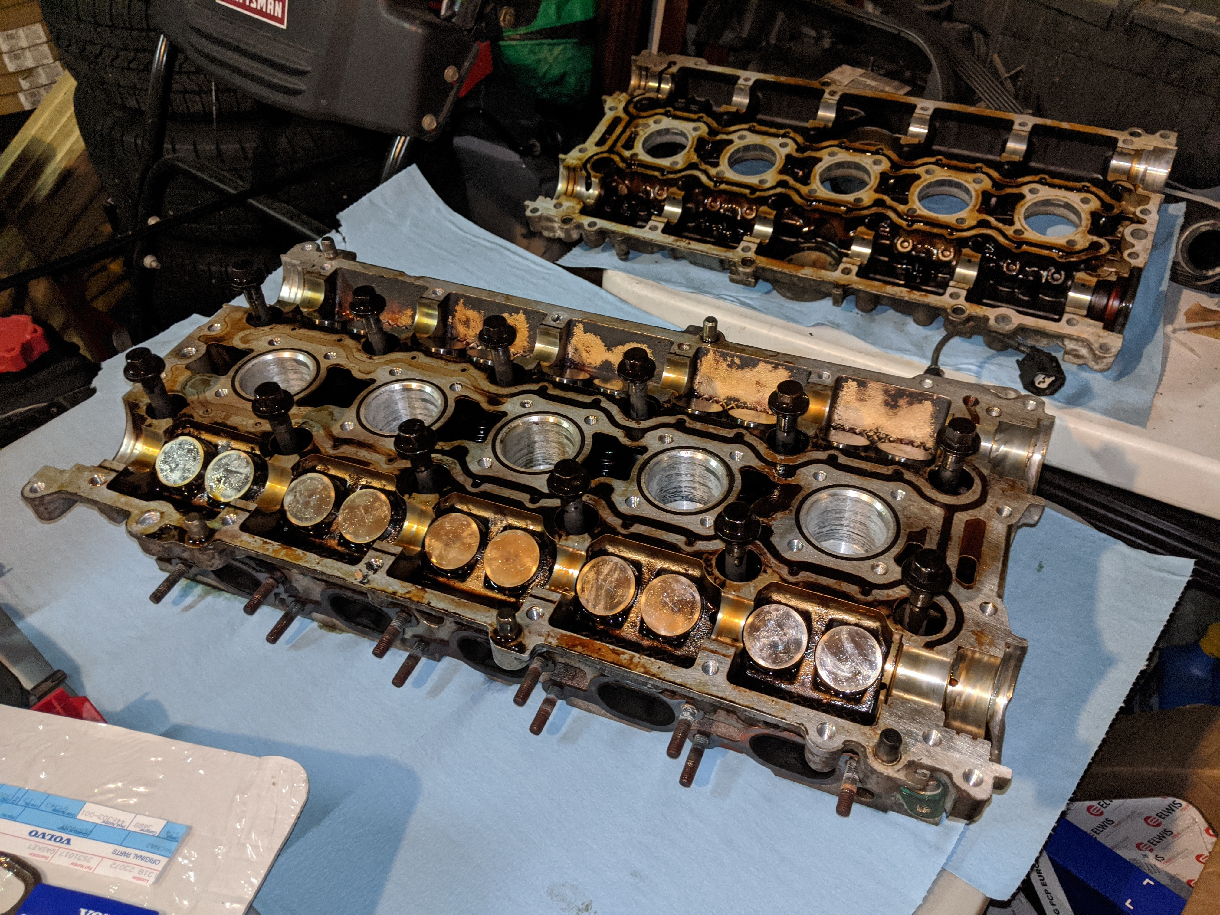

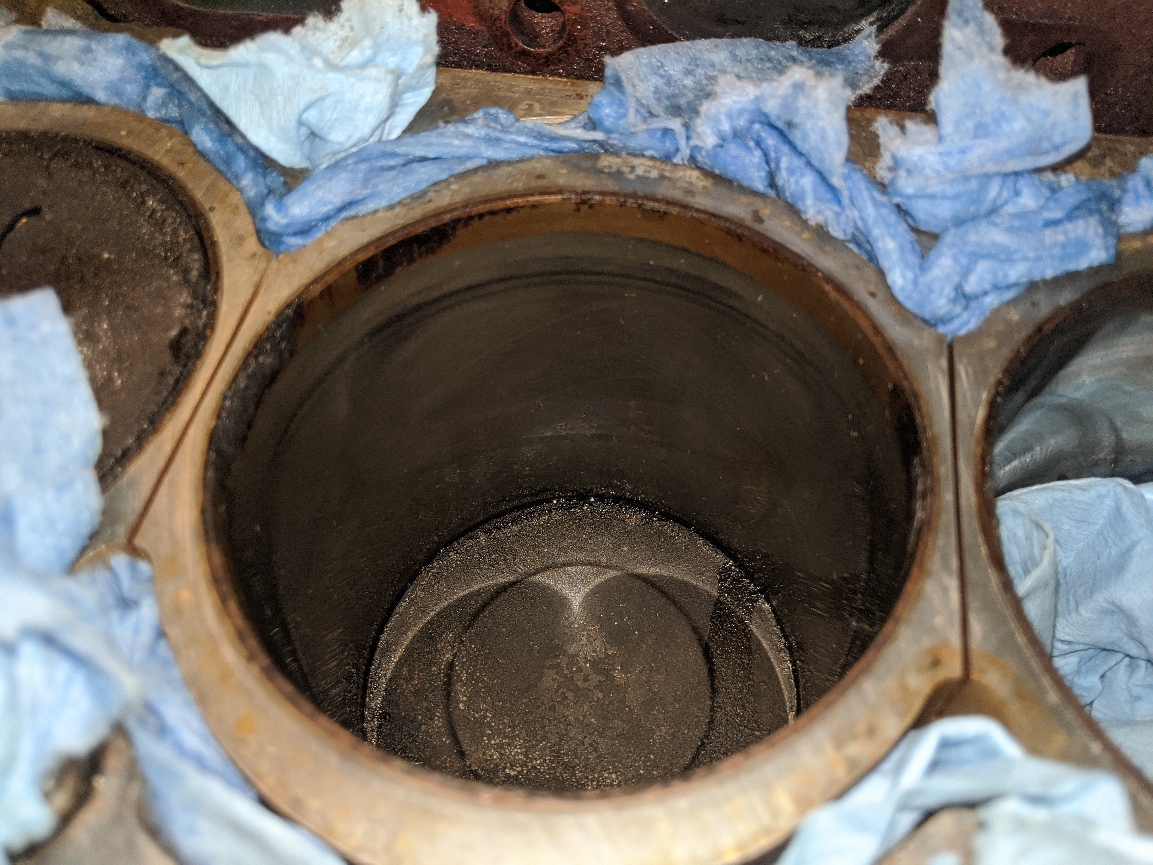

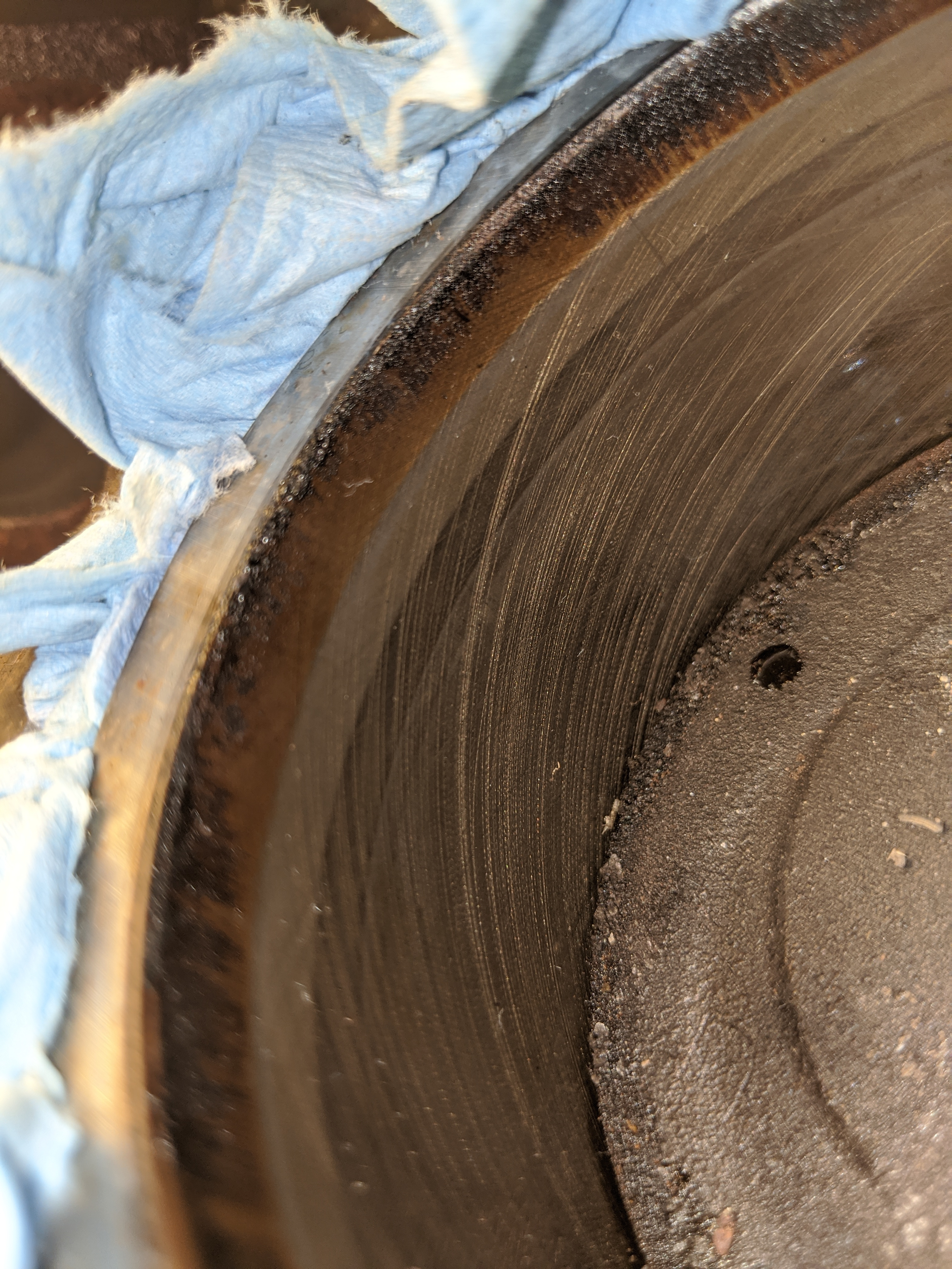

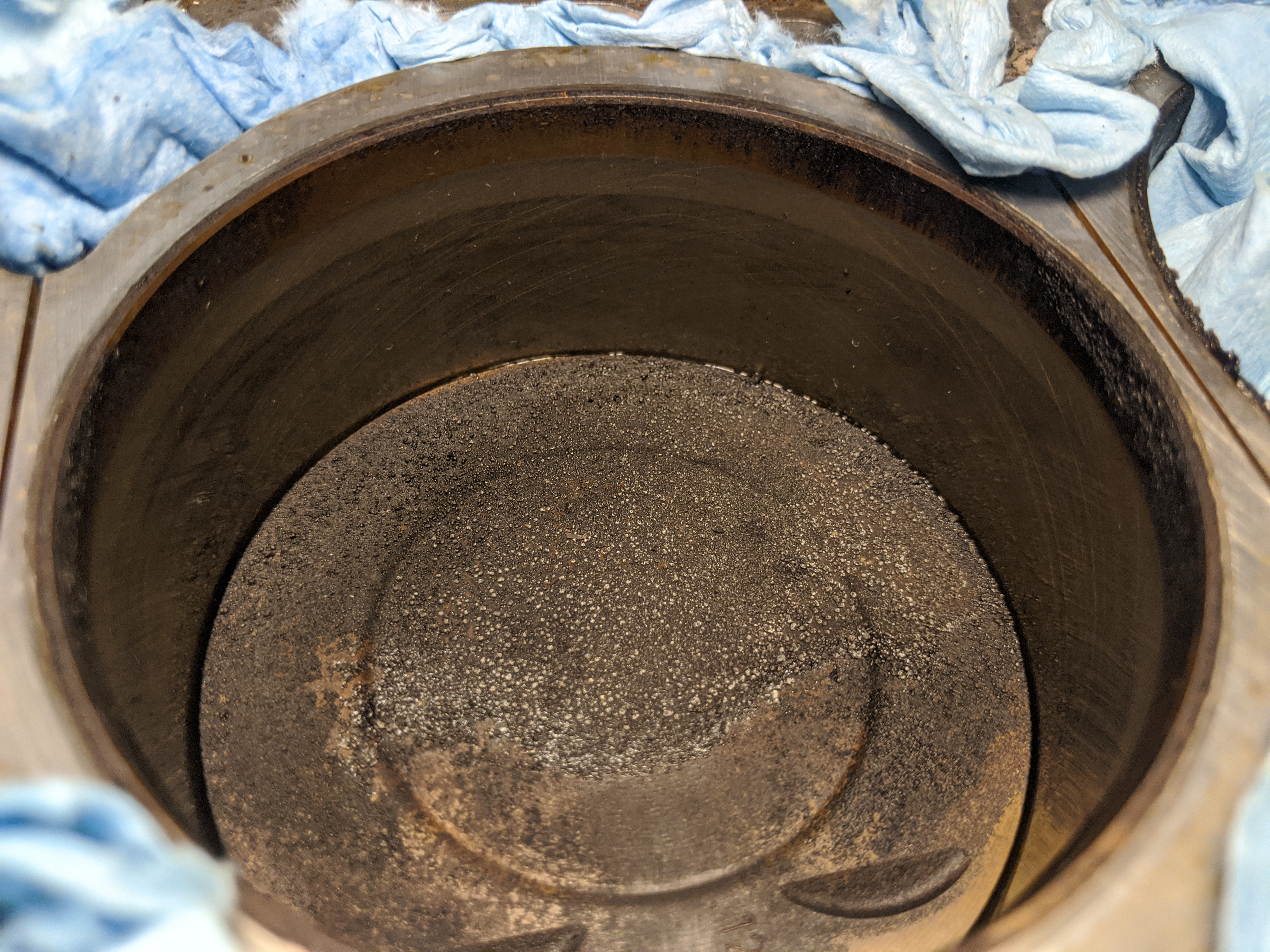

Dropped the head and cam cover off at a machine shop, so I'm waiting a call after he tests the valves. I'm planning on cleaning the block and cylinder tops - but is there any way I can check the cylinder walls to see if there's wear/damage? Visually and physically they seem fine, but I'm really outside of my level of expertise at those point..
Update: the machinist said visually they look fine and not to bother cleaning the Piston heads as I could easily damage the rings.

Yeah, they don't look bad really. You still have the diagonal hone marks in the cylinder. No, you don't want chunks or grit slipping down to the rings in the gap. You might take a narrow vacuum nozzle and suck any crud you can out of there. Interesting to see where the fuel has cleaned the area near where the valves open.

BlackBart wrote: 17 Dec 2019, 11:47 Yeah, they don't look bad really. You still have the diagonal hone marks in the cylinder. No, you don't want chunks or grit slipping down to the rings in the gap. You might take a narrow vacuum nozzle and suck any crud you can out of there. Interesting to see where the fuel has cleaned the area near where the valves open.
Thanks for the affirmation, I really appreciate the input. Ill see what I can vaccum out. I was curious about the clean portion of the pistons. I've been running it with 89 octane and Lucas high milage fuel treatment for the last 2000 miles or so, so I wonder if that had any impact.
The update from the machinist was that I had 3 valves that were seating poorly and suggested that was the cause of my compression issue. Could the headgasket and valve seating issues be related or could they just be concurrent problems?
The head gasket being in visually ok shape (to my eyes) had me worried I misdiagnosed something. I did find a small nik and small bulge/irregularity on the head gasket between cylinders 3 and 4, but Im not sure if I'm having confirmation bias. That being said I did have all the other symptoms, so i think I made the right call.
If anyone is looking for a 2019 price reference; the machinist said he had another Volvo head coming in for service so he could run mine after theirs and save me some cash. All together he qouted me $350 to lap the head, fix the seating issue on 3 valve seats, install the new valve stem seals (I supplied Volvo seals) and clean the cam cover.
Volvo head gasket was about $100 and Volvo valve stem seals about $150 for 20, both bought from my local dealer. $40 for Volvo anerobic sealant, about another $40 for the rest of the misc gaskets (mix of Volvo and aftermarket) and $20 for Victor reinz cylinder head bolts- all from FCP Euro.
