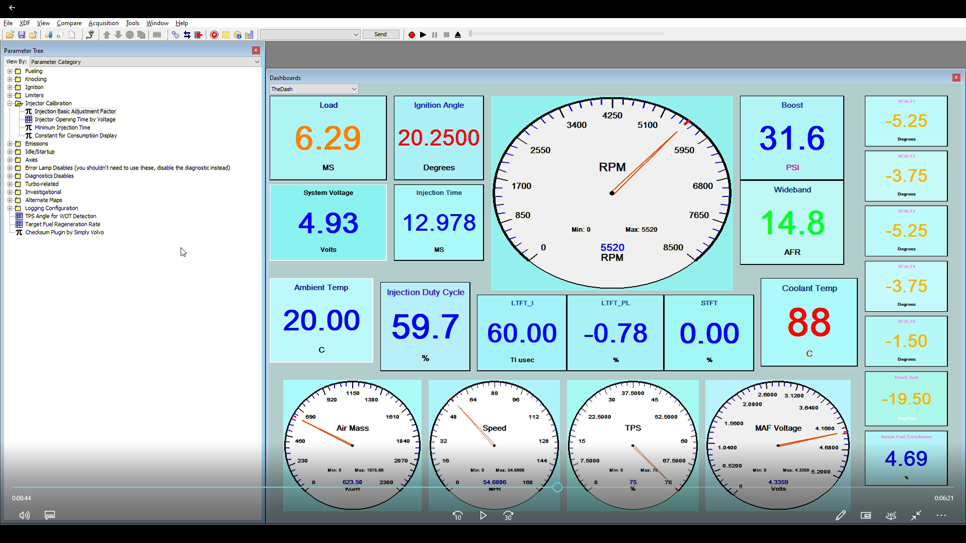

Yep little did I know the flashing check engine CEL is programmed in the .BIN to tell the user when your running lean. Screen recorded while data logging and was able to see that the second the CEL came on ignition was pulled back and knock enrichment was set. The AFRs say 14.8 but that value is really N/A because I don't have a wideband sensor hooked up. I was under the impression that the O2 sensor was wideband in these cars....guess not, after the run I did (pic below) I added a AFR readings for the front O2 on tunerpro but the readings are all over the place so I doubt reading from a O2 sensor is the best.

I really hope you are not running 32 psi of boost at 5500 rpm?

abscate wrote: 11 Jun 2020, 03:02 I really hope you are not running 32 psi of boost at 5500 rpm?
Ha! I max out at 12psi, its not getting a correct signal
