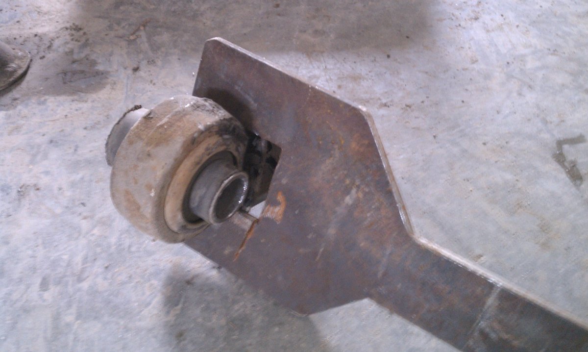

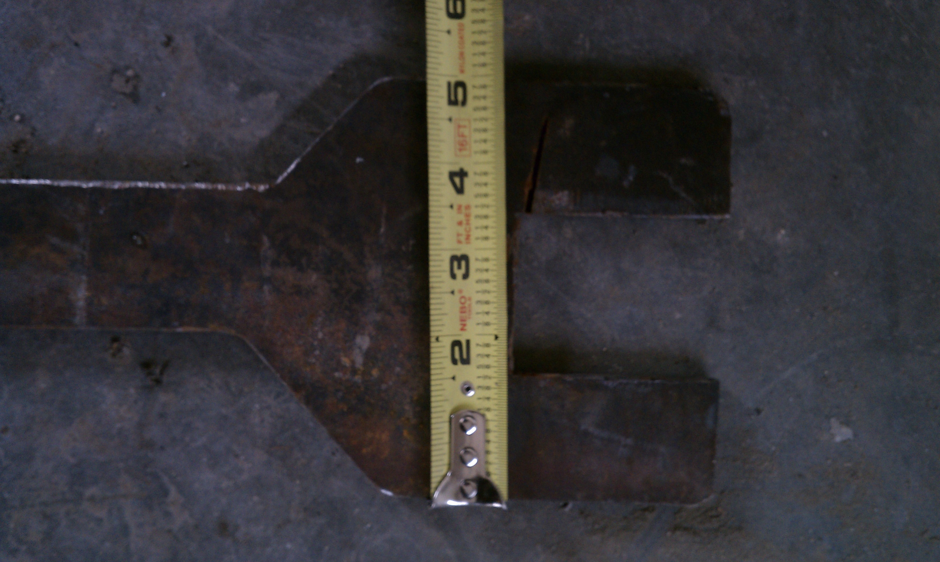

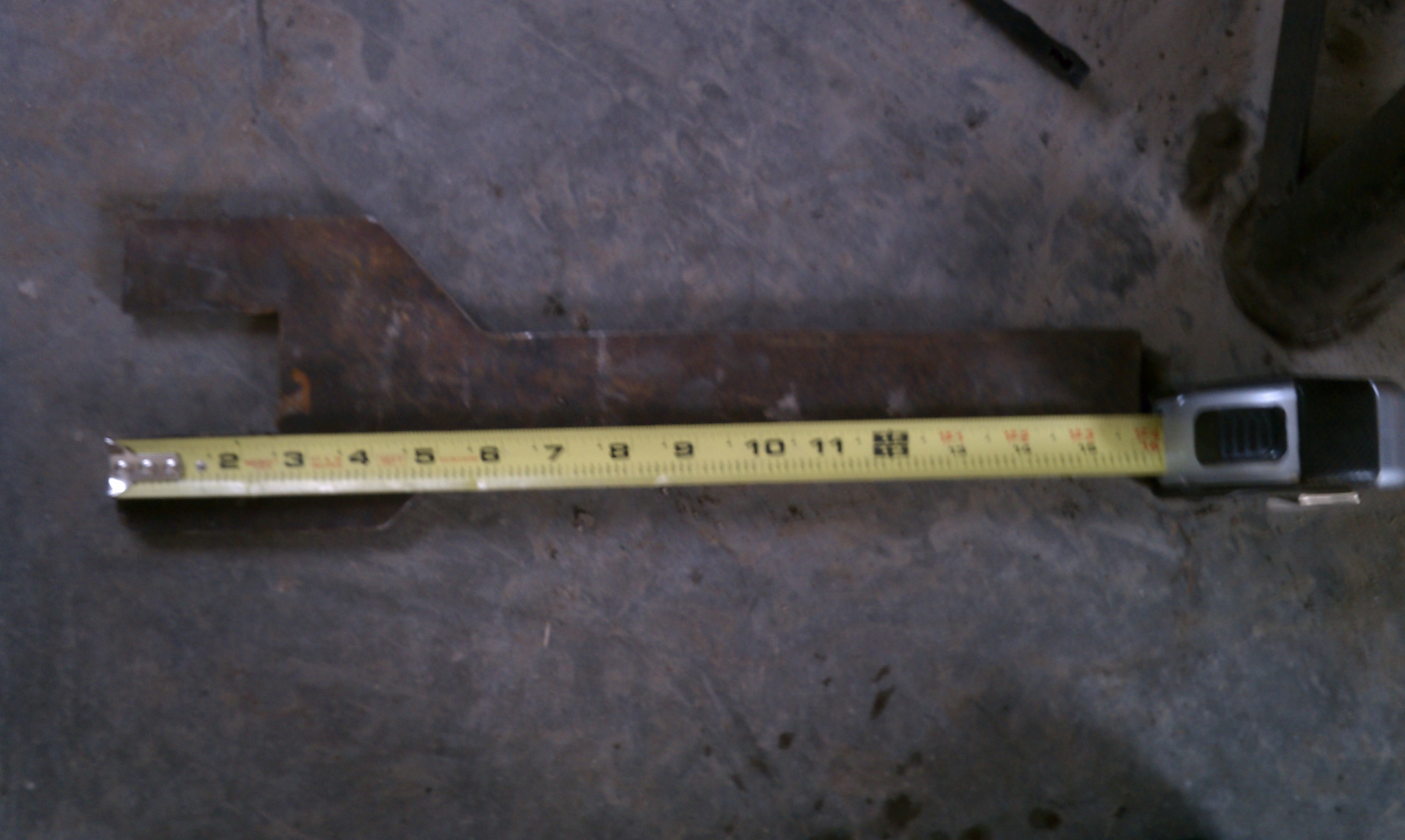

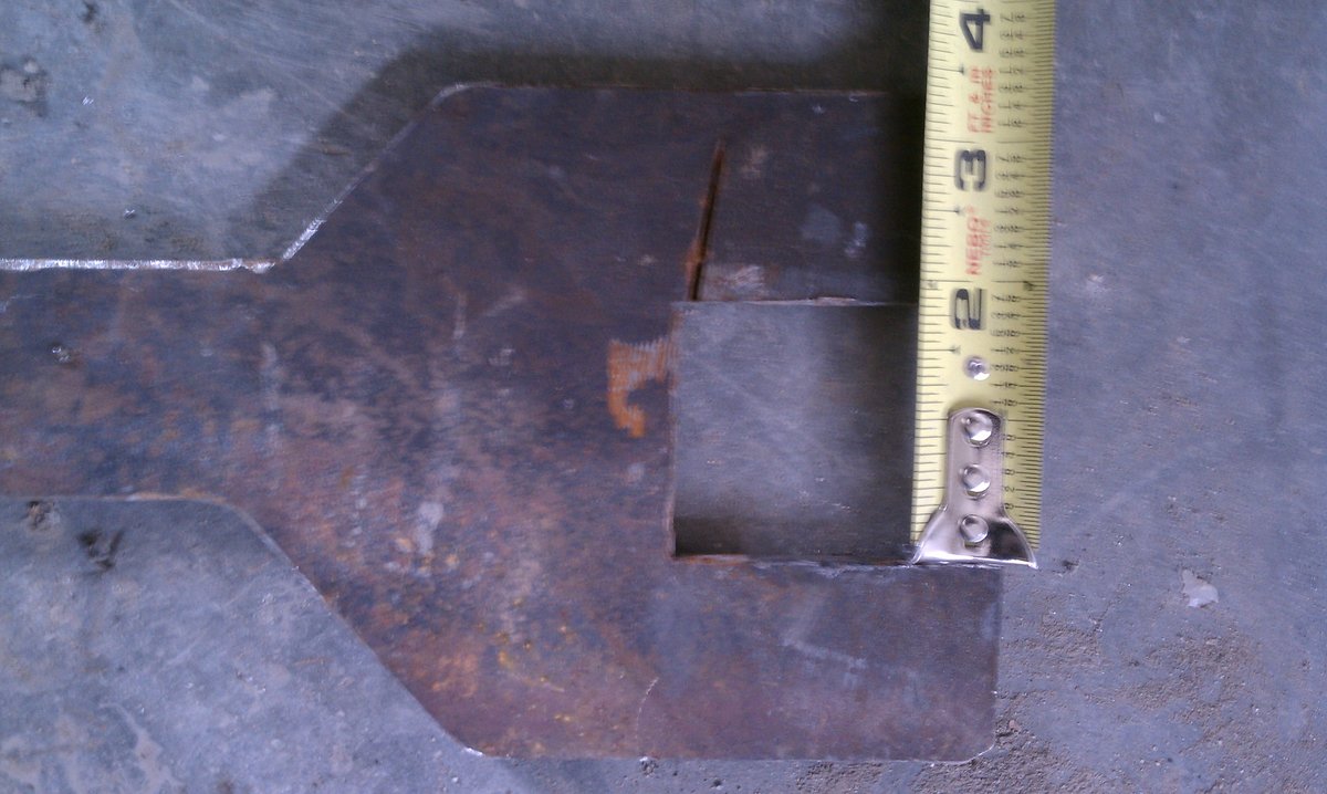

My girlfriend, Kristen, is out of town for her daughter's volleyball tournament, and so, I took advantage of the freedom to change my end links, today. I no longer fear replacing end links, but I had hoped to be able to change the bushings at the other end of the Delta arm.
I began as Grendel suggests by drilling into the rubber, but I got real lucky. I did my work in a friends garage, and I found a home made open end wrench made of 1/4" steel, with an approximate size of 1 13/16 (It appears to have been cut out free hand.) I slipped it in between the steel yoke and the the rubber of the bushing with a down ward twist. Then I smacked it with a mini sledge. The end link came out in three blows.
Since the home made wrench worked so well I looked forward to seeing if it would make the install easier. It didn't at first. I managed to wedge a piece of 2x4 in between the frame and the Delta arm. With the arm in a more favorable angle, the end link was inserted with less than ten blows of the hand sledge. I alternated blows to each side of the hand made wrench and walked the bushing into the Delta arm.
I changed the fuel filter while the bracket was loose. This is the easiest and most pleasant fuel filter replacement that I have ever done! You gotta love Volvo engineers! Since the car had been sitting while I worked on the bushing, a little bit of fuel got my hand wet when I pulled off the first fuel line.
After discovering how helpful the home made wrench was, I attempted to replace the driver's side end link without drilling. After drilling, as I had done on the other side, the home made wrench seemed to have lost its magic. That is until I squirted some oil in between the Delta arm and the rubber bushing. Then it came out in around ten blows of the hand sledge.
I started at 1 pm, and finished the passenger side by 4pm. I started the driver's side at 4:30pm and finished before 6pm.
