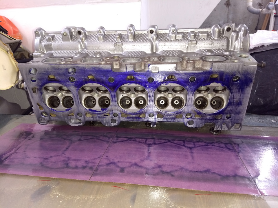

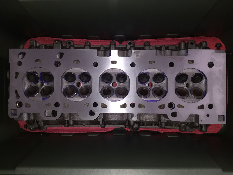

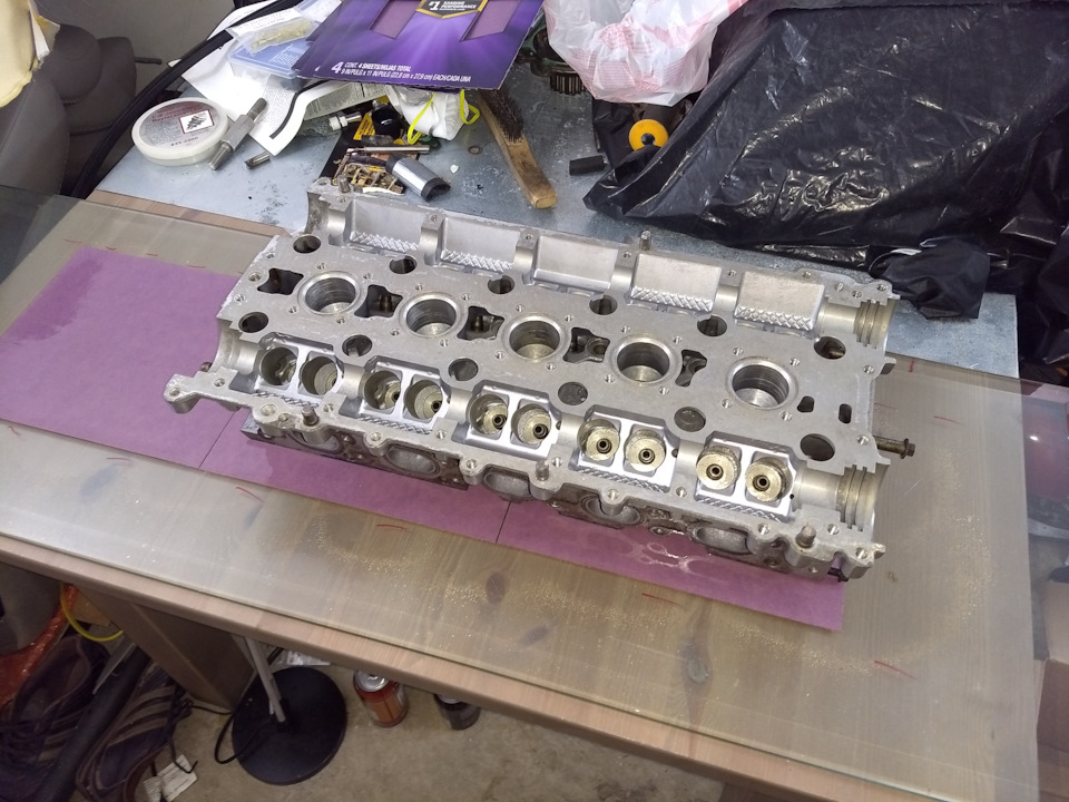

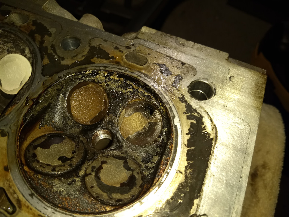

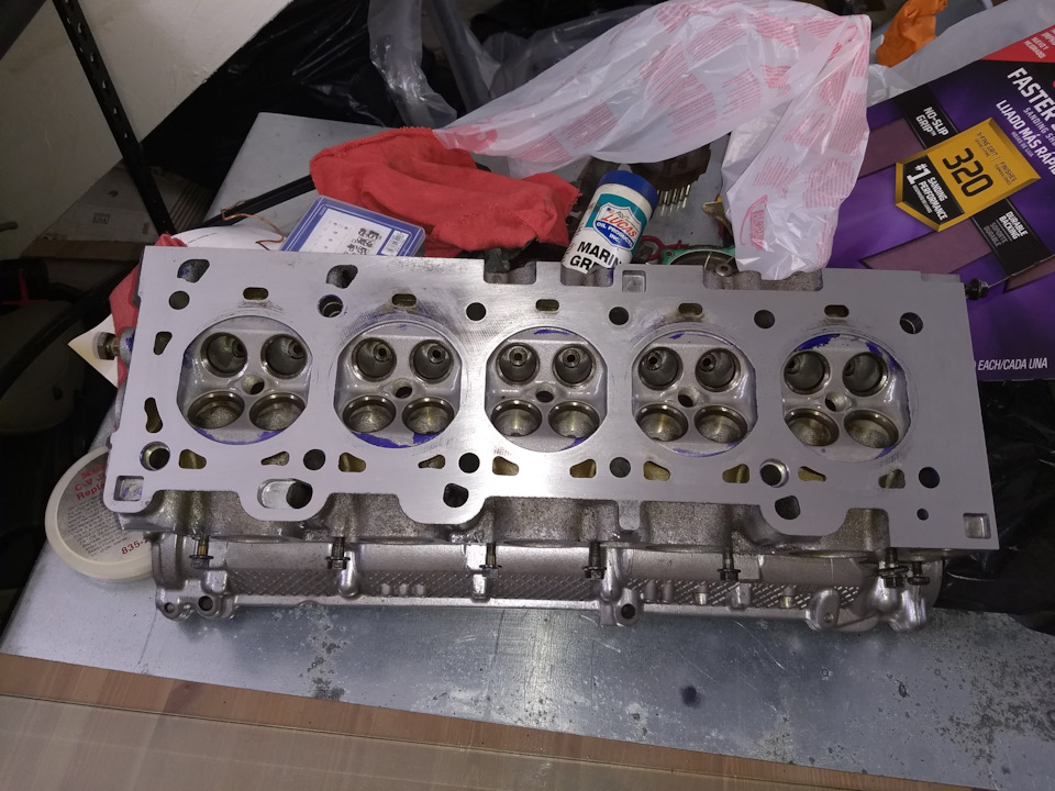

I had a head resurfaced at home as well. Was 0 mm W and 0.05 mm L in one spot only. Managed to have all zeroes.

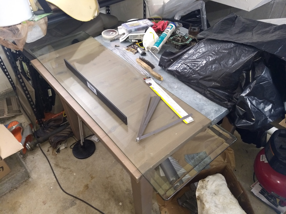

Finding a flat area of a 3/8" thick glass. You get the head as flat as the glass is.

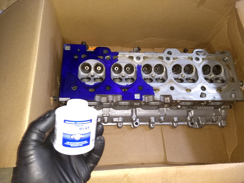

Dykem steel blue (wasn't really needed)
3M adhesive
18 sheets of 220 grit 3M sandpaper (the best one) and 18 of 400 for the final mirror-like surface (not actually needed)
This is a wet sanding, so some WD-40 is needed:
See the high spots?
Got his:
From this:

Yes. Having good tools does help. However I went low this time, the biggest investment was a $50 glass shelf ;) I actually had parts from the donor engine, just in case I screw it up, but it turned out pretty well. With all the consumables the head resurfacing project still was under $100 plus few beers, I think.

No pressure! The head is heavy enough, you just need to push and pull it, as horizontally as you can.
Because of a fine grit and wet sanding it took a few hundreds of passes, but in return it gives you a precise control of how much material is removed. I stopped when I had a couple of cavities reduced to a level where a new head gasket would seal it properly. It could be the coarse grit was even 320, not 220, forgot which one it was. 220 would work as well, however it need more frequent controls.
I think the sheet is a standard letter size, the head fits on two sheets with a good margin, so one stroke is slightly over 11" or 28 cm.
