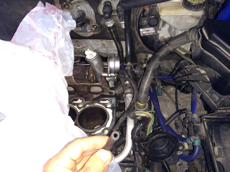

Maybe your engine vacuum system is different, but in my 2.5T the CBV is connected to inlet manifold (after throttle) and TCV is connected to turbo's cold air outlet (before throttle). Here I hold the other end of CBV hose that attaches to the manifold (not present in the engine bay :wink: ).
Anyhow, CBV should hold both the pressure and vacuum, and IPD w/ the stock-rated spring will do just fine.

vtl wrote: 28 Sep 2020, 10:11 Maybe your engine vacuum system is different, but in my 2.5T the CBV is connected to inlet manifold (after throttle) and TCV is connected to turbo's cold air outlet (before throttle). Here I hold the other end of CBV hose that attaches to the manifold (not present in the engine bay :wink: ).
Pulling my hair moment vtl (bewildered).
Found the green line between CBV and intake manifold, like you show in pix. Tested, and CBV holds vacuum.
