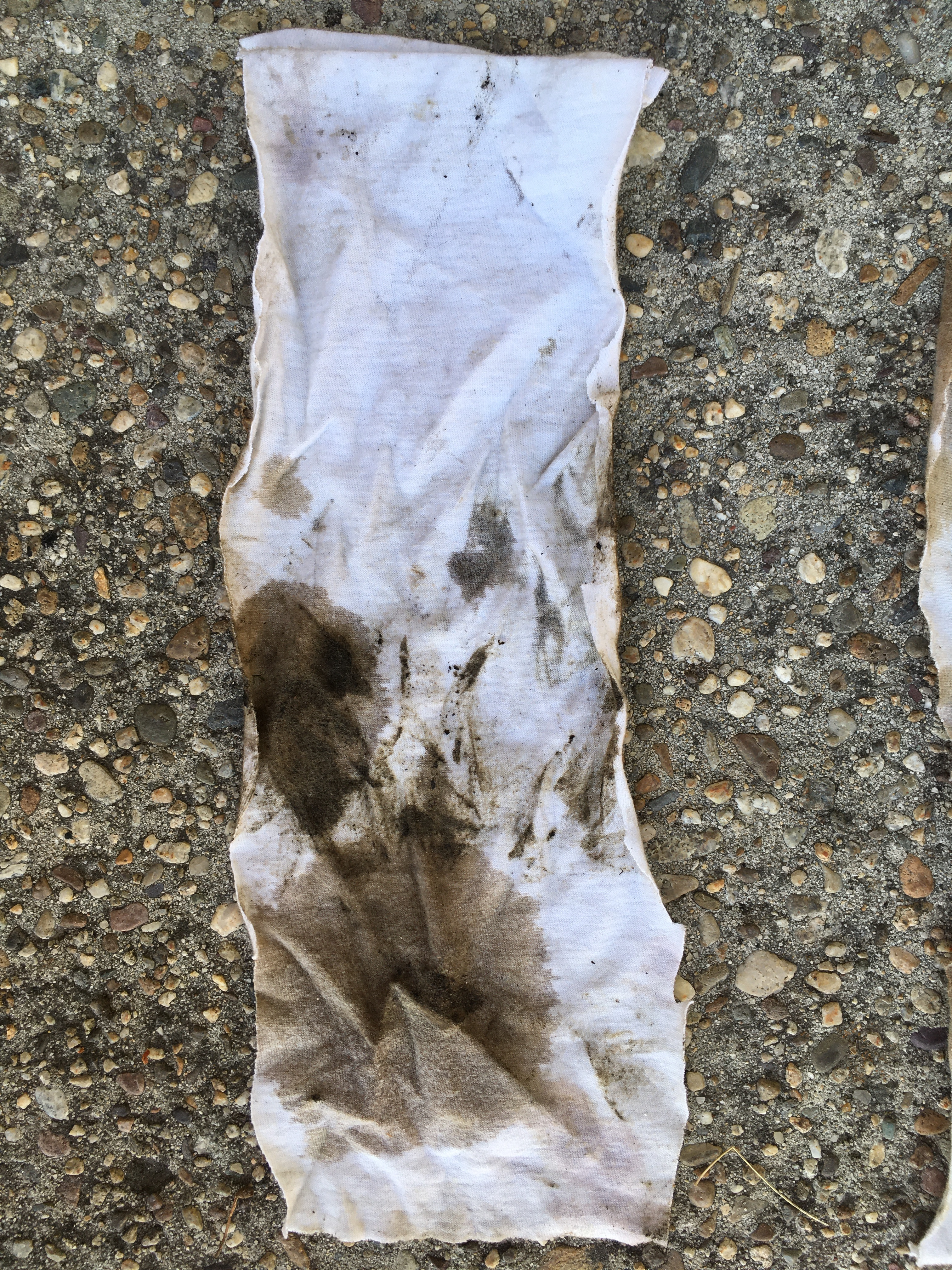

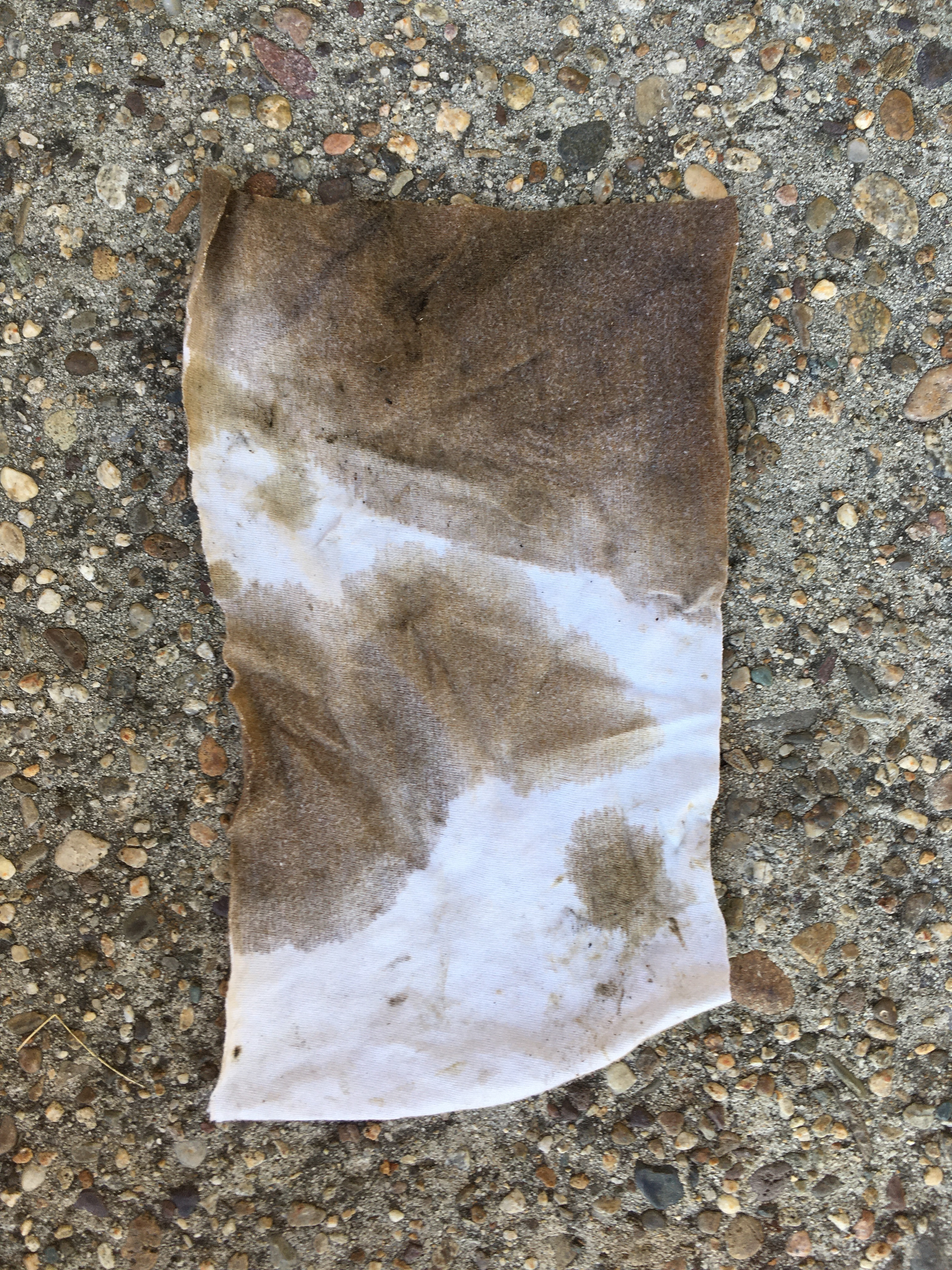

Hmm... After a 2 or 3 mile errand run at slow speeds.....
The rag at the dipstick tube base:
The rag at the oil cooler line union:

Have you considered adding a little dye to the oil and letting it idle at night with a UV light and watch where the oil is coming from?

I've never done that - where do you even find each of those?ZionXIX wrote: 30 Sep 2020, 20:19 Have you considered adding a little dye to the oil and letting it idle at night with a UV light and watch where the oil is coming from?
Related question - Is there a thermostat in that oil cooler line? Are those lines not under pressure until high engine temps?

Most autoparts stores should have them. Here a link example. https://shop.advanceautoparts.com/p/int ... /7010040-P
I was not impressed with the UV lights at the part store. I actually found one at harbor freight for $9 that worked very well.
Park the car, add the dye according to the instructions then run the engine. If you had that much leaking after 2-3 miles I would think just idling in the driveway at night would be enough to find that leak. Run that light back and forth until you see bright fluorescent colors leaking.
