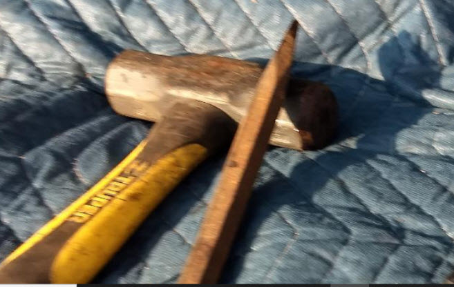

Great news. Every day I took a shot at it with no success with a different combo of tools. Today I hit it with the wood split - no go. Then a newly located rusty chisel that I found in my garage had not tried before and one shot - it popped out.
Conclusion. Constant daily PB Blaster probably did not hurt and could have only helped. I tried changing its position, Pushing it in and out, Pressure from 2 sides... etc... In the end... I can only cite luck as the reason it popped out today. It was really weird. My advice to anyone in the same jam ... don't give up, take breaks, and pray to the Volvo gods as there was no good reason it did not pop out anytime sooner and there was nothing special about the new chisel I used. Just the stars aligned today

Good job! It doesn't look like any of that PB blaster made it to the spline anyway from the picture.

Blacklab467 = good point.
