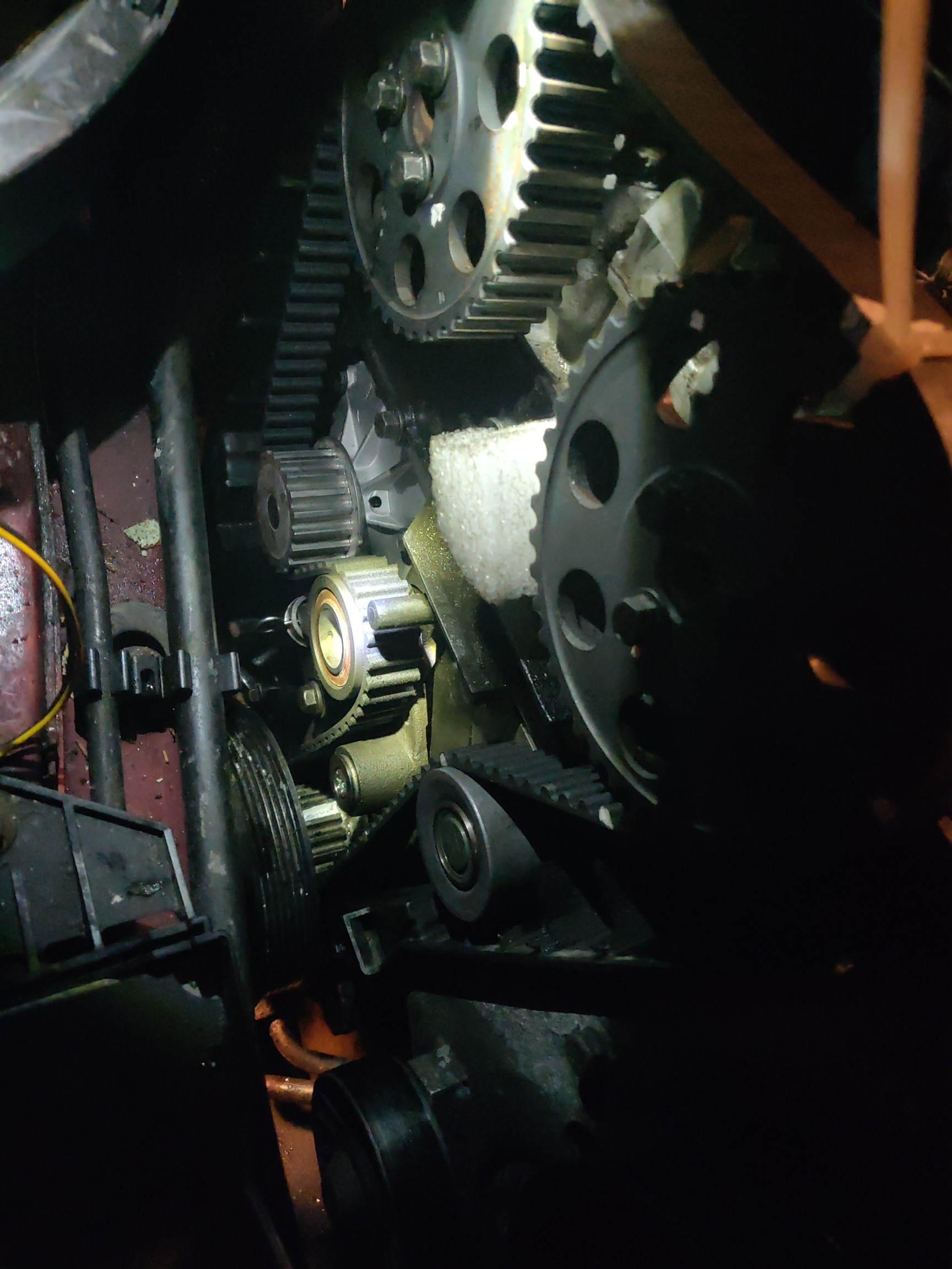

Ok final steps...help please !๐Ÿ‘๐Ÿ‡บ๐Ÿ‡ธ๐Ÿ˜Ž
Now....the belt seems wayyyyyy to small and won't go around the water pump.
So what is the order of installation?
Belt goes around crank
Belt goes over idler pulley
Belt goes up to intake cam sprocket
Then.....
Exhaust, water pump, and tensioner pulley?
It wont fit
Do I remove the tensioner, and get the belt around the tensioner pulley first?
Then once the belt is on...install the tensioner?
Them pull the pin?
Looks way to tight.
Help?

The belts match up exactly. Friggg. That's not the issue.
What is the process of installation?
The crank pulley ....that part of the timing belt goes on first.
What's next? Thanks in advance , it's getting dark and we just keep running into issues...

Try this routing.
"Maturity is when you realize that the overbearing high school principal or villainous college dean from your favorite 80s movie is actually the hero of the story."
1995 860R (854 + B5254T4 + M56)
Posts: 36149
Joined: 17 Feb 2013, 17:54
Has thanked: 1610 times
Been thanked: 4068 times
The procedure says water pump last but many find it easier to do tensioner pulley last as itโ€™s smooth.
Loosen the bolts on the idler to get some more slack
I use a 30mm. Box end wrench as a tension tool to fit the belt on the water pump
Once on, take it through two turns by hand to make sure the timing marks are aligned

It was stuck over an unknown bolts underneath. Got the belt on!
I am gonna do four or five revolutions of the motor before I pull the pin.
Make sure no interference
I have the spark plugs out.

Post by Sufbug »
Ok that all worked.
Do I pull the pin first?
Or rotate the motor first?
Everything is lining up ...but I didn't rotate the motor yet
Pull pin , or turn over hand crank over engine.
Which one first?
Al
1998 V70 wagon / 244,013 miles / purchased 9-25-2020
2016 Cadillac CTS4 / might be selling this
1979 trans am 400ci / 4 speed / t-tops / not selling this
erikv11
Posts: 11912
Joined: 25 Jul 2009, 14:03
Location: Iowa
Has thanked: 311 times
Been thanked: 817 times
Post by erikv11 »
Pull the pin first, then do the revolutions by hand.
Check that the marks all come back to home. If they don't you have to remove the tensioner, complress it sllllllooowwwwwwwwlllllllllyyyyy, re-install the belt with everything in time, try again.
