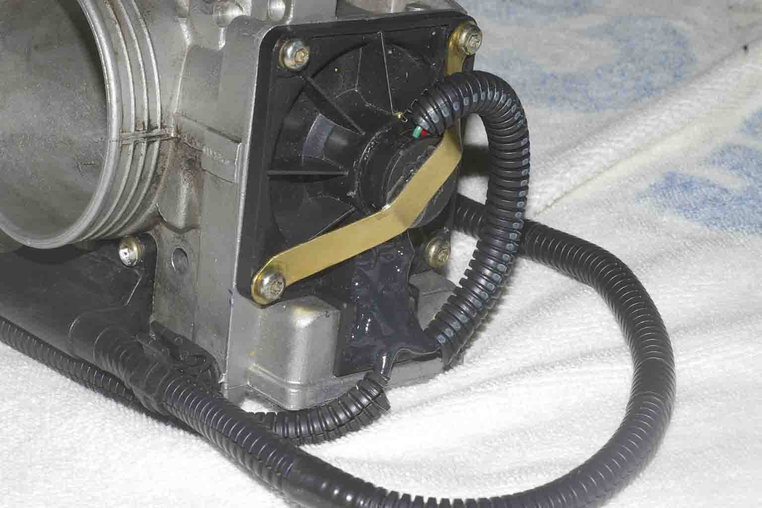

firstv70volvo wrote: 30 Apr 2011, 10:57 Hi Yehuda,
I’ve also spent far too many hours attempting to fix the Magneti Marelli ETM and finally did have some success. I’ve been using the repaired ETM for more than 5,000 miles now. I used an off-the-shelf Vishay throttle position sensor and modified the housing and ETM side plate to make it work.
After studying this ETM for some time now I can say any do-it-yourself fixes have to been done with 100% reliability in mind. This is definitely not a simple do-it-yourself repair job. The ETM is a crucial safety component and while many criticize the original ETM design it does have complete redundancy with two independent throttle position sensors. From what I’ve read if one sensor signal is lost there will be reduced performance but if both throttle position sensors signals are lost or corrupted the throttle drive motor shuts down completely and there is very limited power (fast idle) and no throttle control.
Replacing the original sensors with a non-contact type does improve the reliability of the sensor a great deal because there’s nothing to wear but if the non-contact electronic sensor were to fail it would be the equivalent of having no valid throttle position signal and the throttle drive motor would shut down. From what I’ve learned and what I’ve seen with other non-contact sensor repairs, the sensor can only be placed on the side opposite the drive motor due to magnetic interference of the motor affecting the sensor . One non-contact sensor can have dual outputs and dual sensors in one package to improve reliability but it’s still not full redundancy with a single power source and wiring. My opinion (for what it’s worth) is a high quality automotive grade non-contact electronic sensor (like the Vishay sensor) is as reliable as all the other electronics in the ETM, which also doesn’t have full redundancy. Let us know how things go when you get the new Sacer parts. If you have any questions with the repair I may be able to help with some aspects of it so let me know.

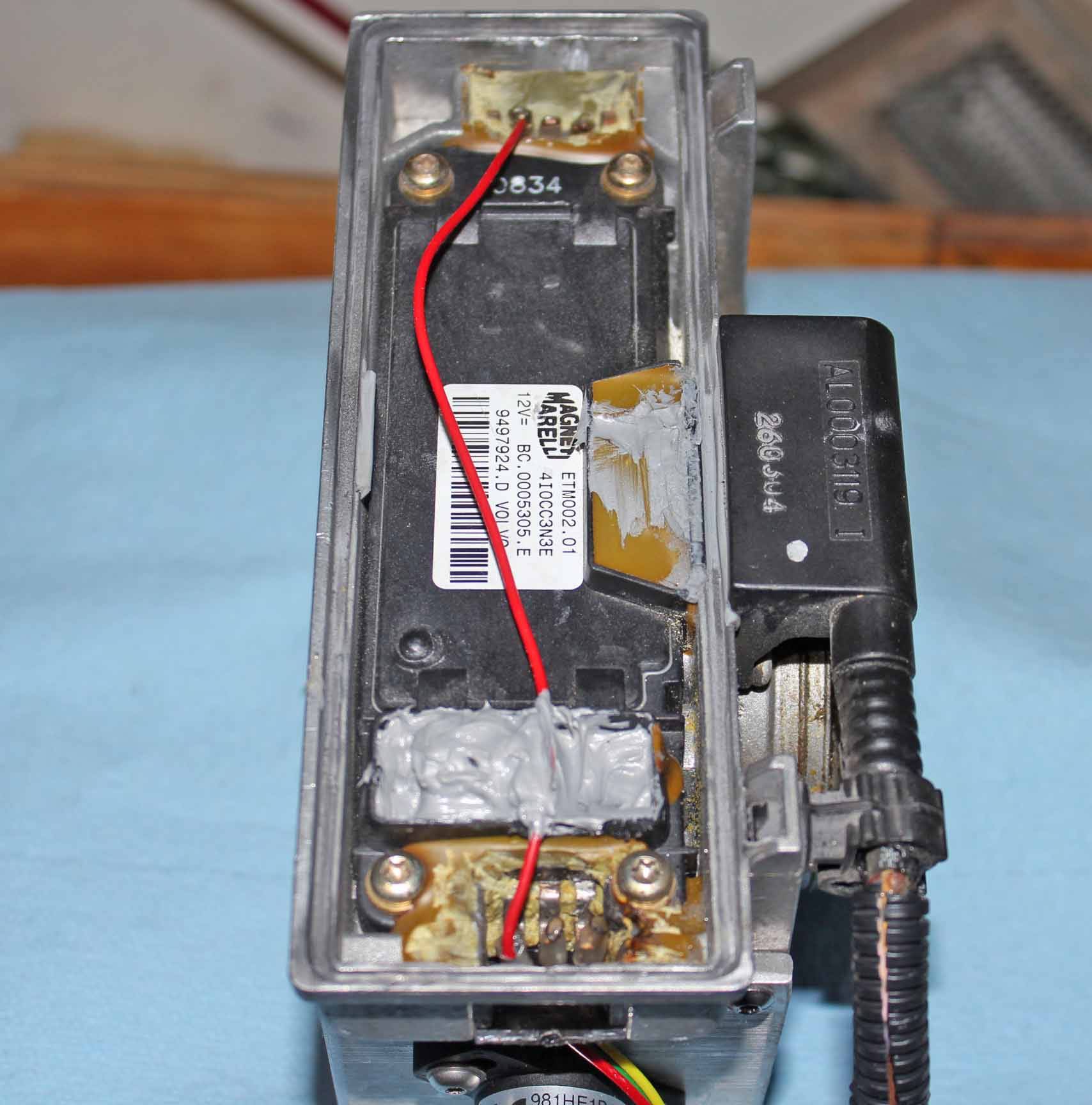

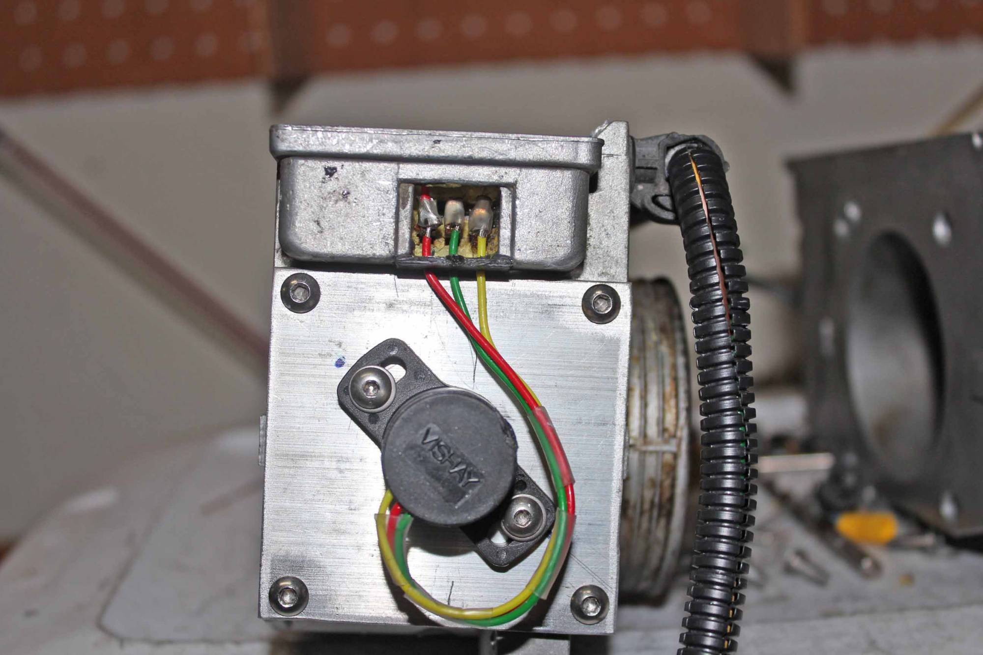

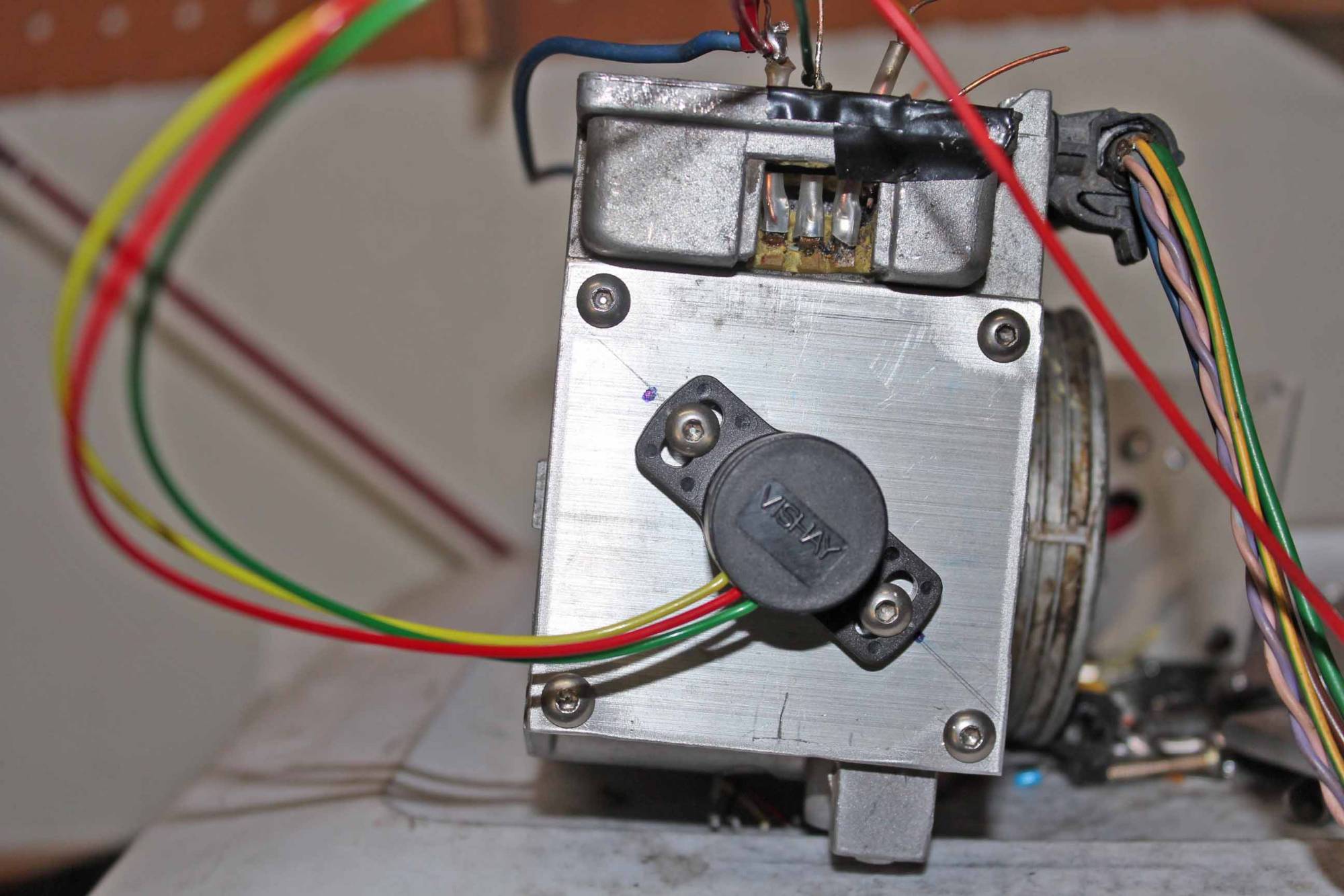

It's been 11 years since I put a Vishay sensor on my Magneti Marelli ETM (2001 Volvo V70) and after more than 100K miles it's still working perfectly. While cleaning out my garage I came across a couple of MM ETMs I purchased for cheap at the salvage yard years ago and decided to do a few improvements on the Vishay sensor retrofit project. This is just a project for me and isn't meant to be a DIY repair, for crucial safety reasons use the professional repair service offered by Xemodex for these ETMs.

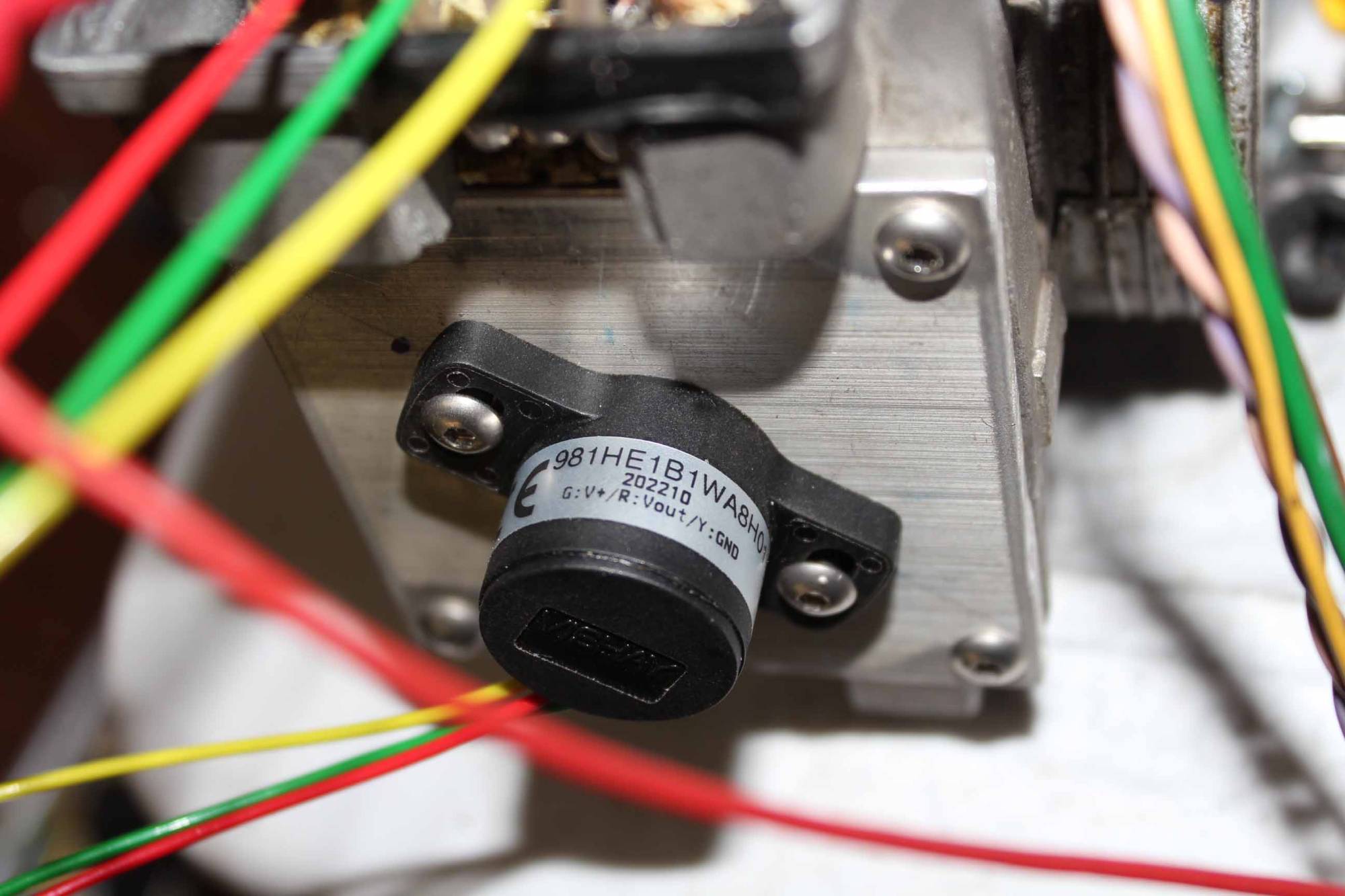

The project improvements I've been working on is using a more compatible version of the Vishay sensor for the D shaft used in the ETM. I custom ordered the Vishay sensors from DigiKey and purchased a 90 degree CW 8mm hollow D shaft version of the sensor. I also fabricated a new aluminum side plate and a 6.5mm to 8mm shaft adapter. The MM ETM has a 6.5mm shaft and the Vishay sensor only has an 8mm D shaft version of the part.
Update 5/9/22
Removed original vishay retrofit ETM after 11 years and 102K miles (and still working fine) to try out new version. New version with new side plate, custom fit Vishay sensor and shaft adapter working well, Vishay 981HE sensors work very well with MM ETM electronics.
original vishay retrofit 11 years 102K miles later working well.jpg (226.83 KiB) Viewed 4837 times
new version now in car and working well
almost done.jpg (172.32 KiB) Viewed 4867 times
prior work on new retrofit version
Haven't completely finished yet but with new side plate this is a better version of the original project.
vishay sensor wired to ETM and voltage adjusted.jpg (228.89 KiB) Viewed 4870 times
vishay 8MM hollow D shaft 90 degree CW with new side plate.jpg (235.67 KiB) Viewed 4904 times
vishay 8MM hollow D shaft and 6.5mm to 8mm adapter on ETM shaf IIt .jpg (162.98 KiB) Viewed 4904 times
vishay 90 degree CW 8MM hollow D shaft 981HE1B1WA8H01.jpg (200.75 KiB) Viewed 4904 times
Vishay Sensor Retrofit.jpg (85.49 KiB) Viewed 4904 times
